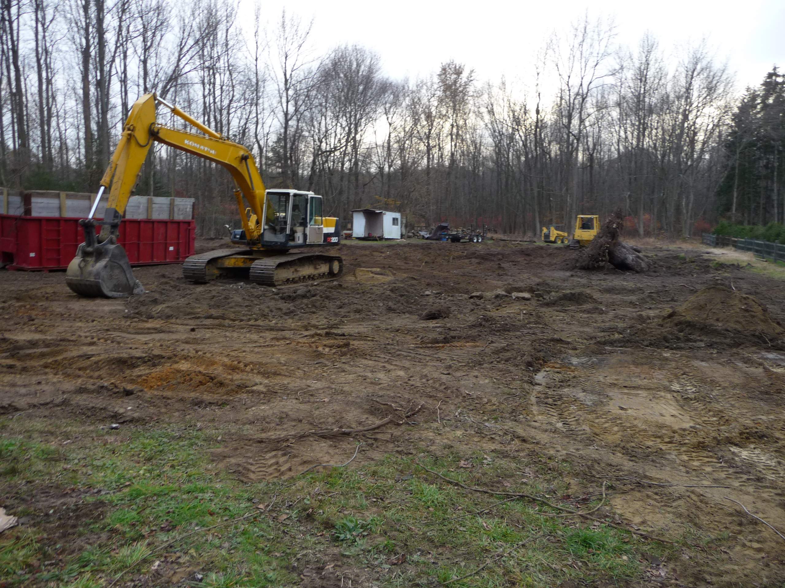

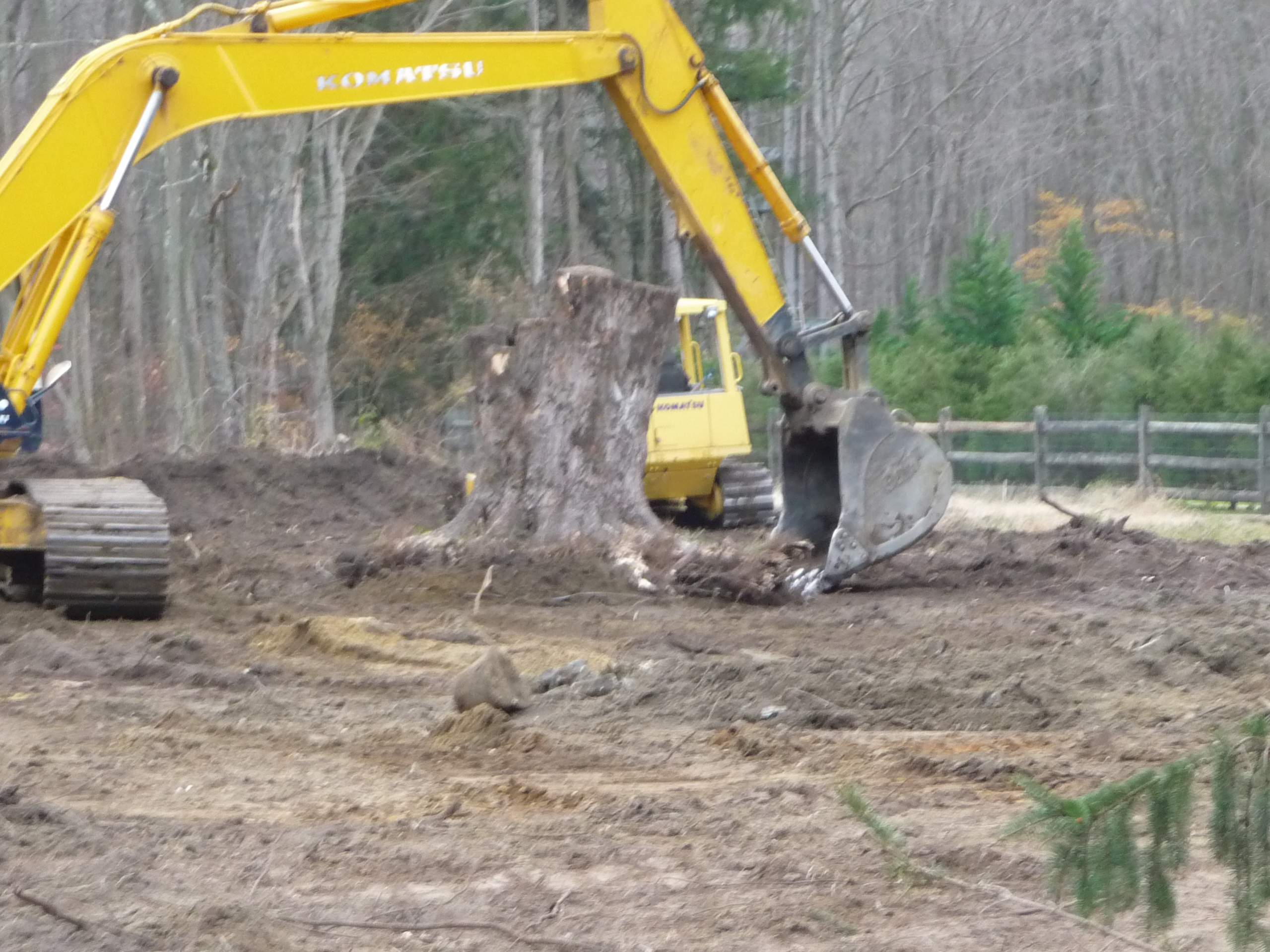

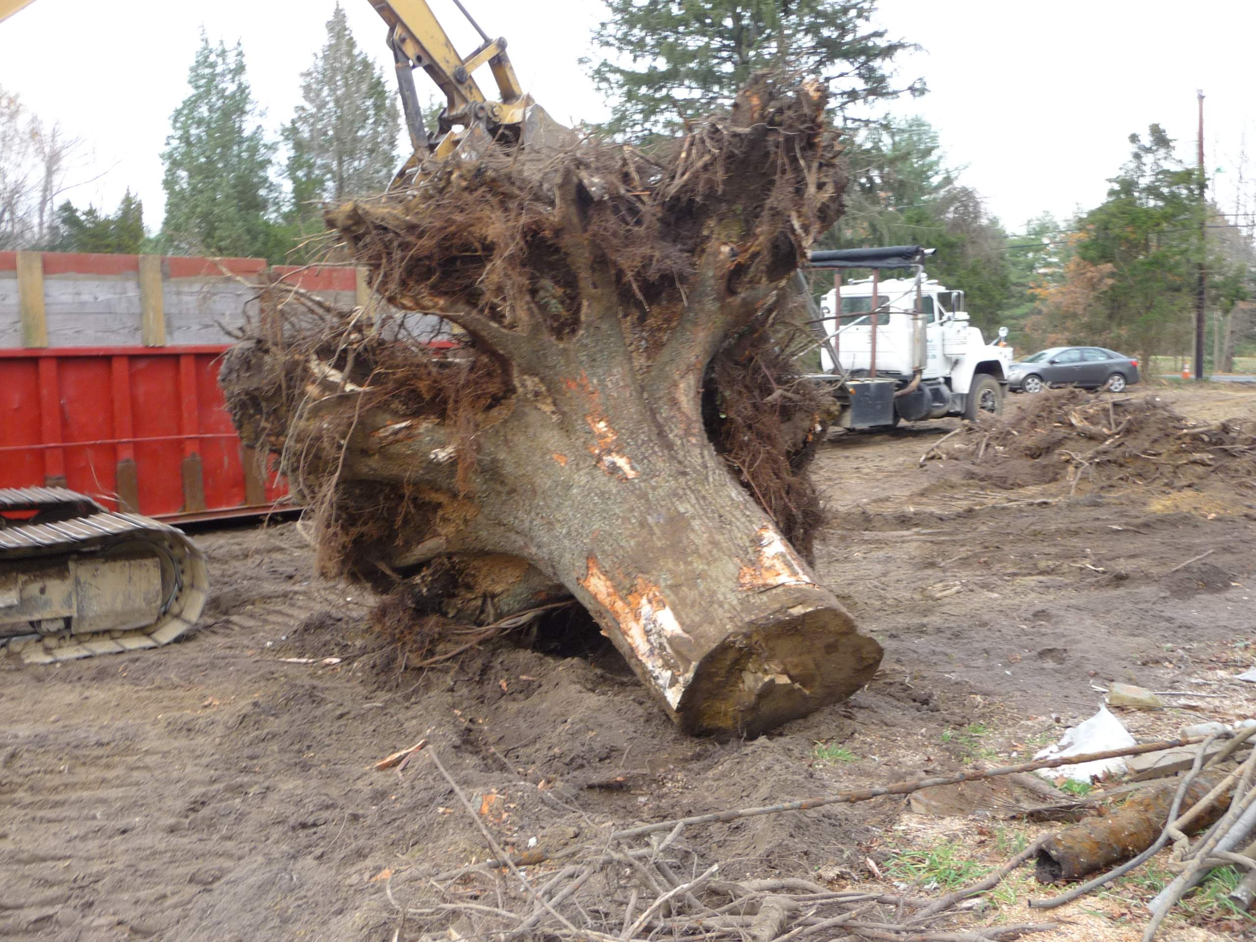

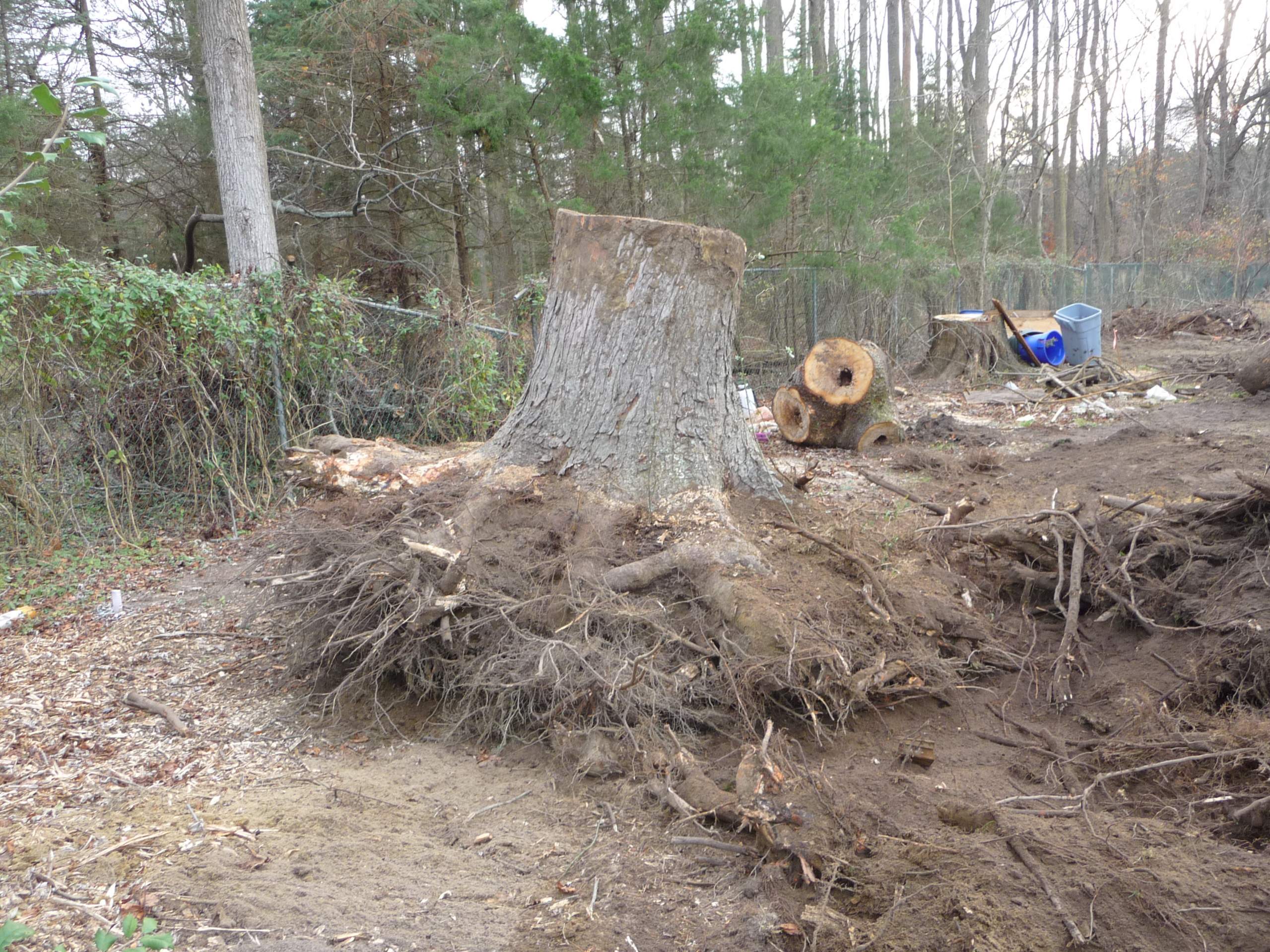

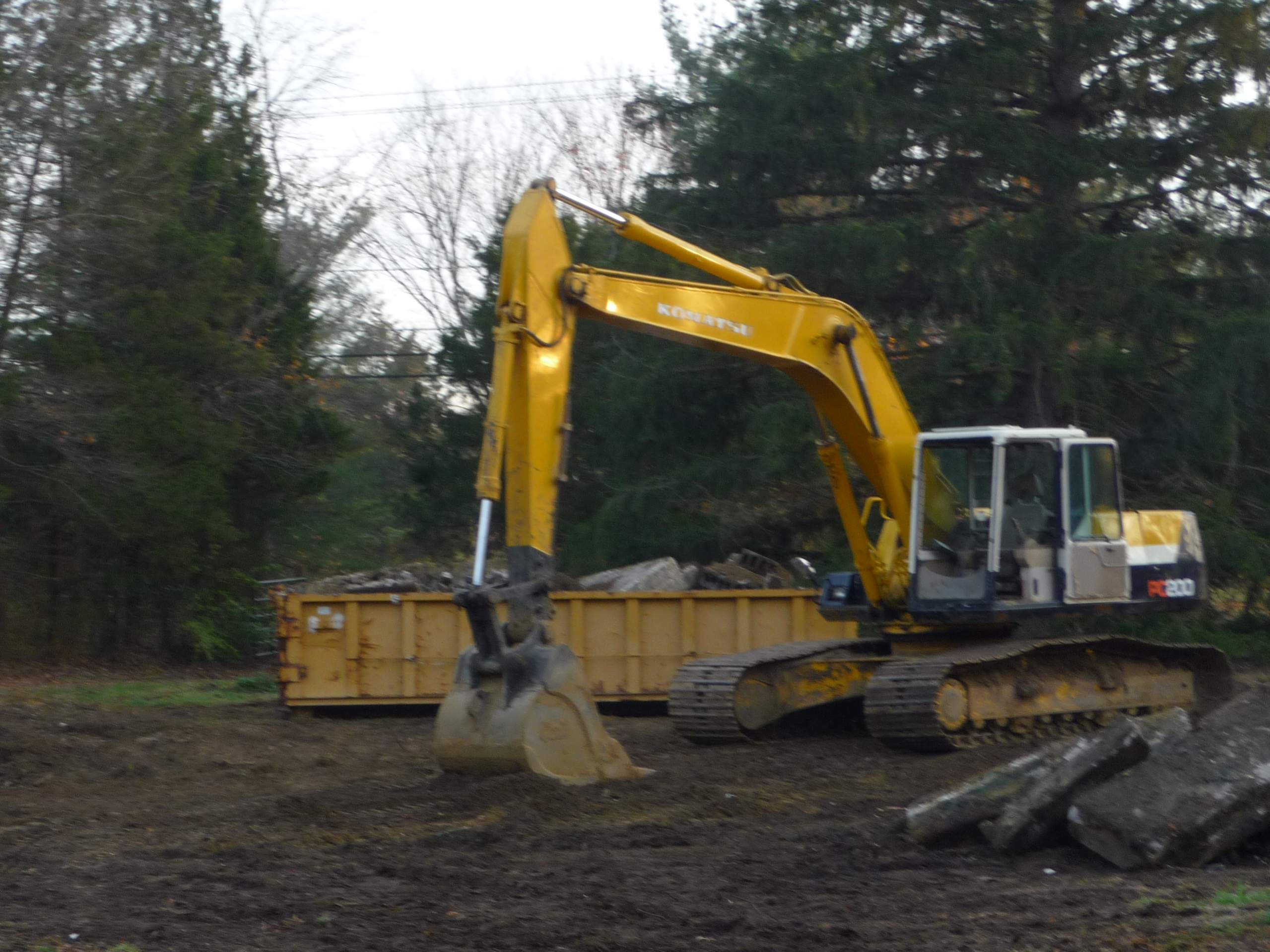

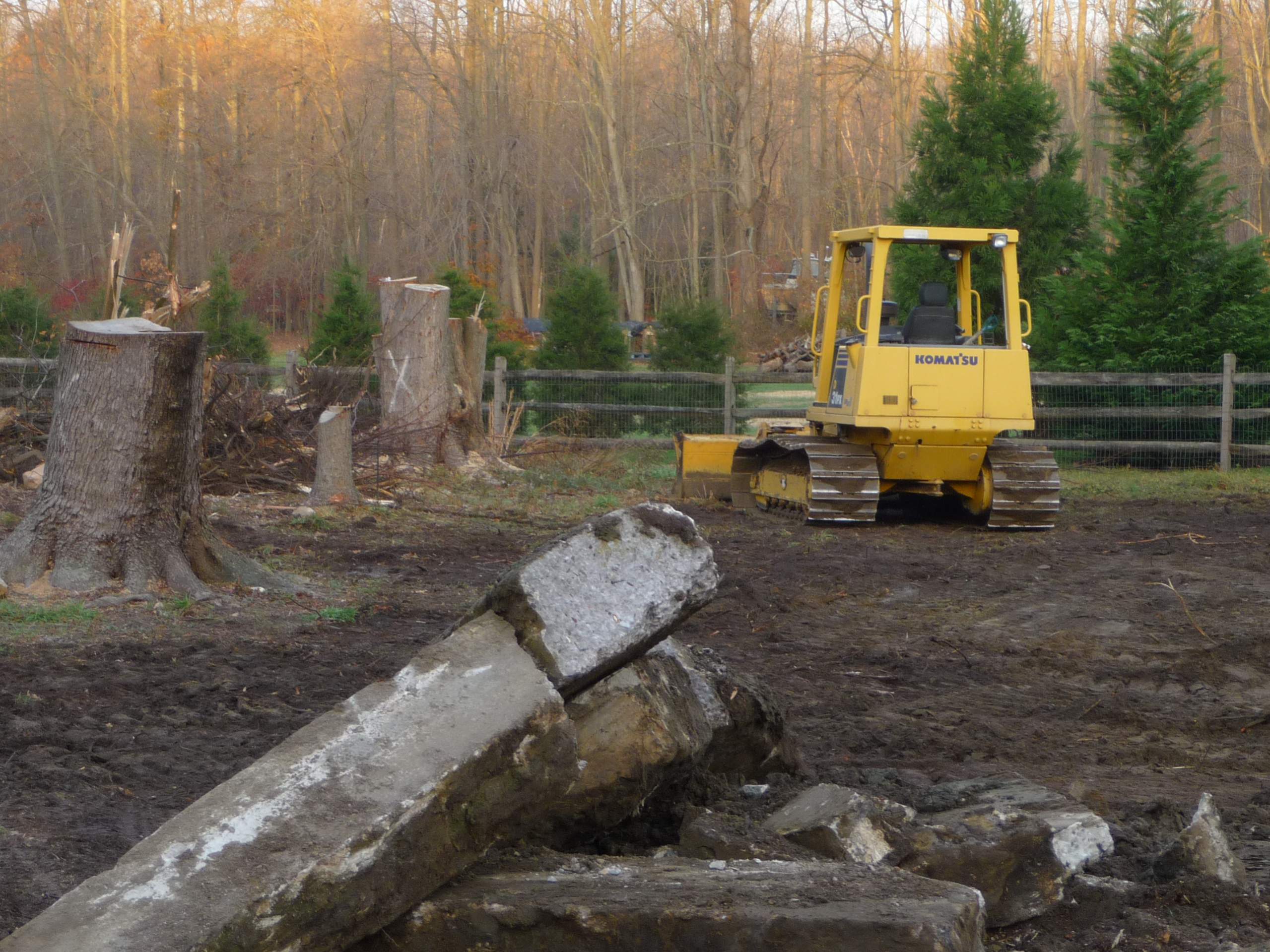

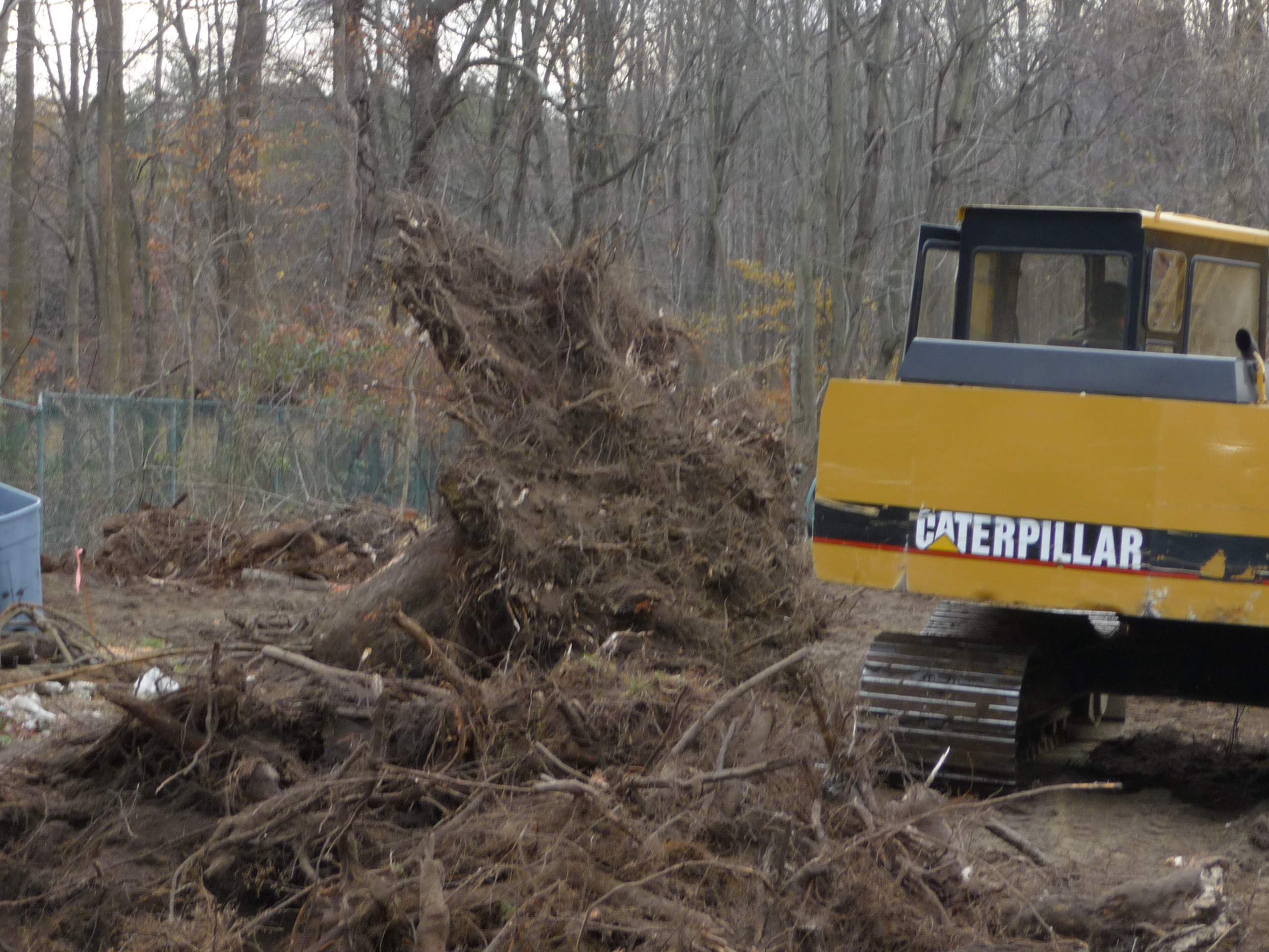

House gone. Stumps plucked out. The excavator had to bring in the bigger backhoe to get the job done. Topsoil was being scraped and piled up when I checked in late this afternoon. Surveyor will stake it out tomorrow with the excavator and the basement will get dug either Friday or Monday.
There are some pretty big stumps here.
P1020005.jpg P1020006.jpg P1020007.jpg P1020010.jpg P1020011.jpg P1020013.jpg P1020018.jpg P1020019.jpg

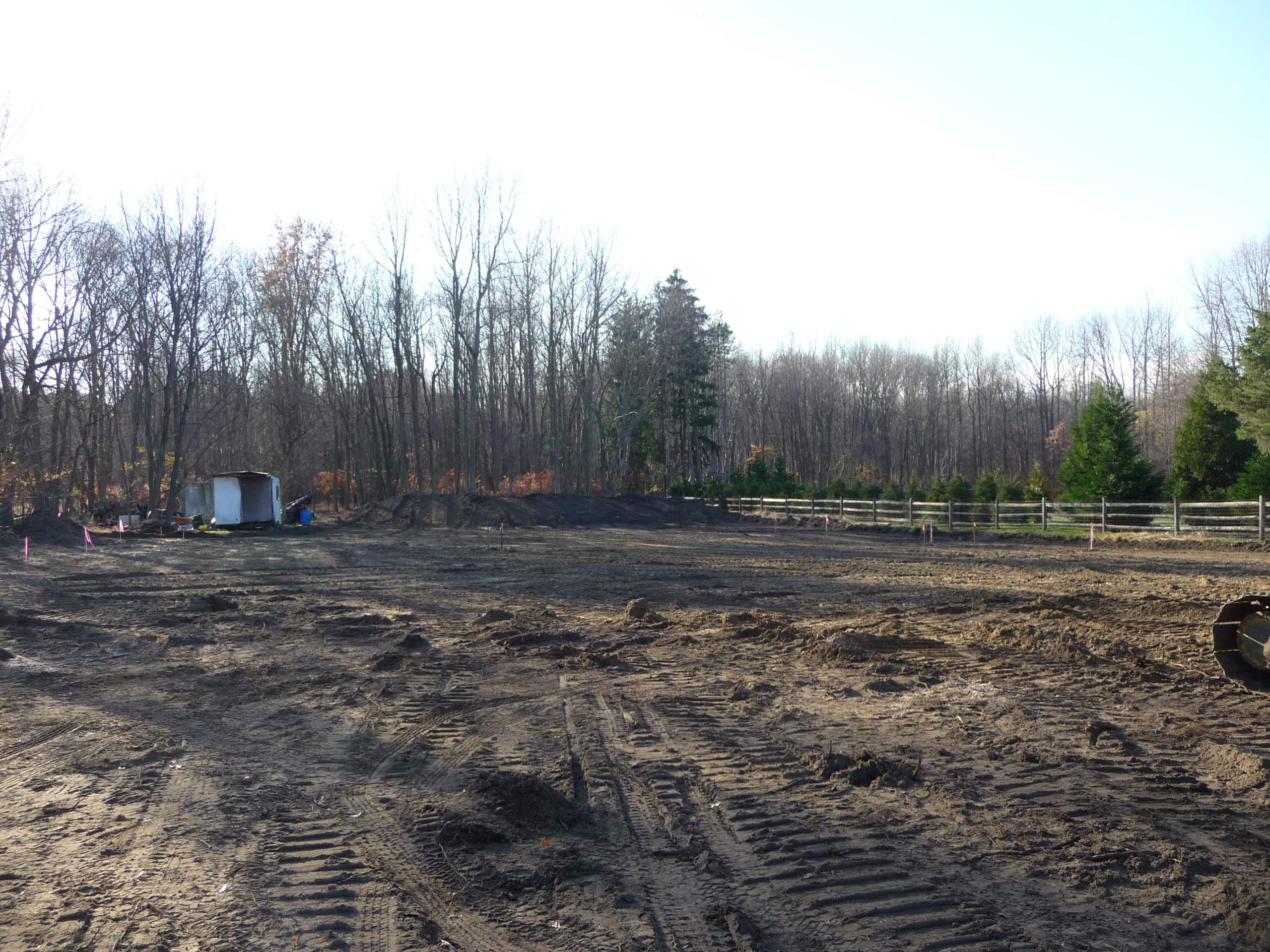

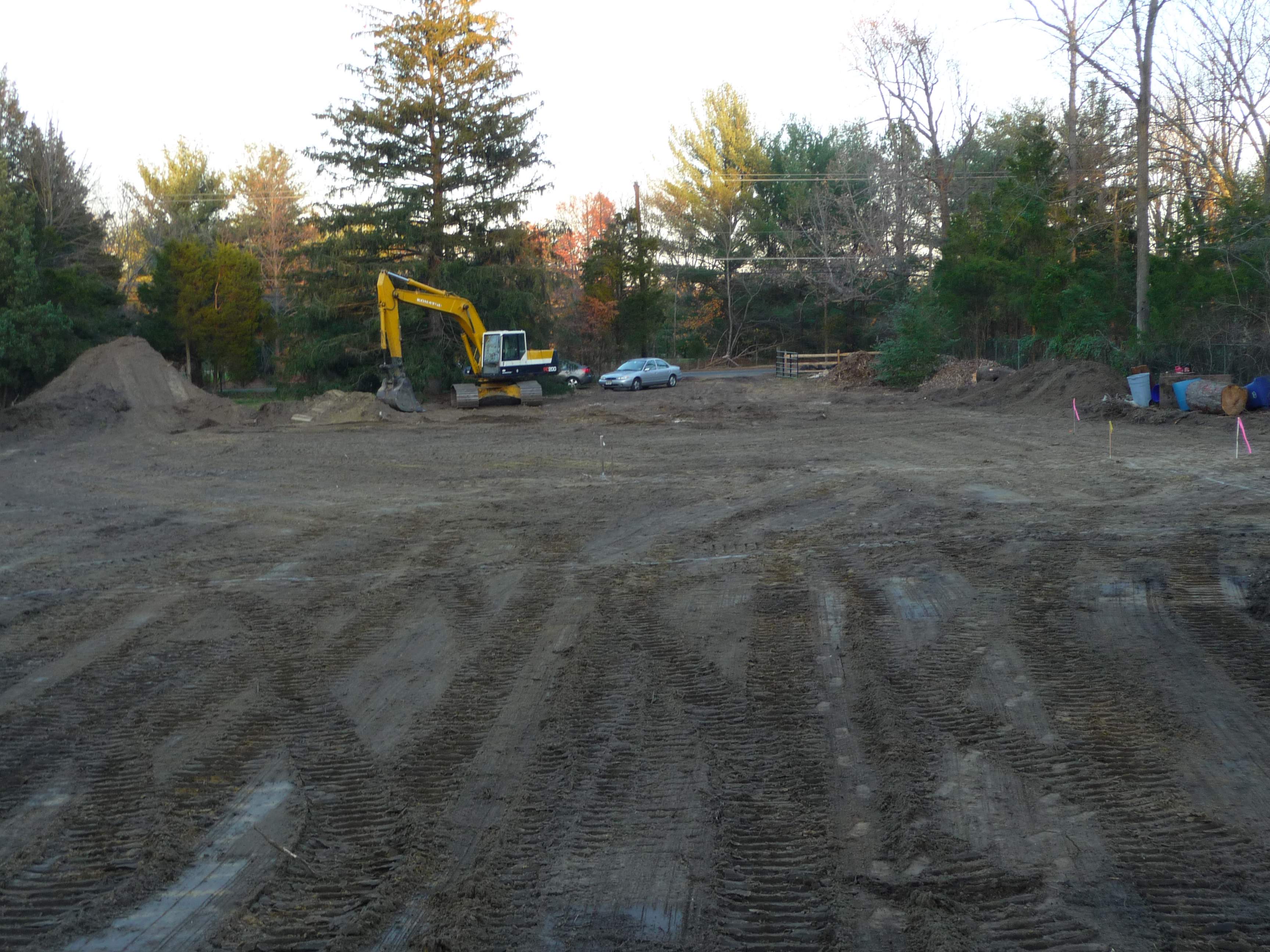

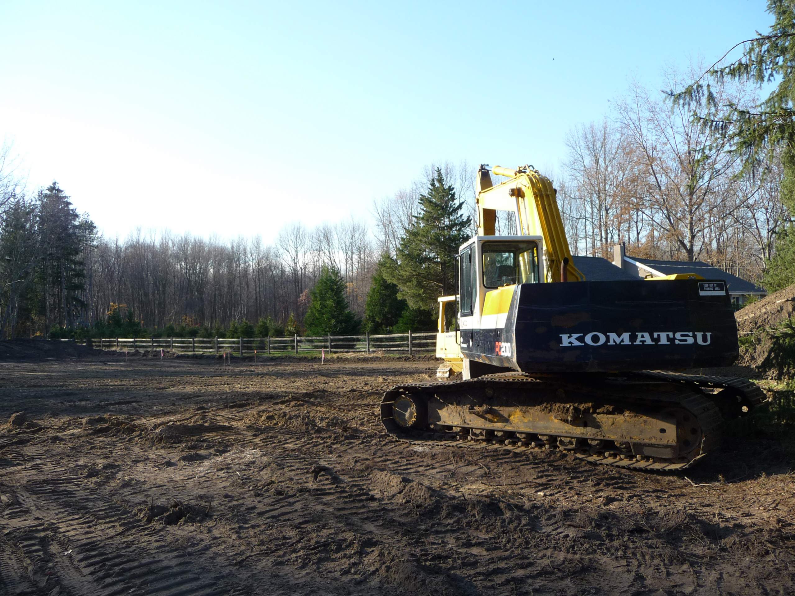

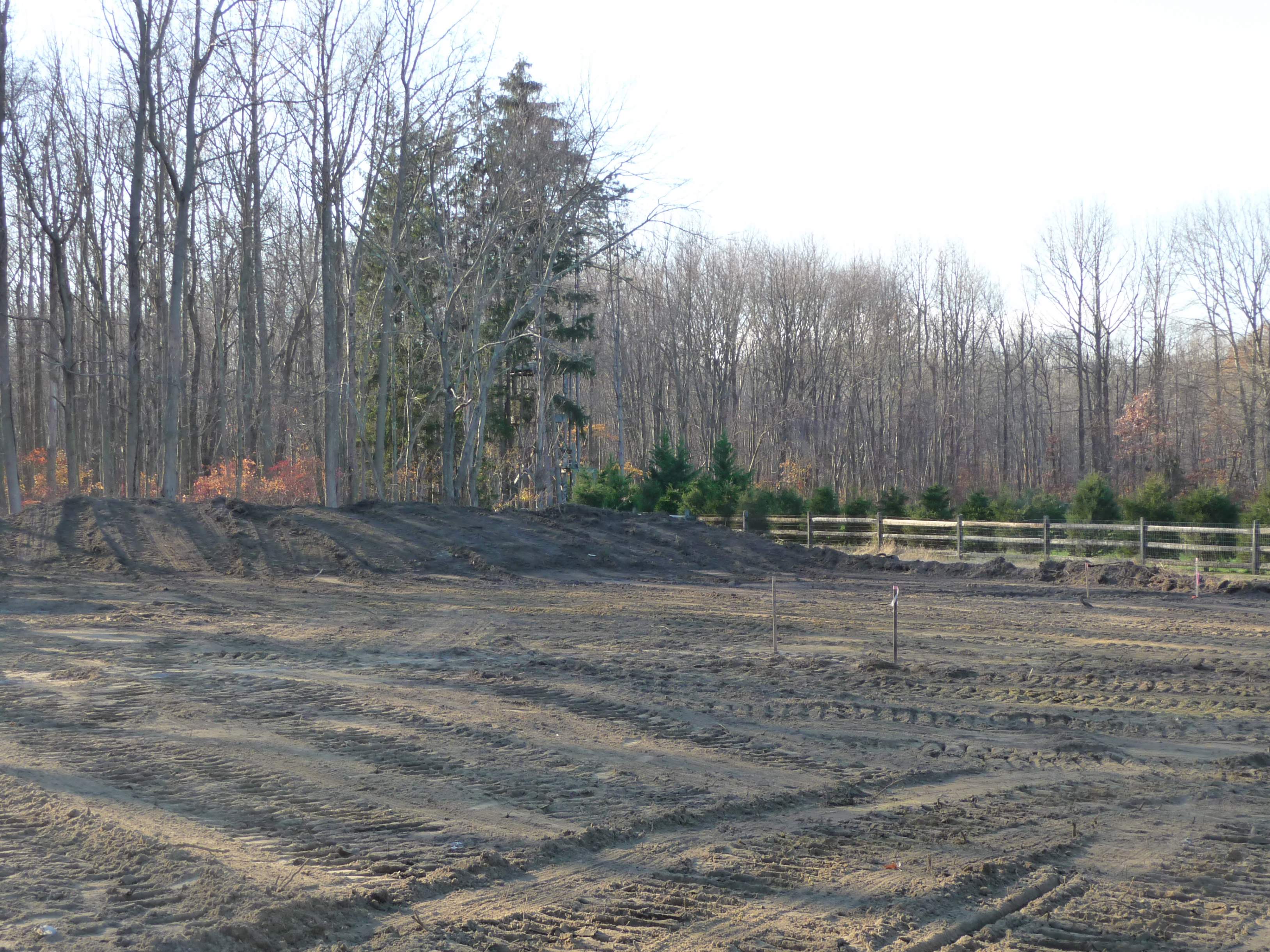

So, the stumps are gone, most of the equipment is gone. The topsoil has been pushed away and the the box has been staked out. The surveyor has marked that the excavator will remove between 10 3/4" on right front corner to 2'4" at left back corner.
This puts the 9' basement walls up 8' on that corner and 6'8" on the back corner.
The footings will be dug out and formed on Wednesday of next week, poured on Thursday and walls up the following Thursday.
Today's pics below.
Here is the view from the back yard toward the front. You can barely make out the excavator's markings going across the middle of this picture.
