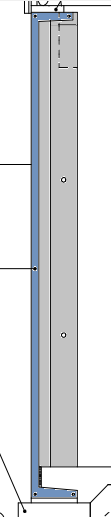

There is a "bond beam" on the horizontal (top and bottom) edges so that the loads are carried on a flat surface bottom and a solid sill plate surface topside.

Here is a cross section (in blue) of a superior wall. You can see the top and bottom bond beams as well as the ribs that make the effective weight bearing surface the full 10 1/4". I shaded the ribs in the silver color.
