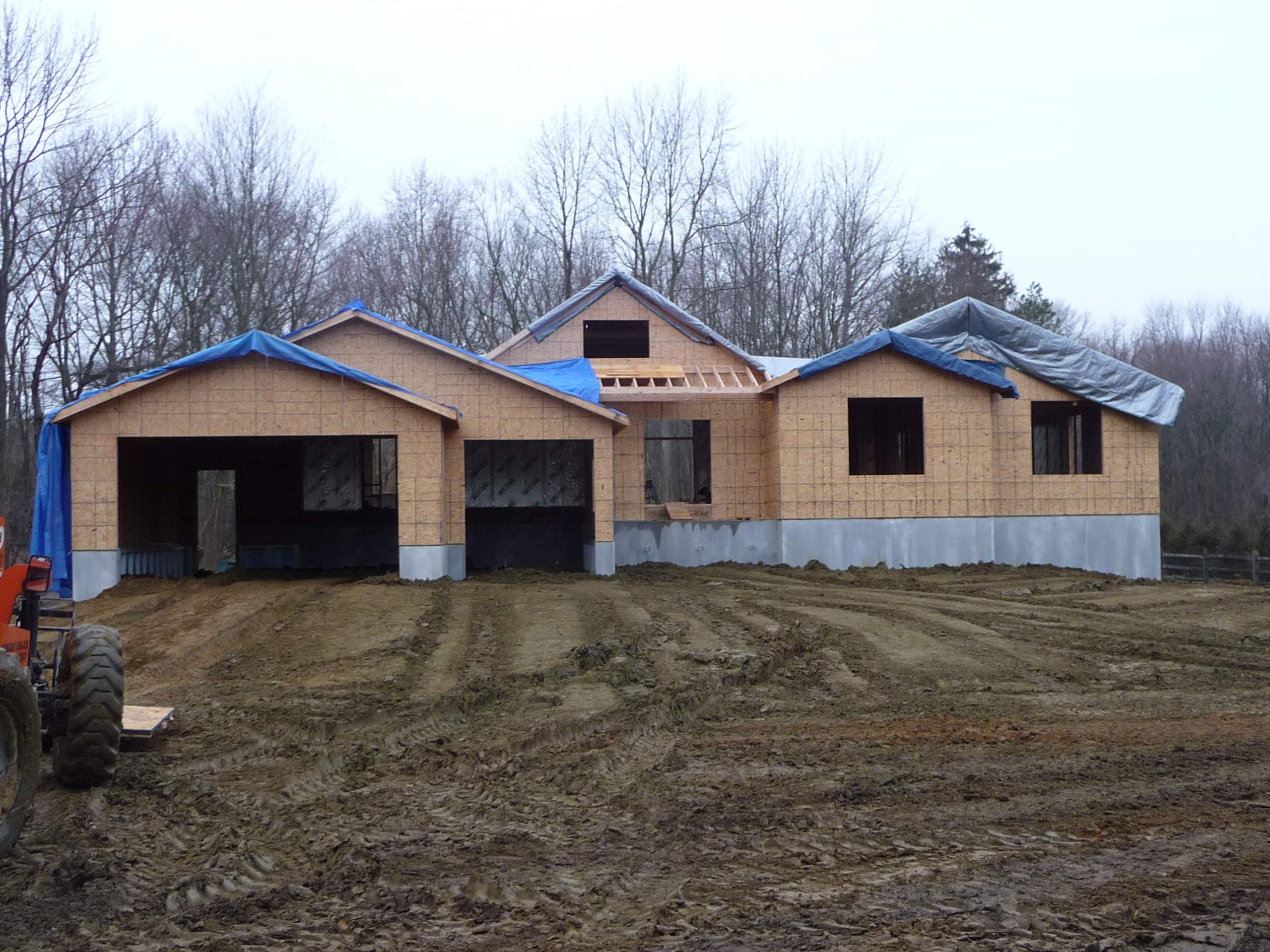

Well, the 25-35 MPH winds yesterday made for a nerve wracking day. I am shocked that ANY tarps remained. My wife asked me last night what the sound was (wind rattling the cheap windows of the place we are renting) and I told her it was the sound of the tarps 2 miles away. :laughing:
Cold morning and the framers were grumbling this morning, but it is getting better. The winds died down through the day and it actually made it into the upper 30s. Almost shorts weather :laughing:
Lots going on over the weekend. 30 loads of fill were brought in. 15 were pushed around and 15 were staged for use in the back. Unfortunately, the ground was too muddy over the weekend to get it there. The garage is mostly filled and will have to push some around with my tractor after it dries out some.
I also started tearing down the cinder block shed in the back and putting that fill into the 4 x 14 x 9 porch cavity.
After speaking with the architect and Raycore, our climate is not so susceptible to thermal bridging and moisture so we are not putting the extra insulation on. That decision was based on their answers and the fact that I cannot afford additional delays to buy/deliver/wait for it. The weather is so "two steps forward, one step back" that I need to keep the framers moving ahead. It's a compromise and I have to go with the experts opinions.
The sheathing is all on all of the roof and the crickets have begun. It's possible that they can have them complete and ready for inspection tomorrow, Wednesday at the latest.
The windows and french doors are being delivered tomorrow and we will begin installing them as soon as we can. Friends are coming over to help later in the week to help with the double windows.

Framing is complete. The sheathing inspection was today. Roof passed just fine. The inspector did not like the amount of spacing on butt seams in some places on the OSB sheathing for the walls. He says that for about these 12 seams, the framers need to run a saw up the joint to make a 1/8" kerf. :mad:
The framers did have it done correctly ... I witnessed it. Unfortunately, with all of the rain, the OSB swelled and the 1/8" closed up ... as designed. It won't get any worse than it already is.
So the framers were none too happy to have to do this but they did it. The inspector will be back tomorrow to check it out.
In the meantime, 11 windows are in. Five more to go and the two french doors. These will have to be done on Sunday as they are calling for rain/snow starting tomorrow afternoon and clear on Sunday. We need to get them in by Monday night as the telehandler goes back on Tuesday.
The shingles go on starting on Monday.
Lots moving ahead now.

We finished getting all of the windows in before rain tomorrow. Sweet. :cool: Only the two french doors to go. Tomorrow will be preparing them (flanges, screen tracks, etc and building some staging depending on how much mud/muck we will have to deal with.
