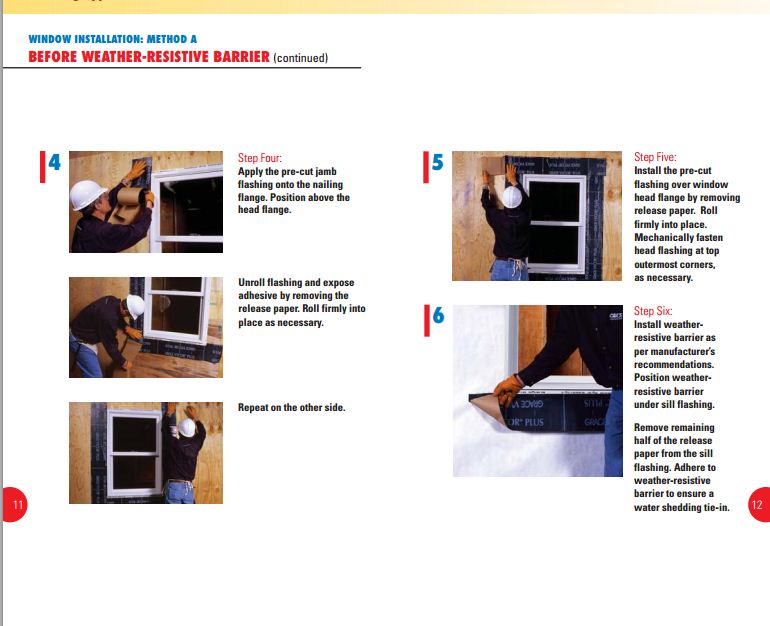

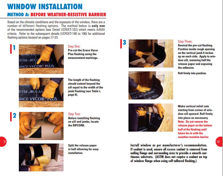

Here are the instructions for vycor instructions and also in a recent JLC article.

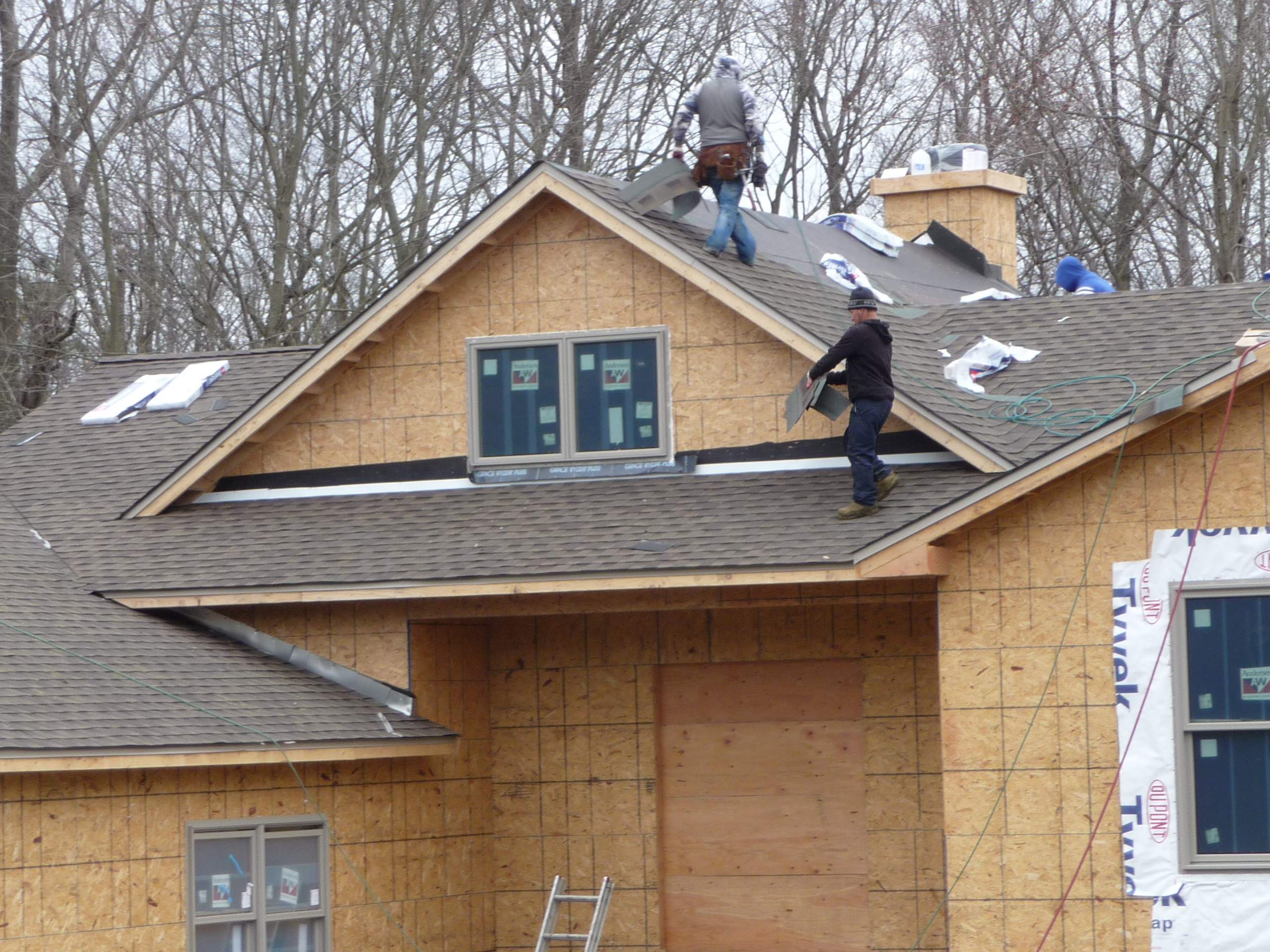

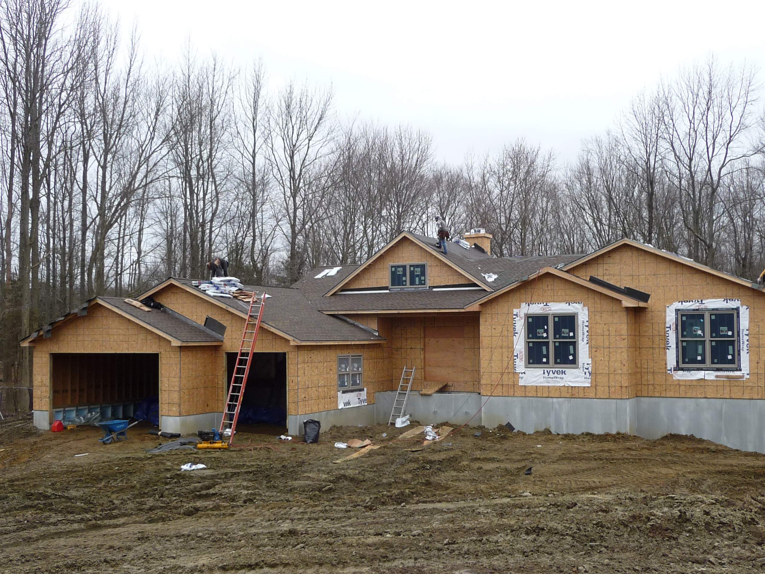

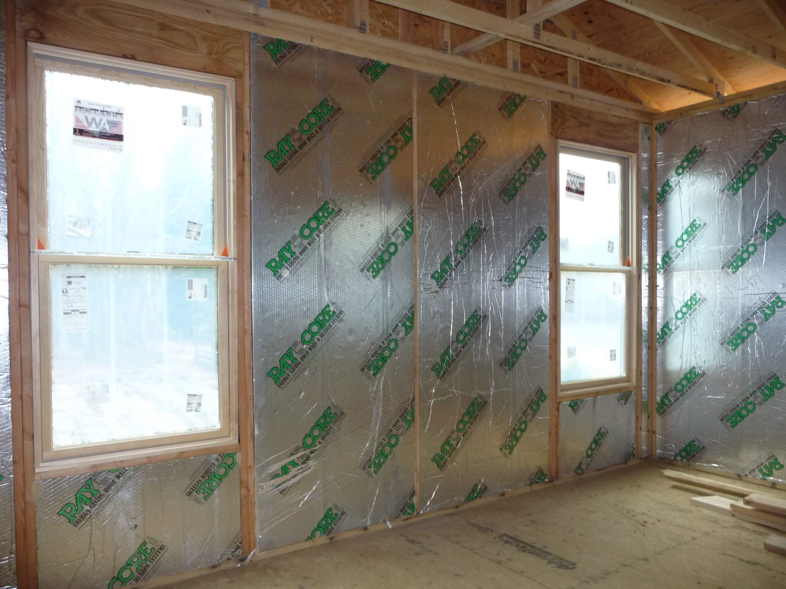

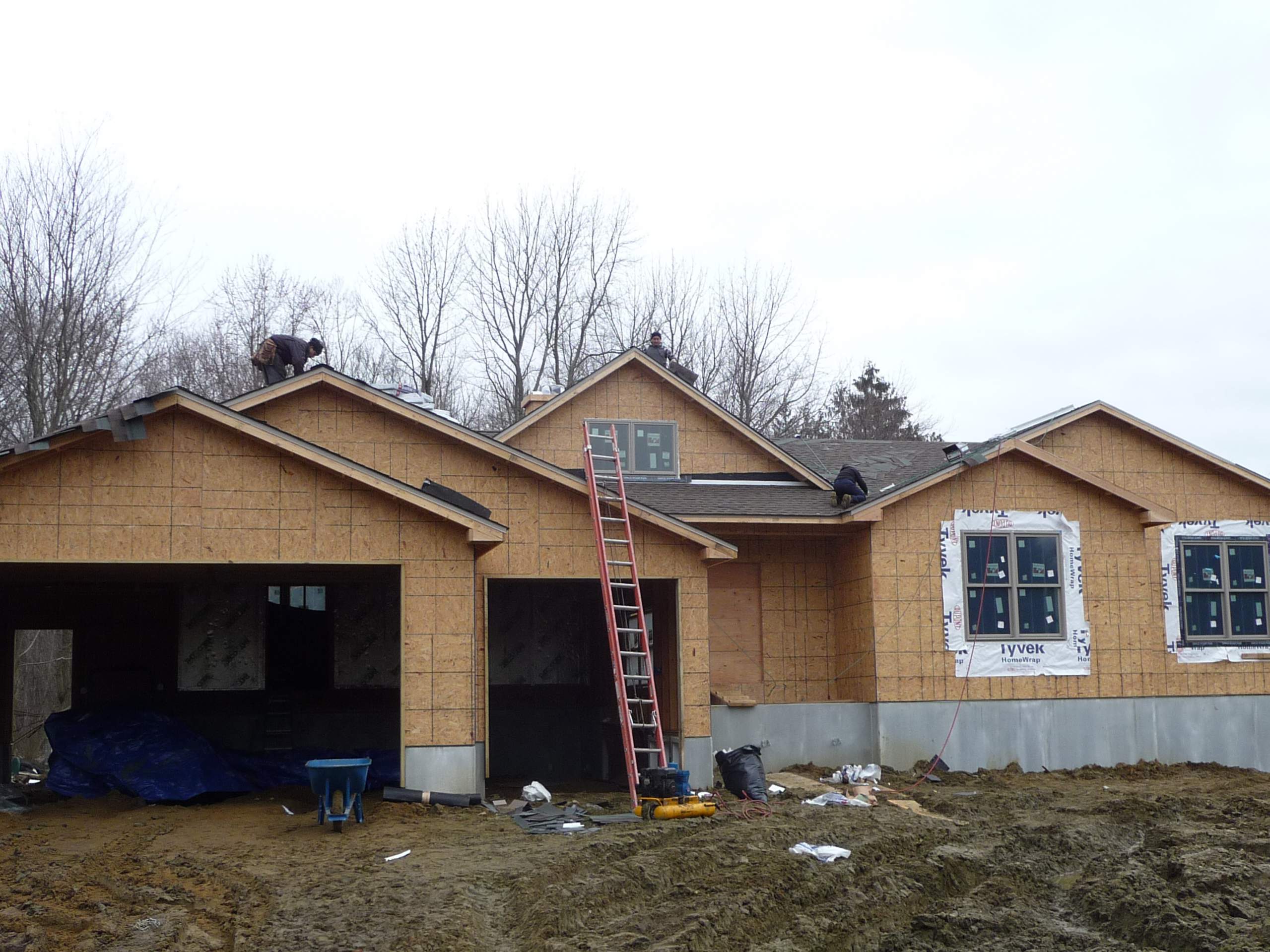

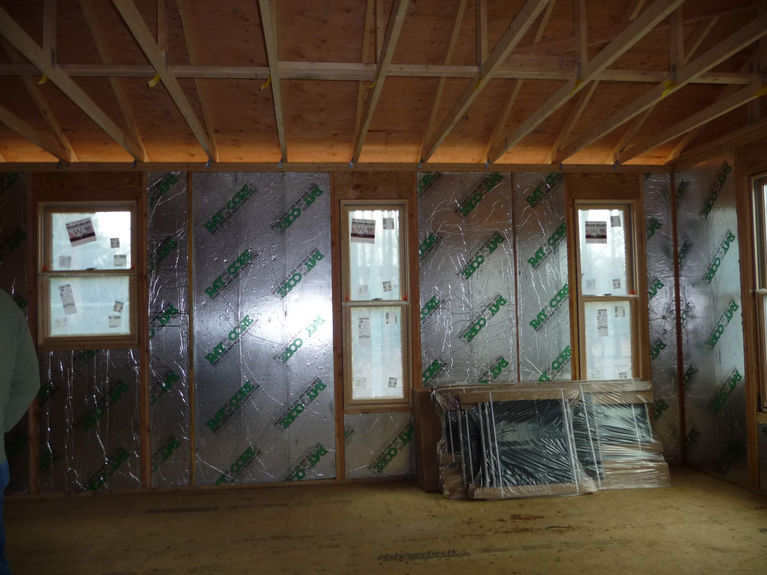

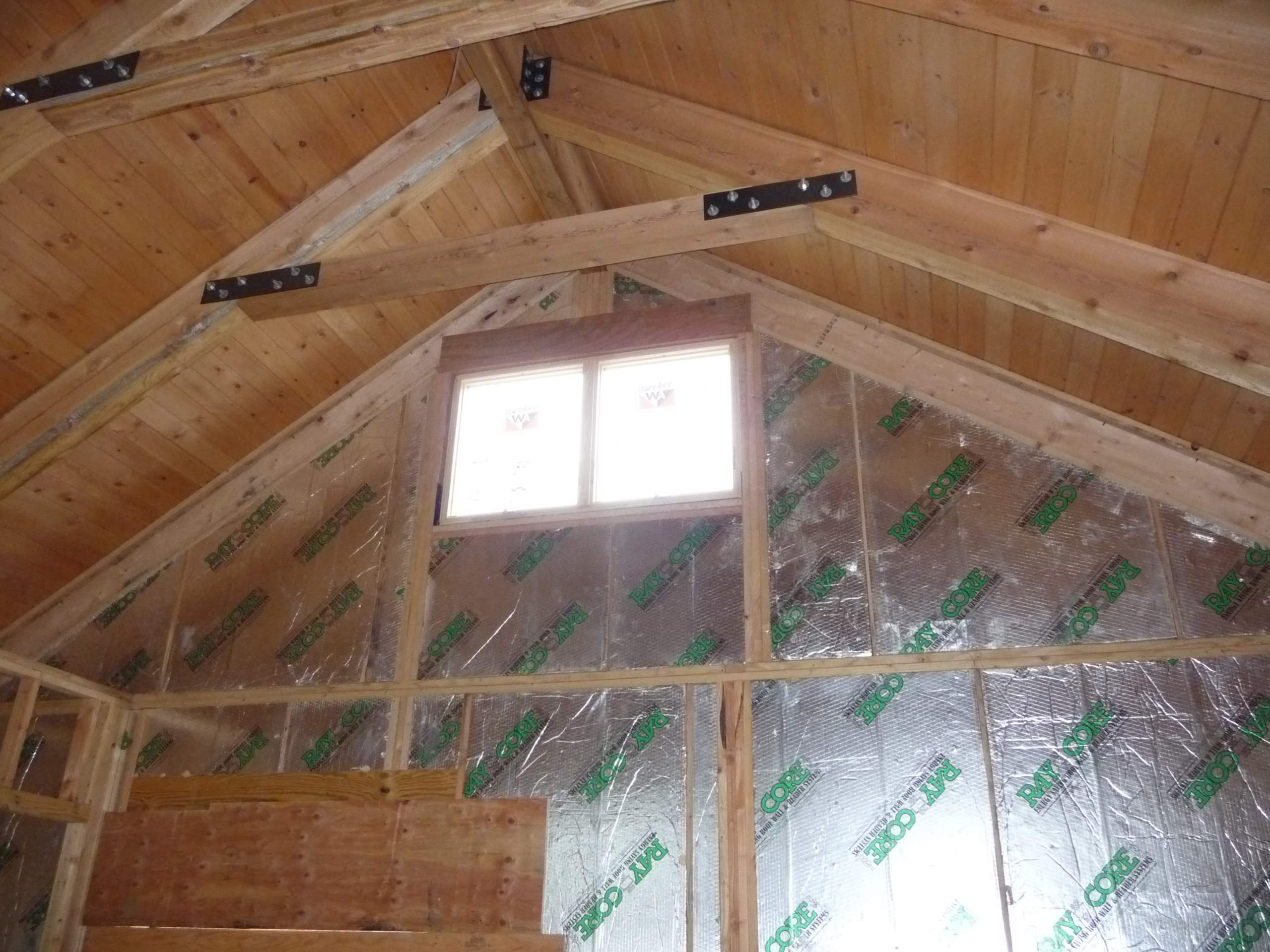

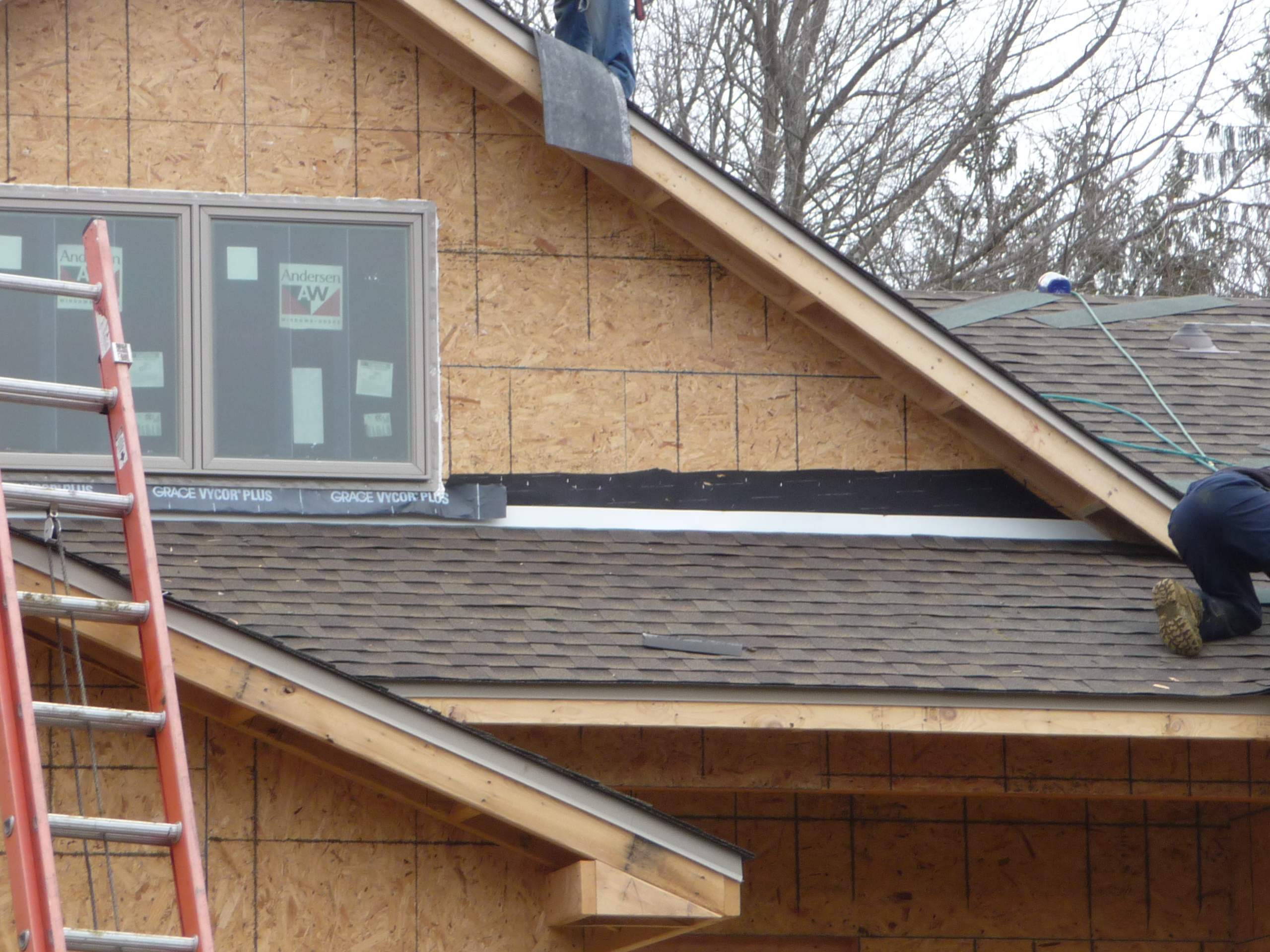

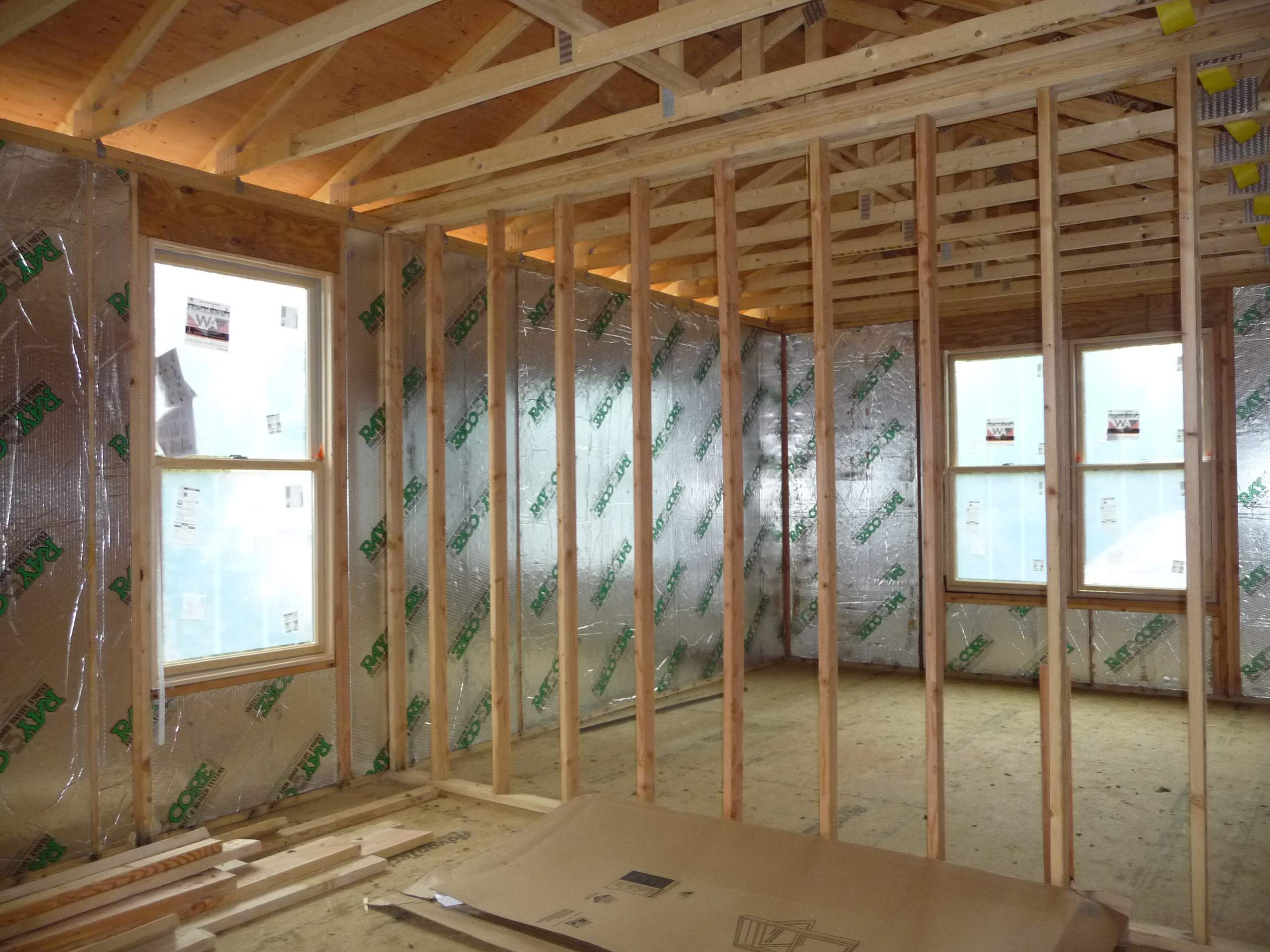

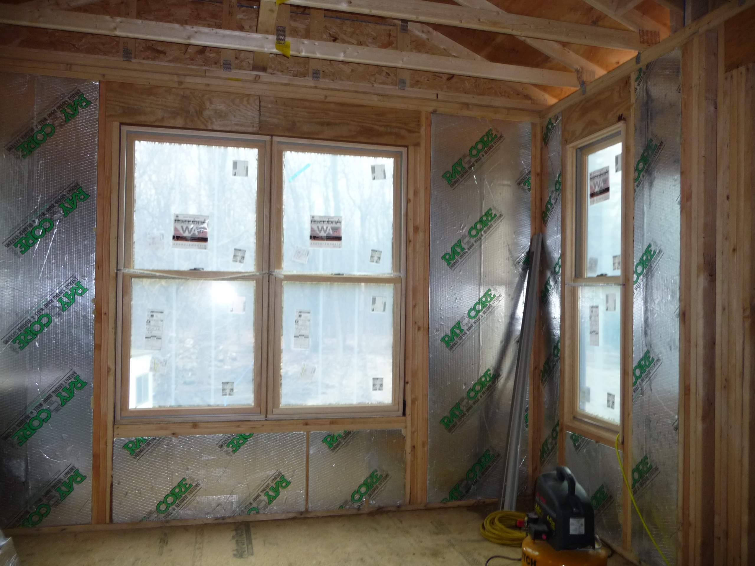

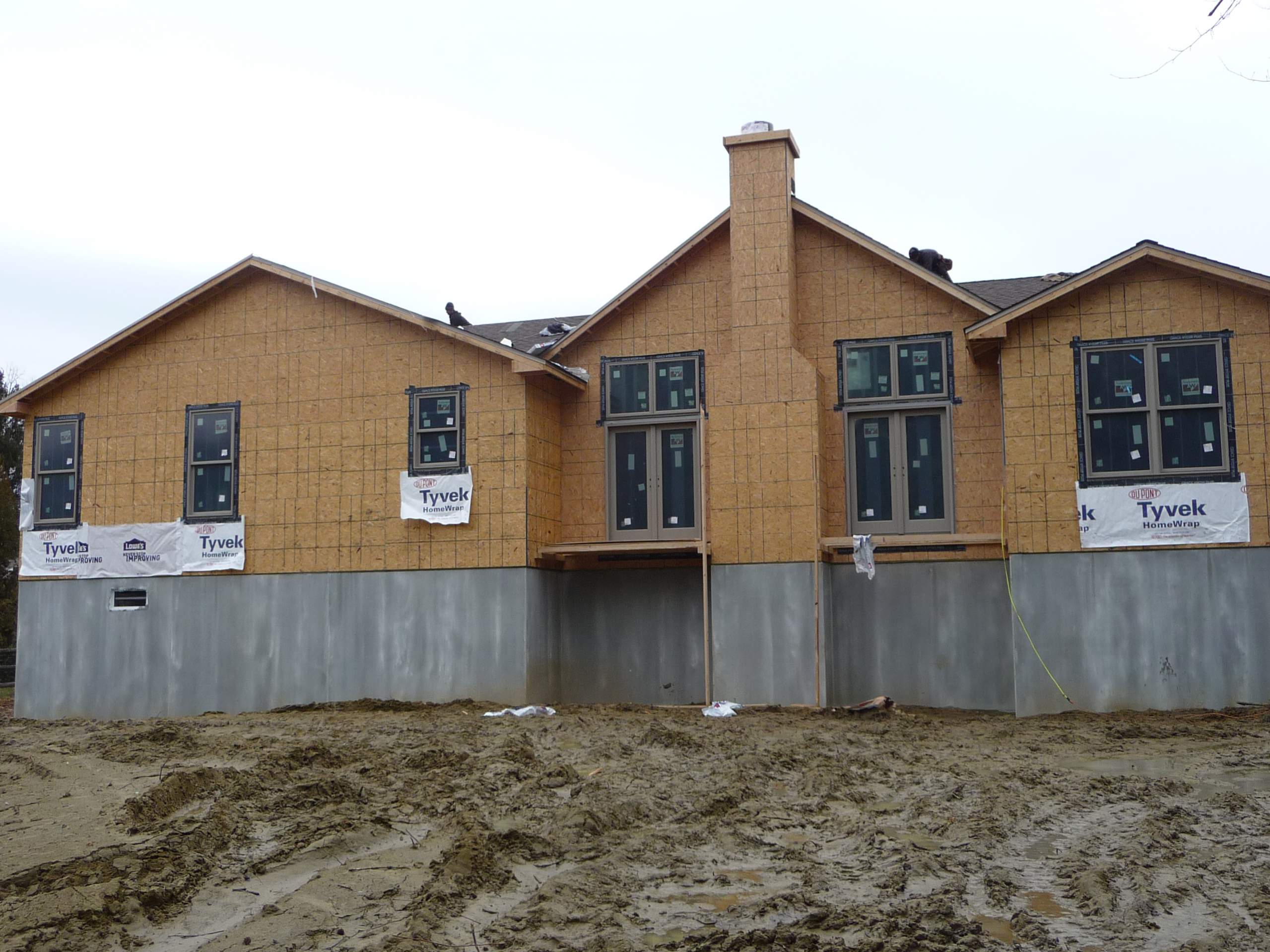

More pictures as the house is now weather tight. Roofers are wrapping up as we speak with rain and wind on the way in a few hours. Next up ...
Housewrap and siding. Plumbing rough in. Electrical rough in.
P1020798.jpg P1020799.jpg P1020800.jpg P1020801.jpg P1020802.jpg P1020803.jpg P1020804.jpg P1020805.jpg P1020807.jpg P1020808.jpg P1020809.jpg P1020810.jpg
   / New Home Begins #430
Looks great. I really like the cathedral ceiling and the doors at either end of the fireplace... nice touch. :thumbsup:
