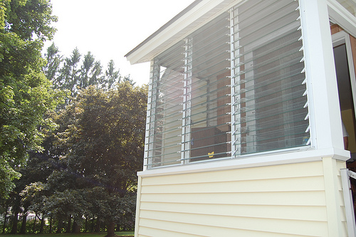

There's nothing quite as bad as jalousie windows. I had them in a Florida room of my last house. When the cold wind blew in the winter, you could feel a draft anywhere in the room. If I could find the person who designed those, I'd strangle 'em.:mad:
Cleaning them was such a joy. . . NOT!
haha. Brings back thoughts of my youth and homes at the Jersey shores. My dad used to call them ja-lousy windows.
