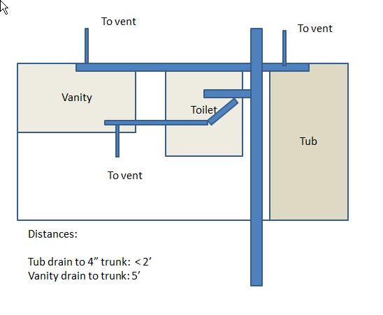

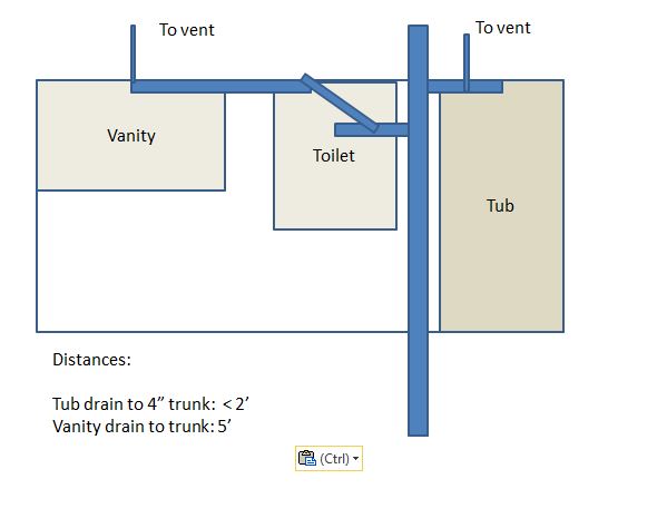

I have a plumbing question if there are any plumbers out there ... can the vent for the toilet run to the vanity beyond the toilet and be used as the drain and vent for the vanity or do each have to be separate and join them together above the flood level of the vanity? Does the tub need a vent or is it's distance ( < 2') from the 4" trunk mean it's ok based on the other venting?
Some very rough block drawing of options are below.
Thanks.
Thanks.
<img src="http://www.tractorbynet.com/forums/attachment.php?attachmentid=312092"/> <img src="http://www.tractorbynet.com/forums/attachment.php?attachmentid=312093"/>
I'm by no means a plumber or have any idea what the plumbing codes are. In our master bath, our toilet and sinks share the same vent. The vent is right behind the sinks but is 8 or 10 feet from the toilet drain. The toilet seems to sometimes have some smell issues. Someone we hired to replace the broken toilet drain ring said we had more gasses coming out of the drain than we should. He suspected the vent was too far from the toilet.

I'm no plumber, but when I added on to my rental house, I was told any fixture 4' or more away from the main stack, required a vent. It could be a separate vent, or tied back to main stack, mine tied back, to the main stack in the attic.
Dave

I figured a way to have the toilet vent tie back into the vanity vent above the basin level of the vanity. The tub is within 18 inches of the 4" main and the plan was approved during the permit process for no vent on the tub as it is so close to the main.
The TJIs for the subfloor make for a tough process for running the mechanicals. So much tougher than in 1990 when I built before.
