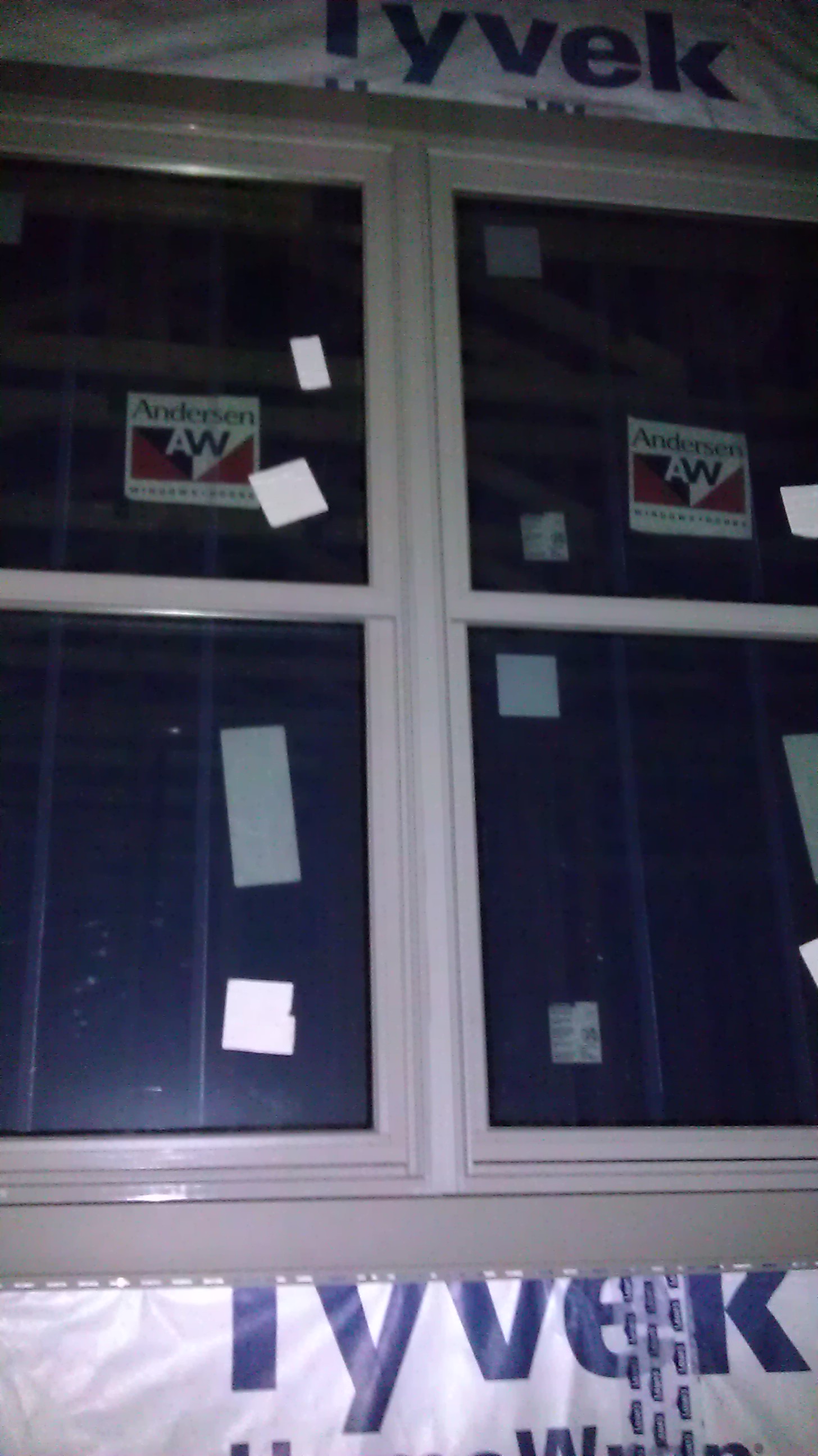

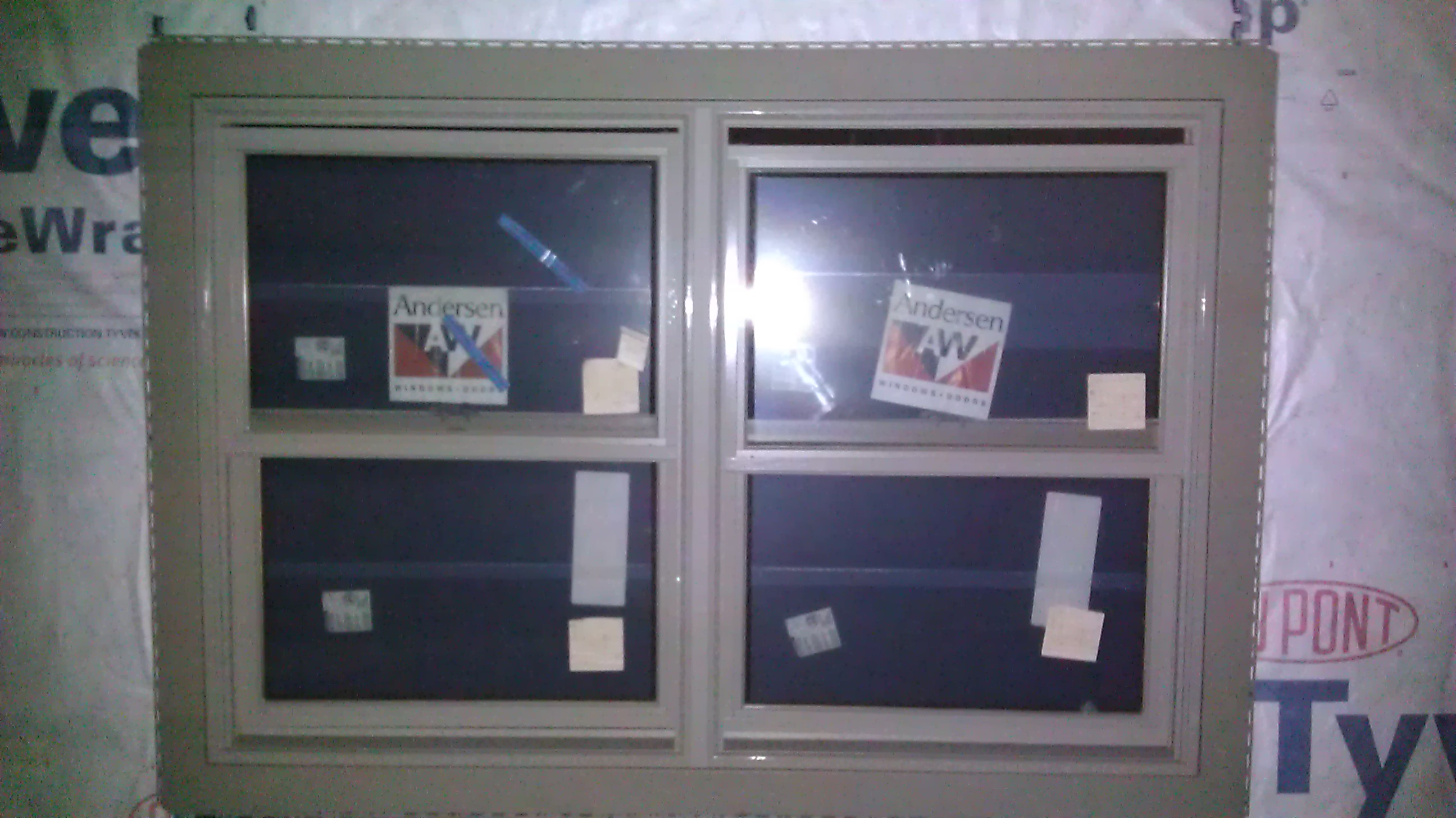

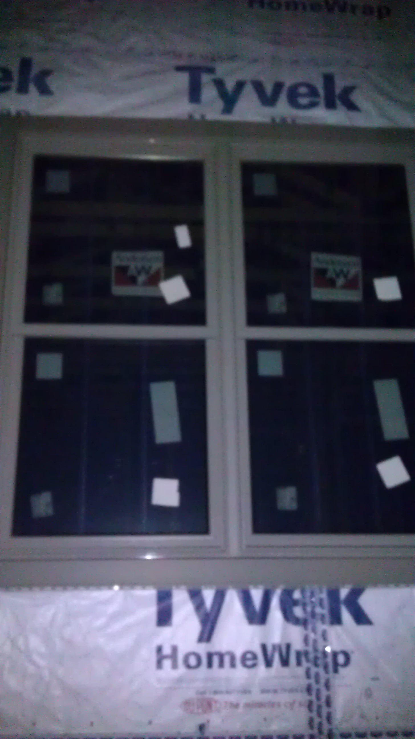

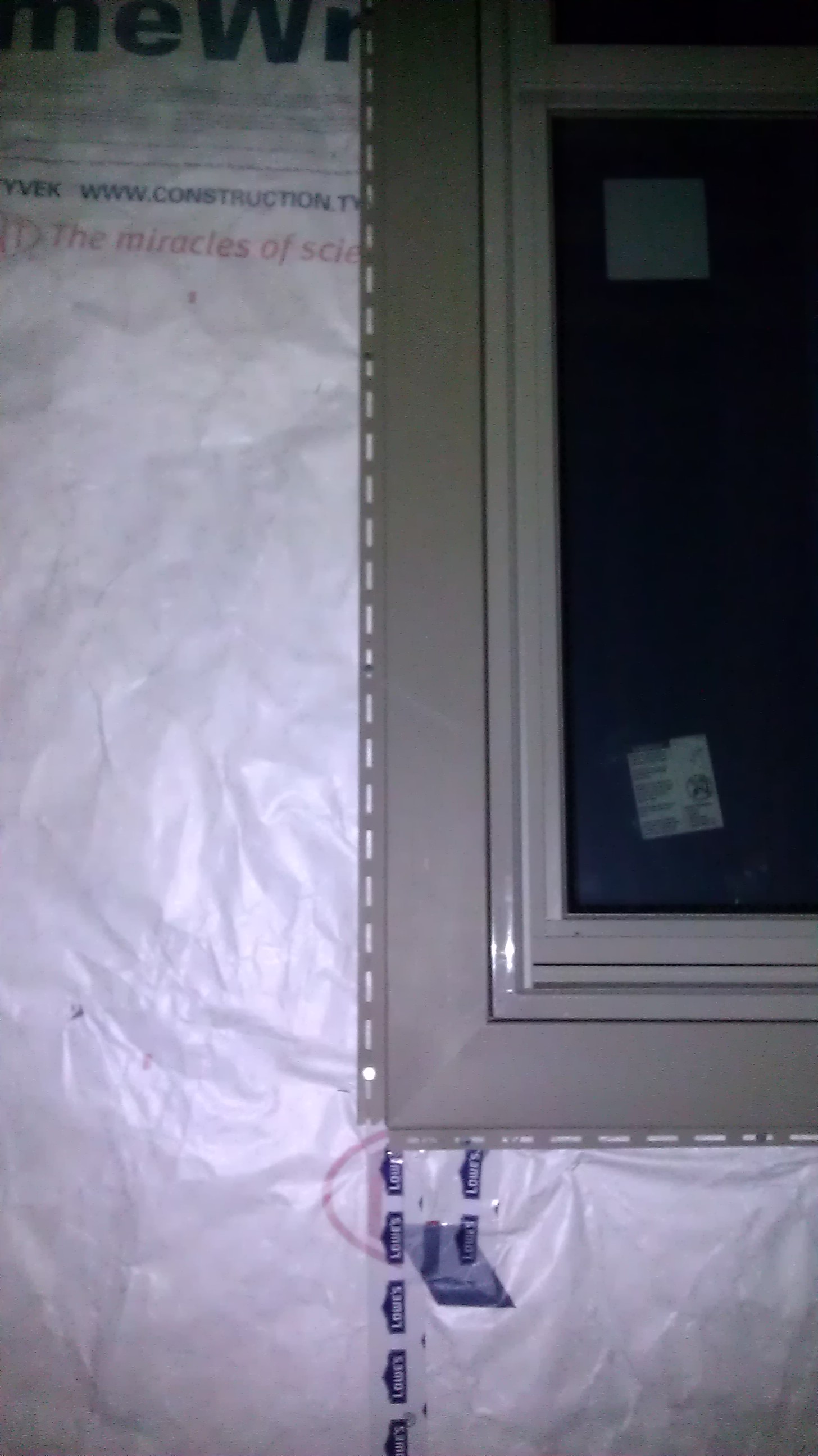

Back on page 46, I was asking opinions for the lineals around the windows. The choices were pine/capped with aluminum, azek or similar but needs painting or vinyl. We settled for the maintenance free. After a slow start with one window, it came back to me. The second window took about 10 minutes, including cutting, miters, starter strips, etc. I am happy with that.
Sorry for the bad quality of the pics as they were taken with my phone, not camera.

It looks fine and maintenance free is always good. Life is too short for painting. I do appreciate the beauty of an old Victorian Lady all freshly painted, but I would never own one.

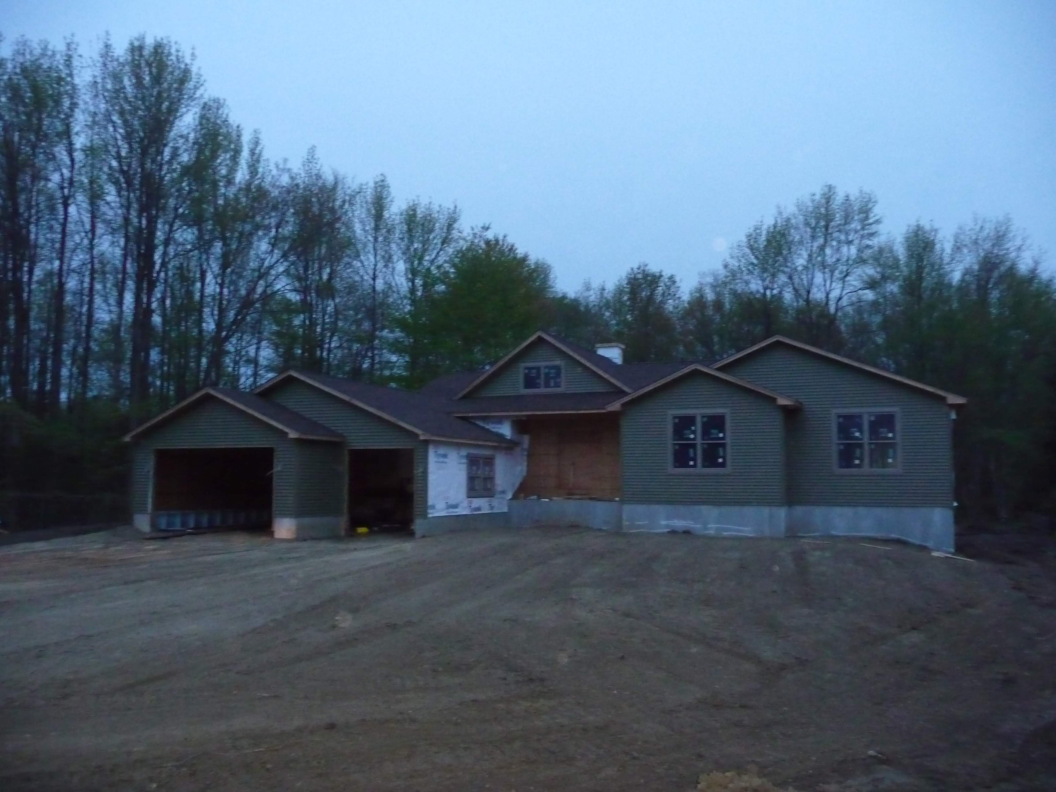

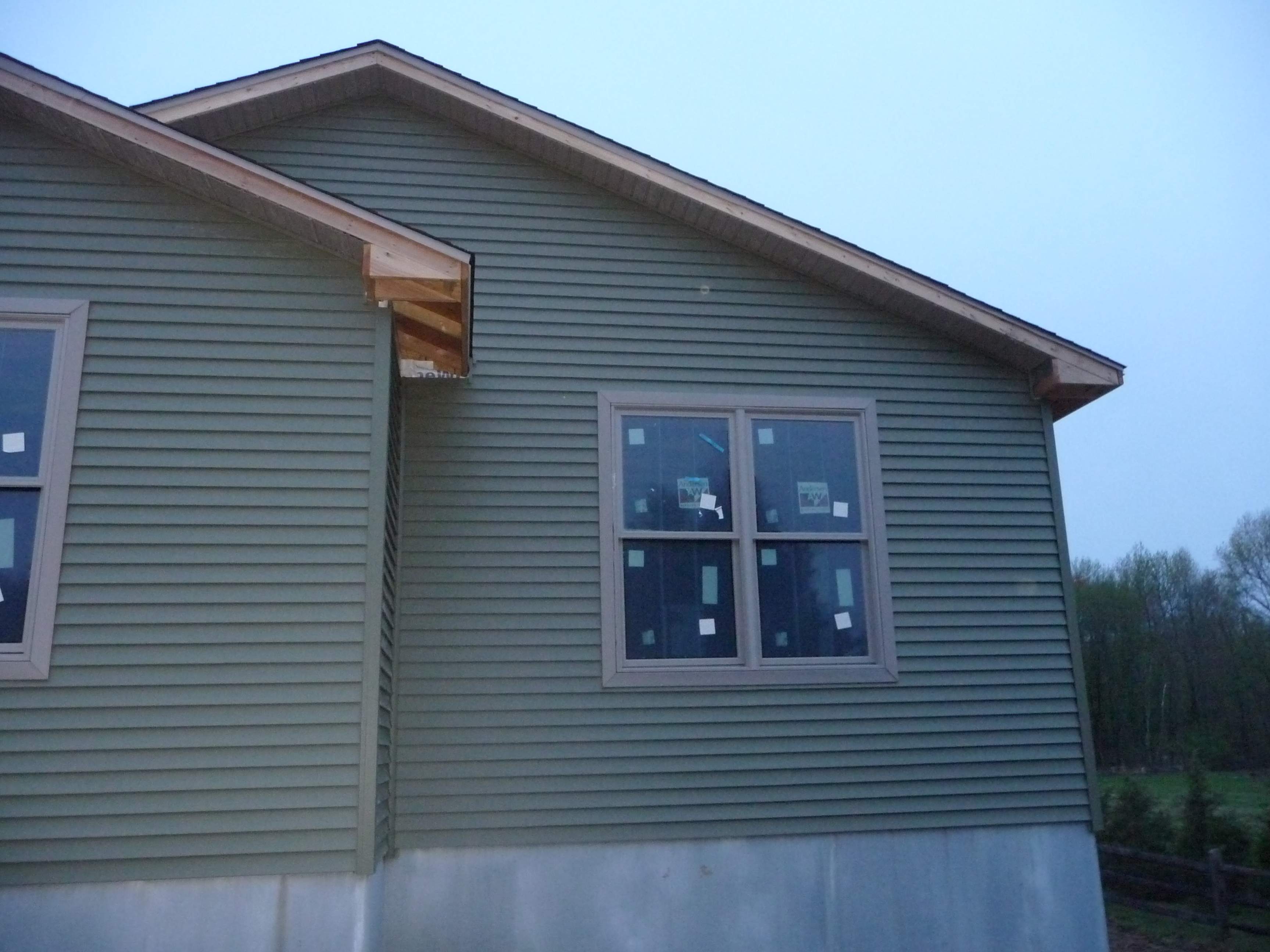

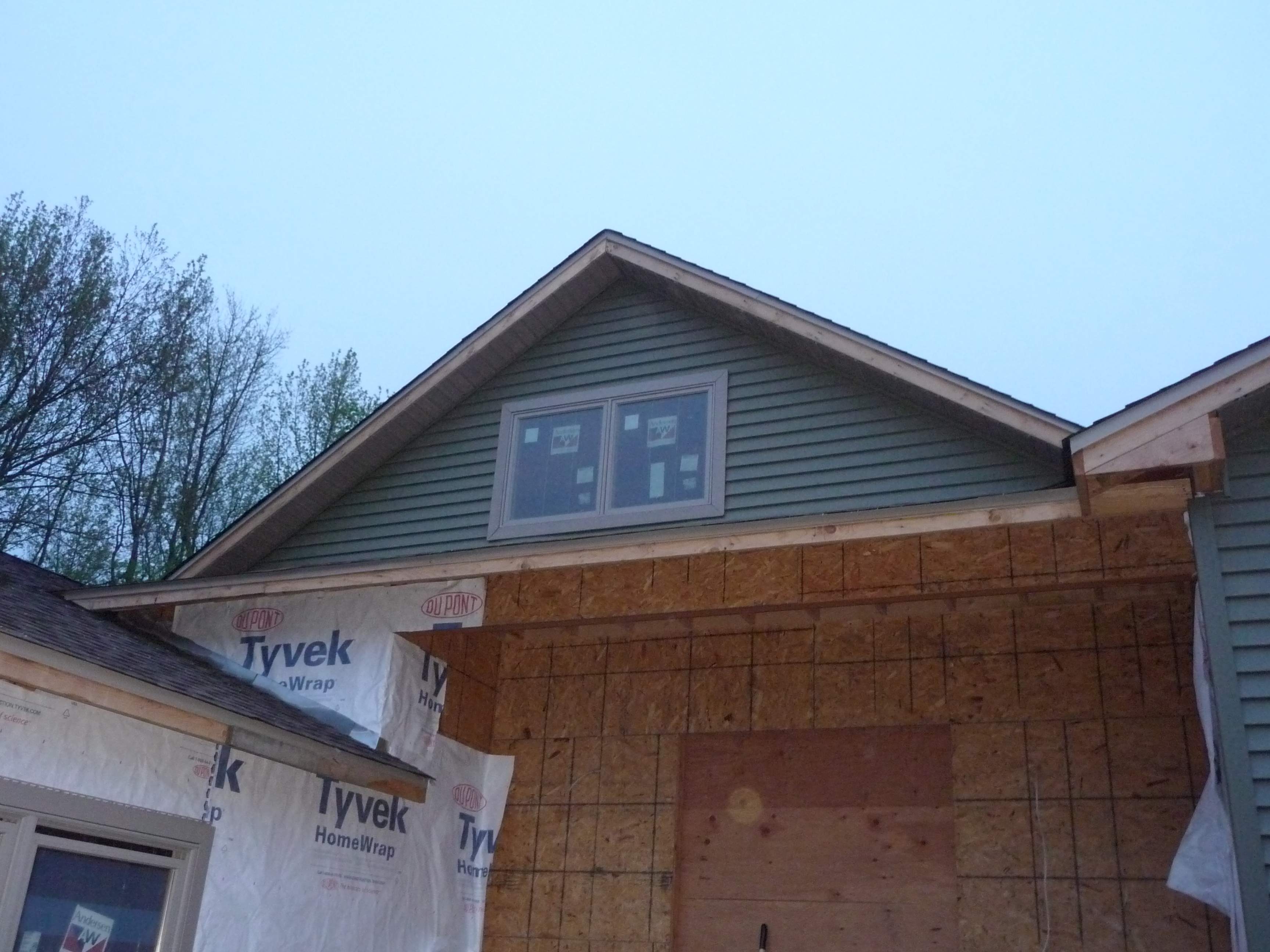

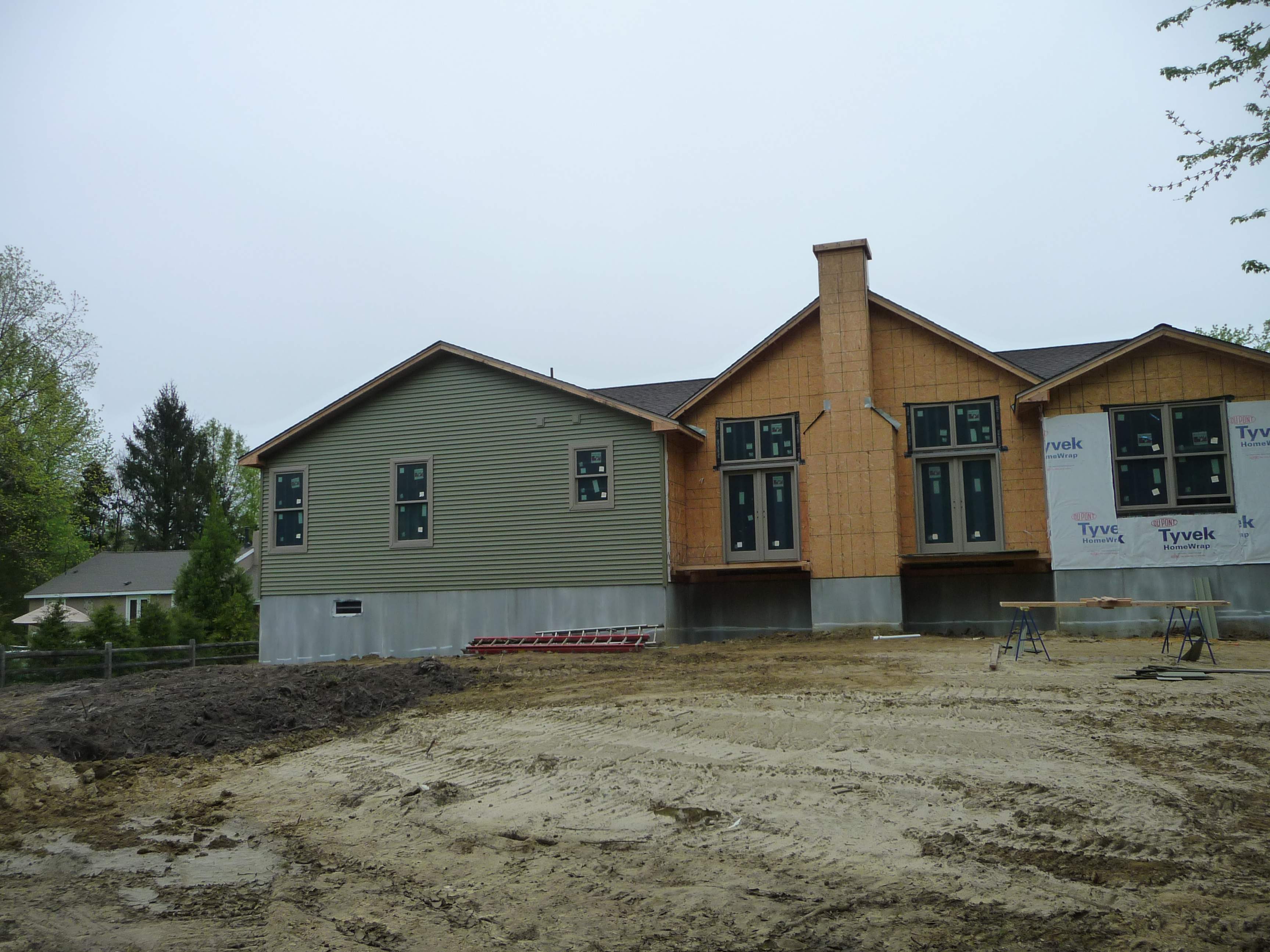

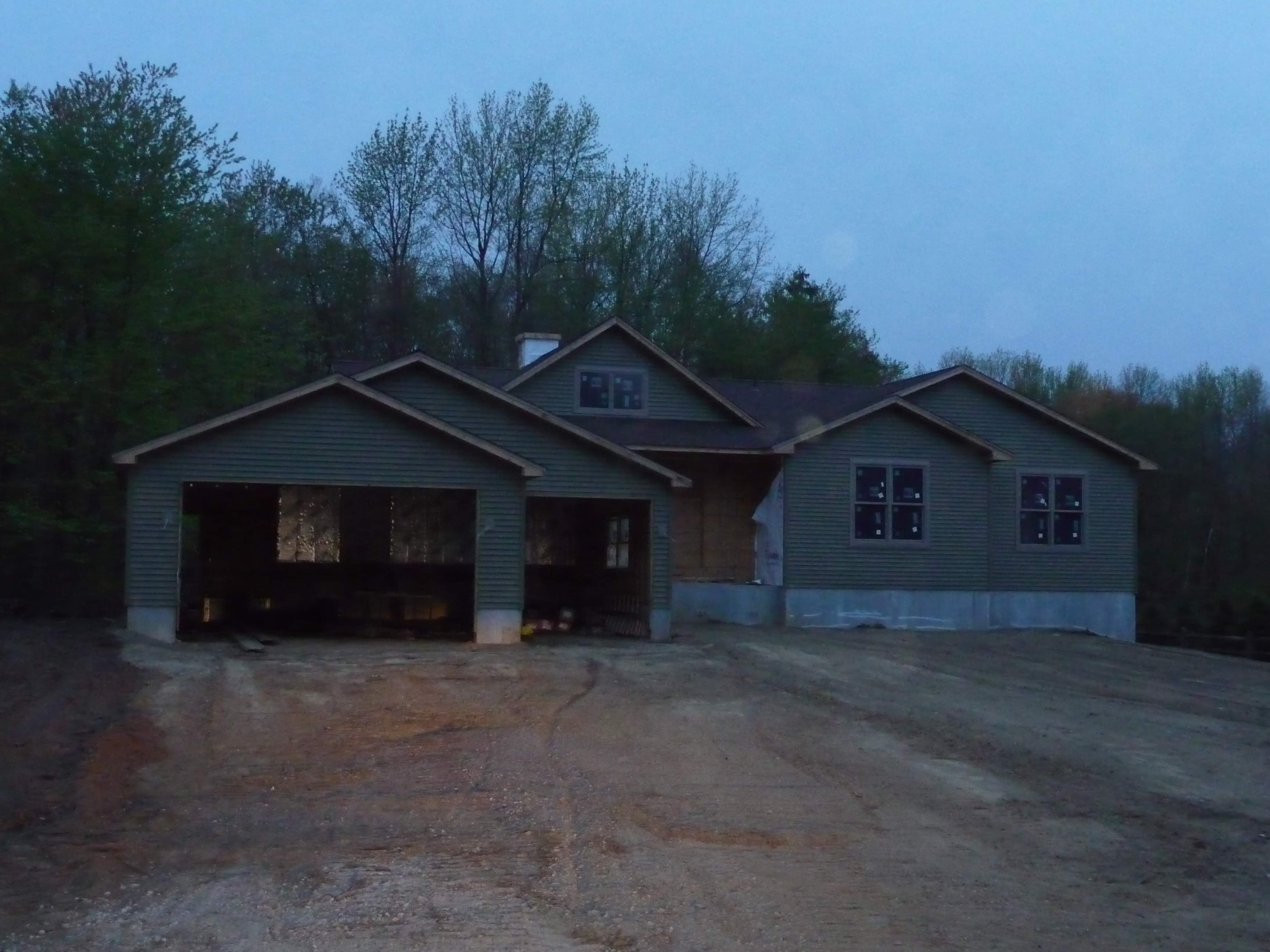

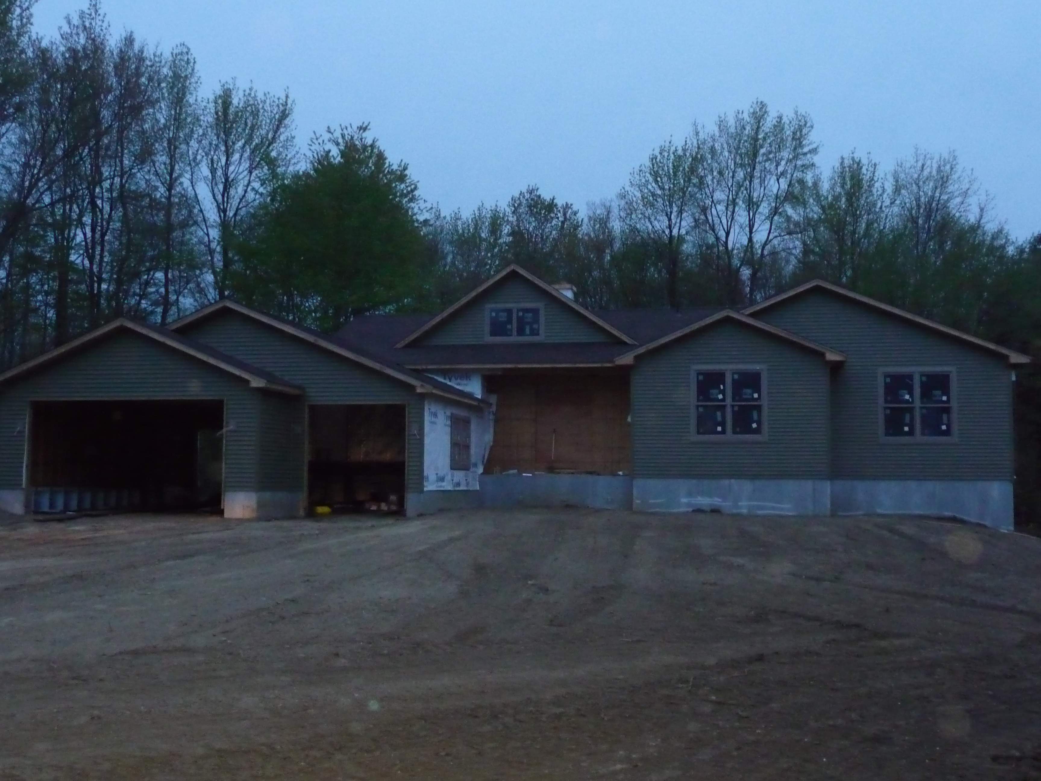

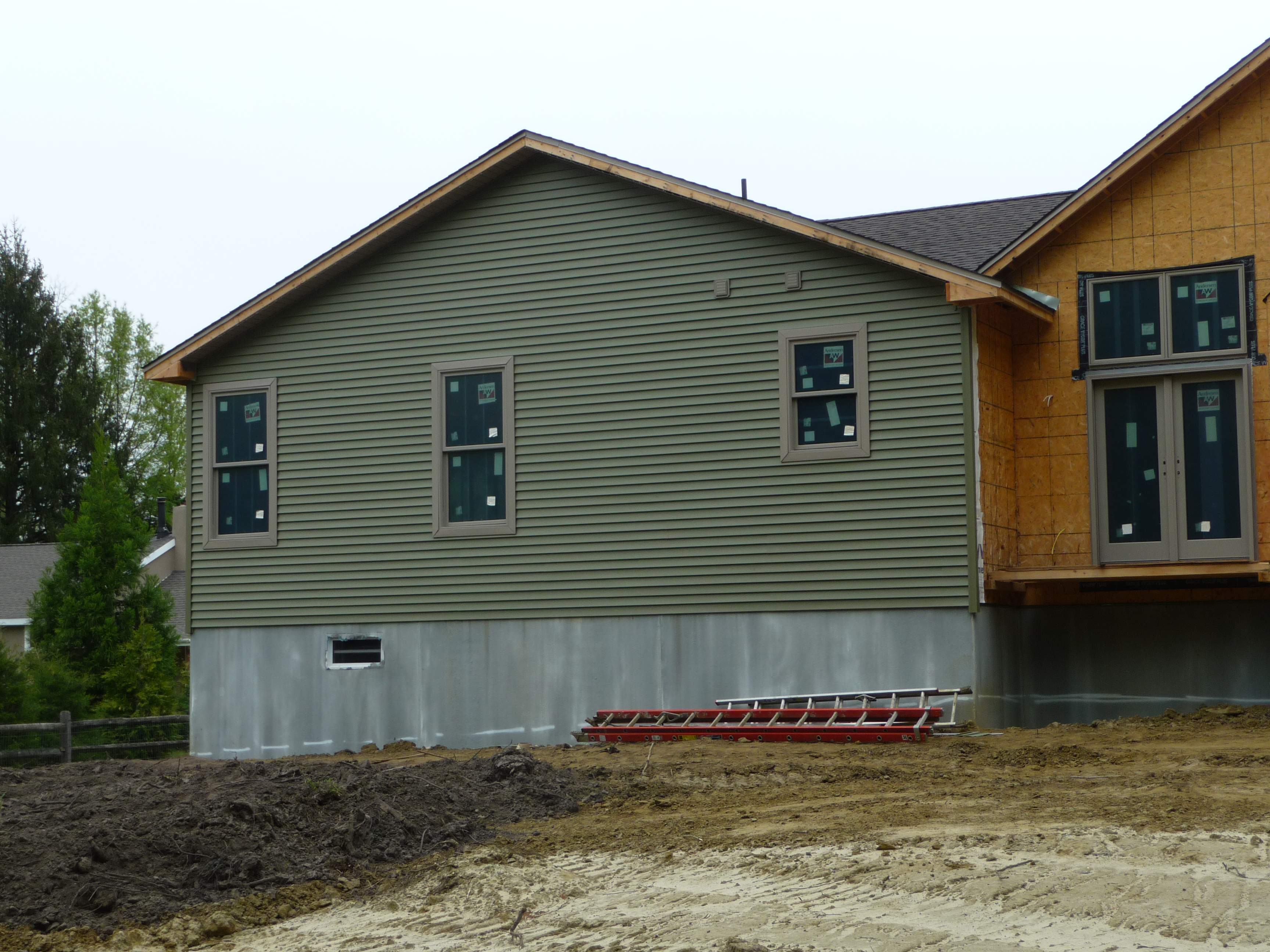

About 1/2 of the siding is up in 8 nights and 1 weekend. Gable end, unvented soffits are up as we go. The vented soffits for the eaves are not up yet as the supplier had to transfer natural clay "F" channel from a different location and is not in yet. What do you think?
The porch and adjacent walls are not done since we are waiting for the concrete porch and garage to be poured so we can establish where the siding will go.
I will be pressure testing the water lines tomorrow and plugging the drains in preparation for the rough plumbing inspection later this week. HVAC next week.
I still have the gas lines to install over the weekend. That will be a combination of black pipe for running parallel to the joists and the corrogated stainless steel gas line for running through the joists. I may jump to 1" from 3/4" in the off chance that natural gas makes it way down the street, but we are told that will never happen. I have been told that 3/4" is plenty for propane.
Have a good night all.

Nice job Tom! I looked back at your first post of your property, you have made great progress.
I think you will be fine with 3/4" gas pipe, most natural gas home services are 3/4", and propane requires more gas per BTU, than natural gas.

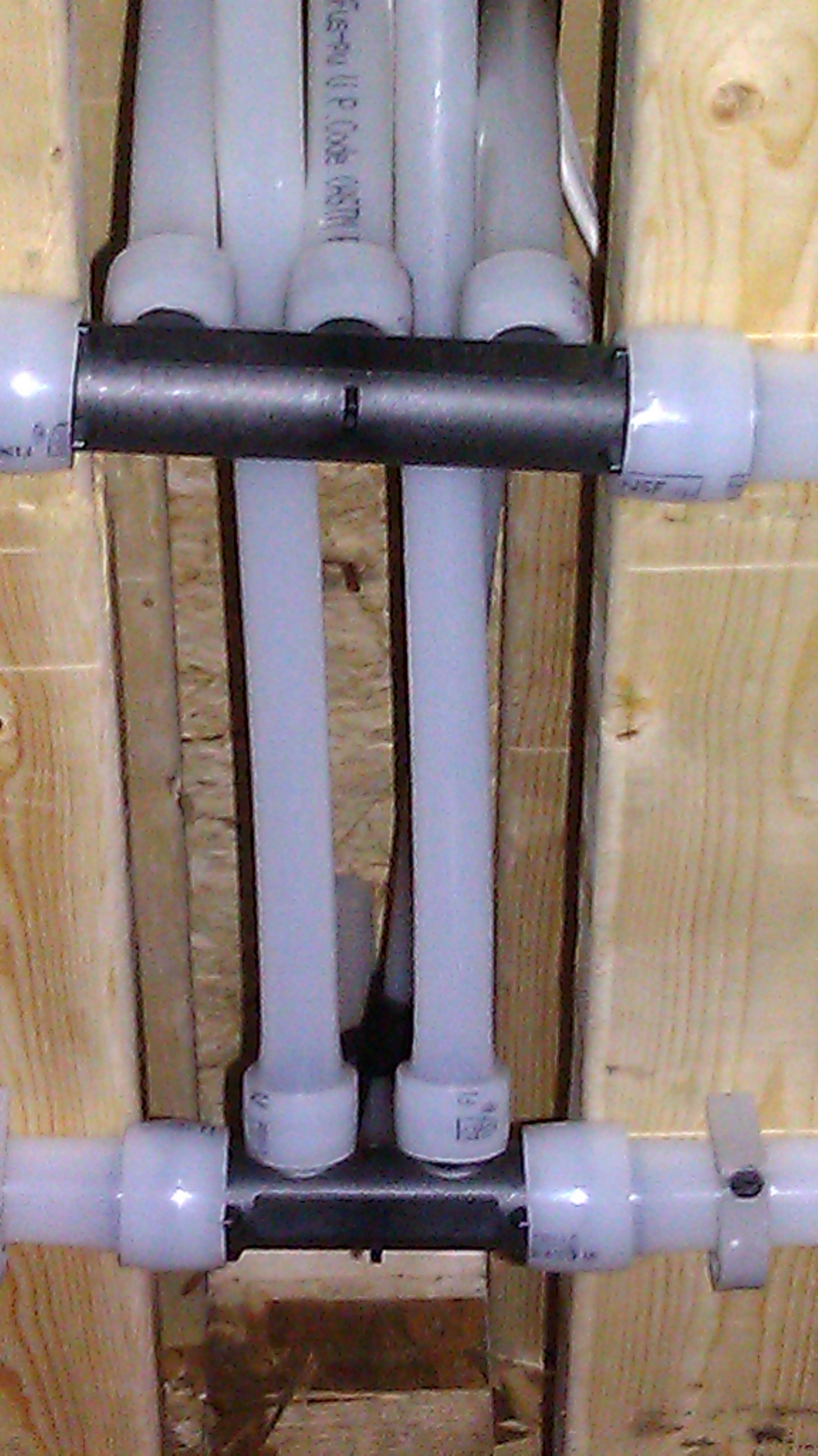

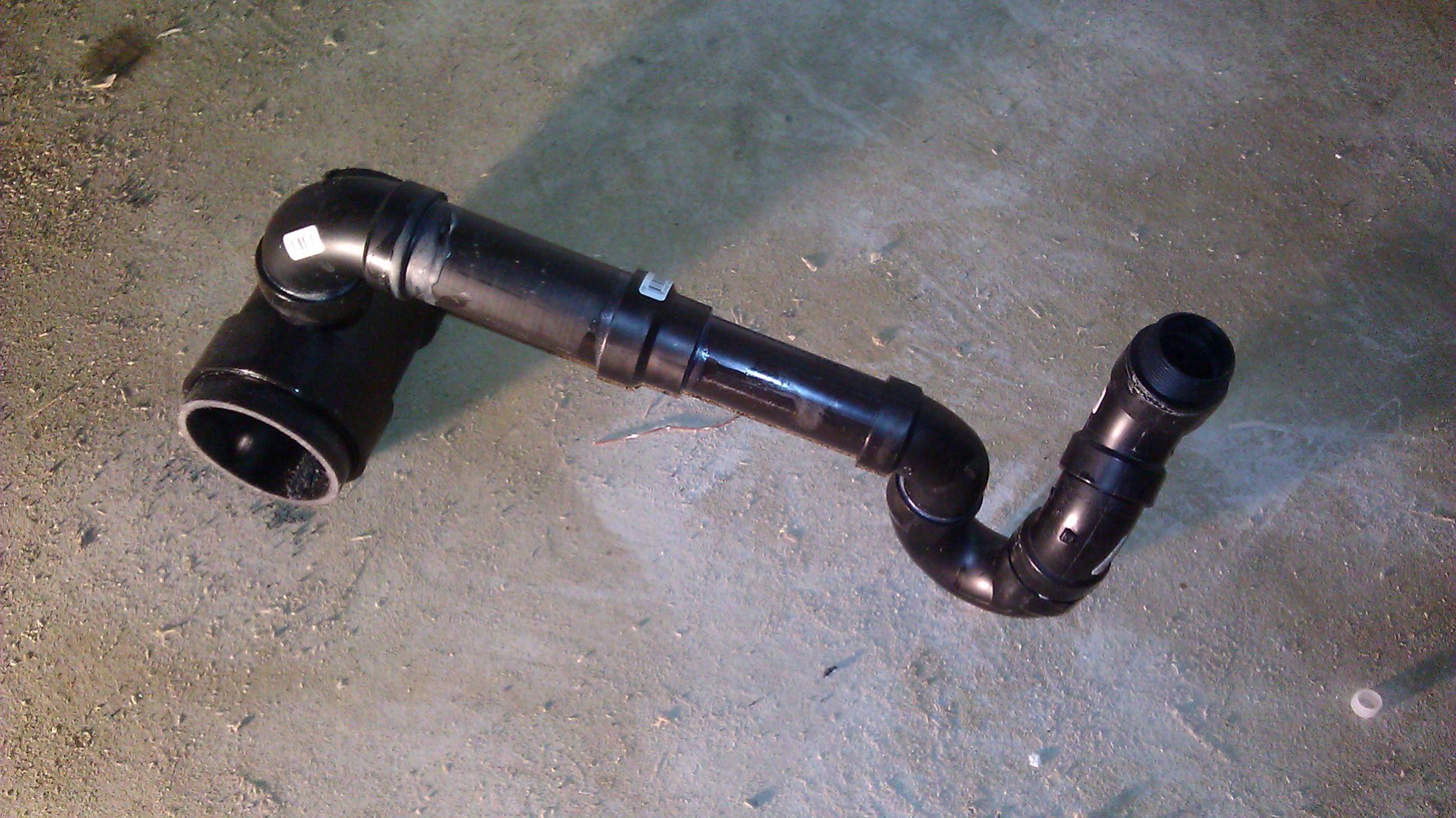

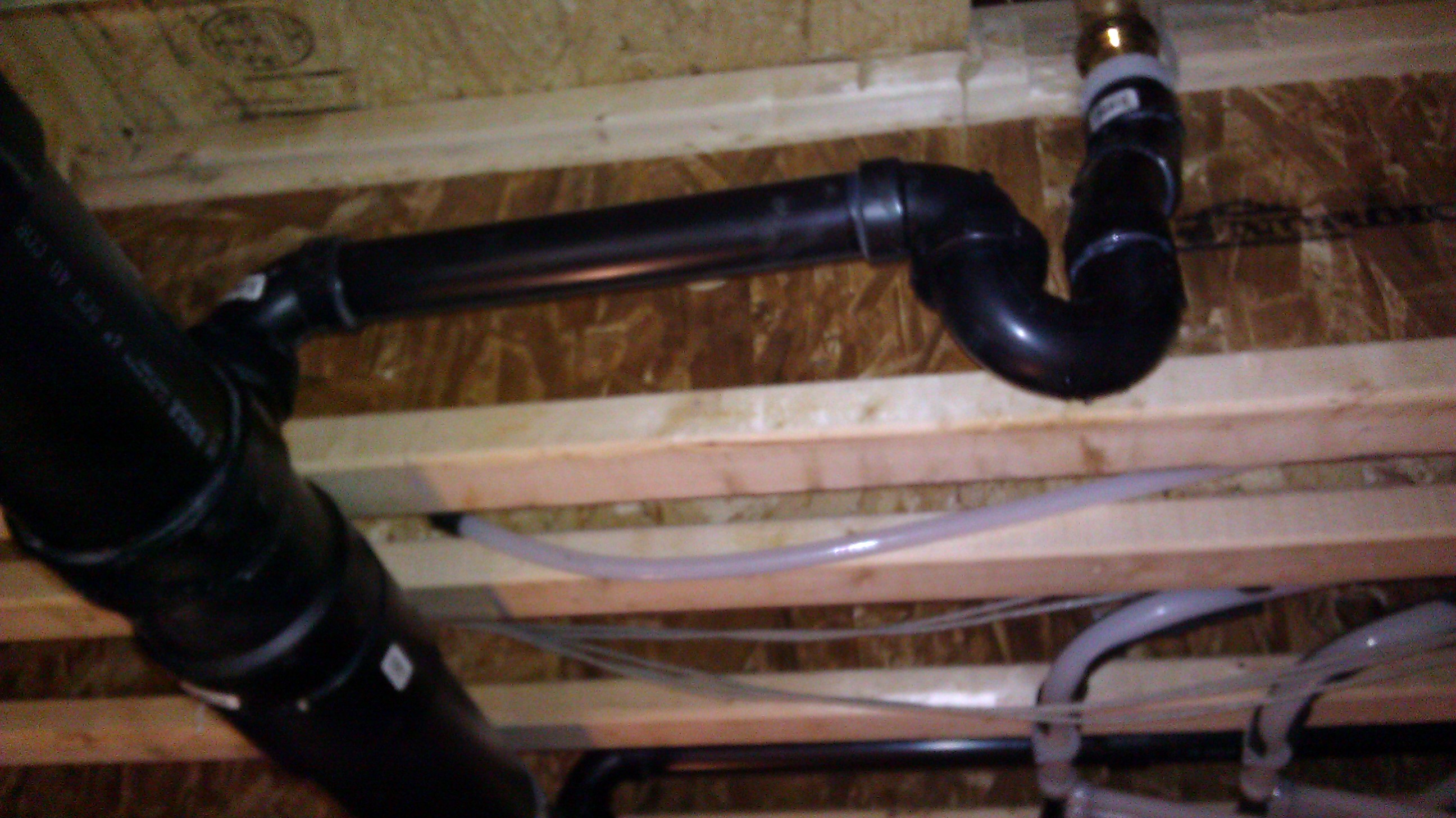

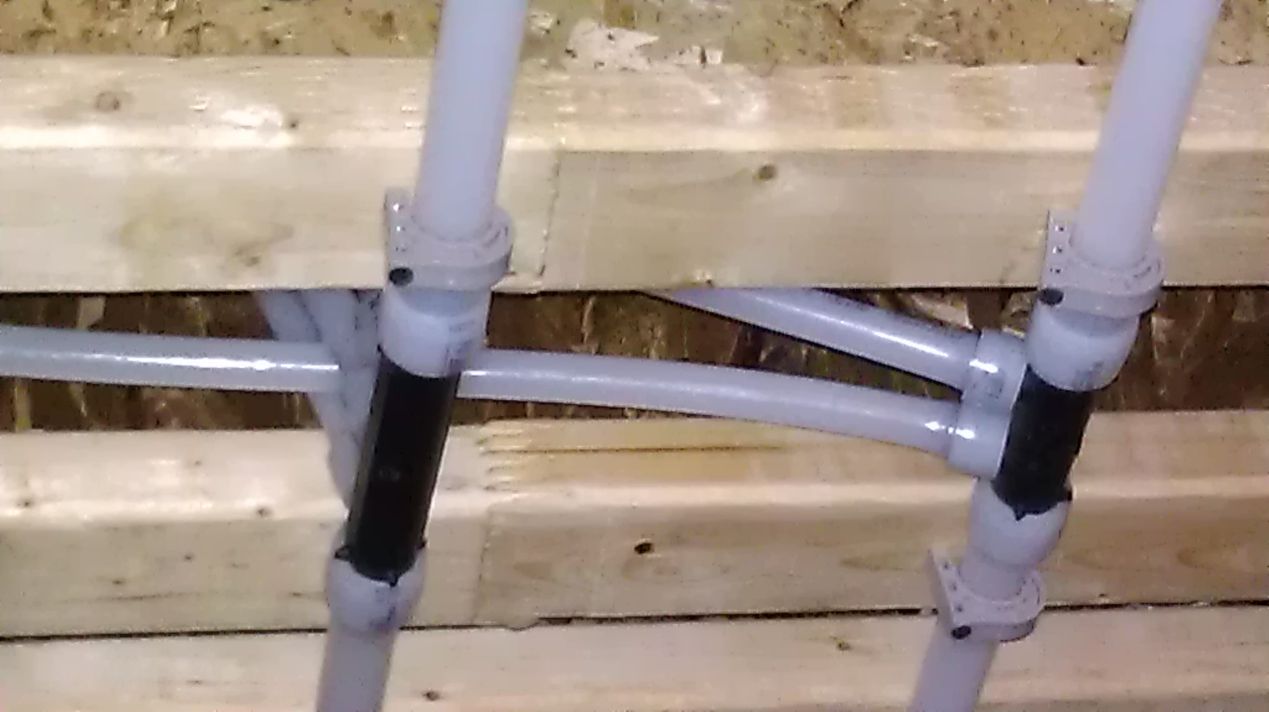

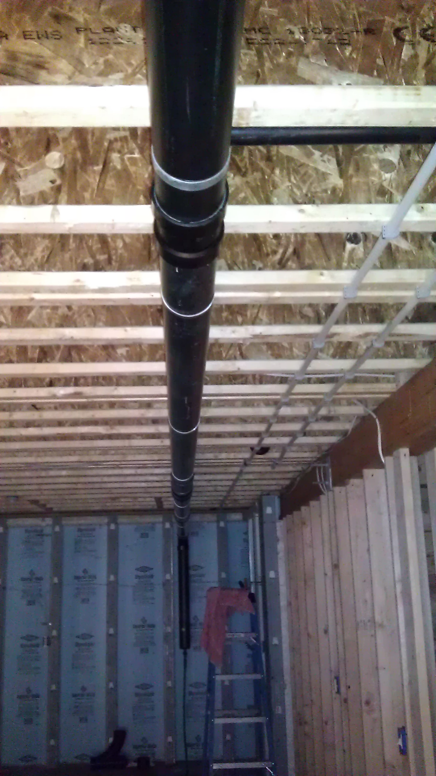

Big night last night. Rough plumbing inspection was slated for this morning. Since we have no well yet, we have no water to flood the drains to test for leaks and show the inspector. Pex lines have been holding 80 psi since Sunday so I was confident there. The jack of all trades excavator dropped off a trailer with a tank of 200 gallons of water for us to use. We plugged all drains and filled it up using a small pump and garden hoses. Unfortunately, we found one small leak in a 4" fitting to the master tub.
I made the trip to the big box store, drained the lines and cut out the offending piece.
Yeah, I know, it was not my best work. I replaced it last night and filled it this morning before the inspector arrived.
All went well this morning. I got to the house early and filled the lines. I had a slip joint drip in the tub overflow but I can fix that after the line is drained again. The inspector arrived and passed us. He said we did a really nice, tight job. He liked that we used the PEX expander fittings rather than the crimp kind as the crimp fittings reduce the diameter of flow. The expanded are a full 1/2" or 3/4" through the fittings.
