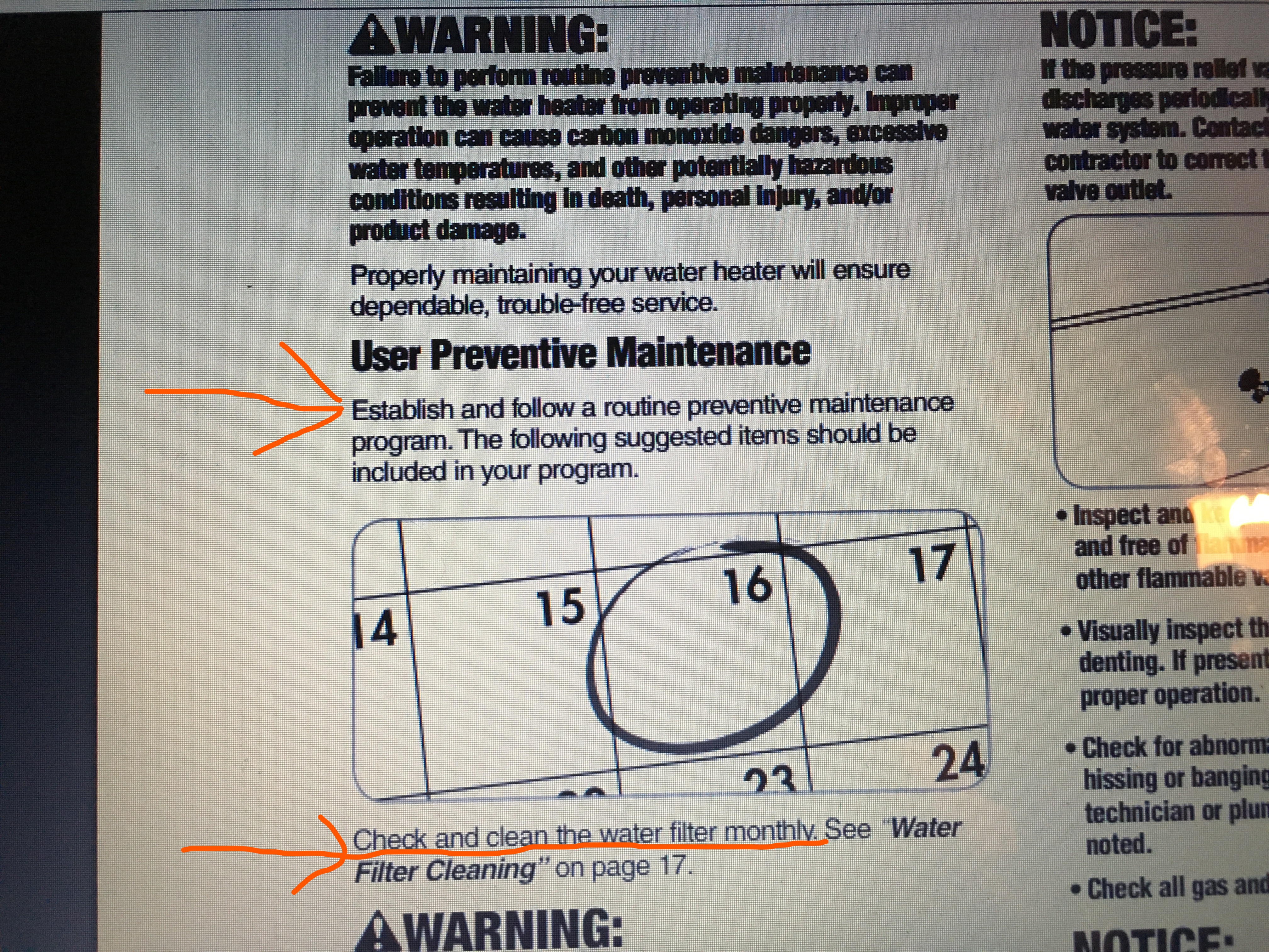

More like PG, theres a lot worst language at a shipyard, but the video was kinda funny but is it true or true-ish? One thing is true and that running out of water deal, what the heck are we taking 15 showers at once or what and who needs a hour shower in hot water, that sounds like jacuzzi bathing to me. Mine is on a 4 hour timer in the evening, so I take a shower at night.
This ONE water filter maintenance thing on the Rheem already bothers me and I haven't even bought it yet and it's on a monthly schedule, good grief dont they know I already have enough shif to do.
   / New hot water heater options, Tankless vs Tank... Electric vs Propane. #34
Have to wonder. How nasty a water source necessitates cleaning your water filter every month? Overkill? Way to void warranty as most wouldn’t do it?
