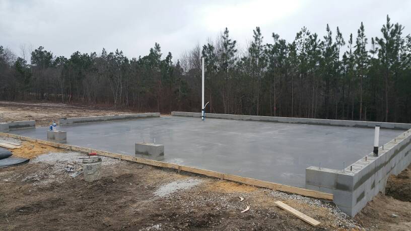

They poured both garages today. Only got a picture of the detached garage because they were still working on the other one...
