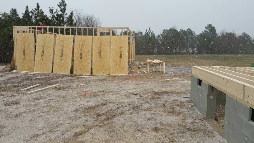

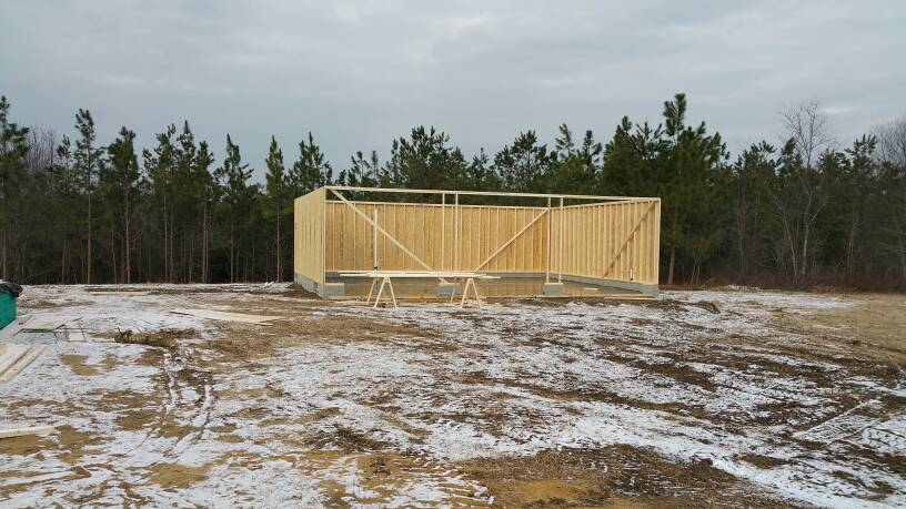

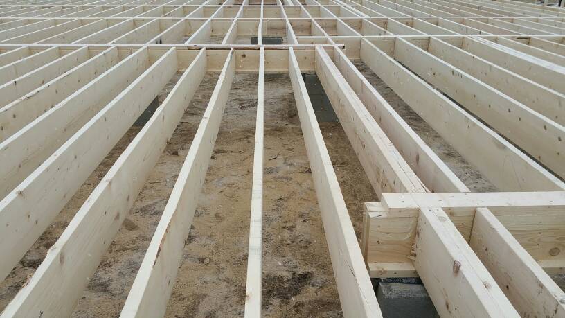

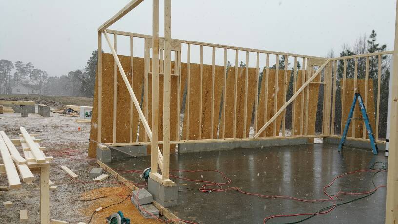

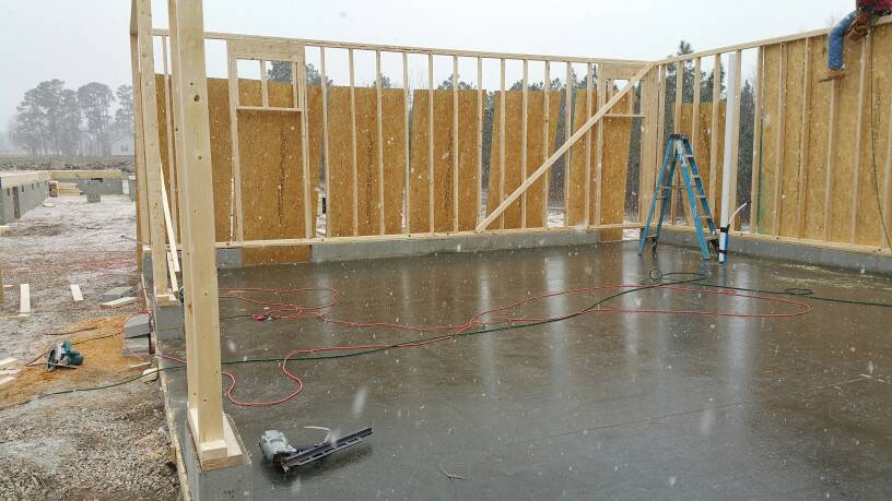

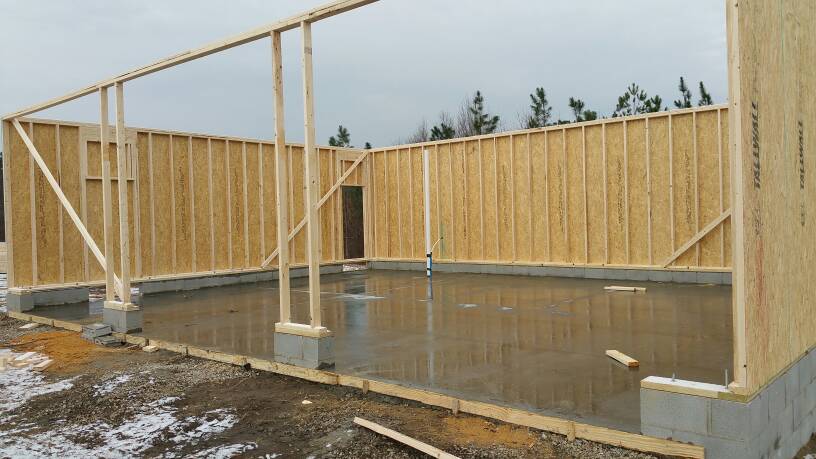

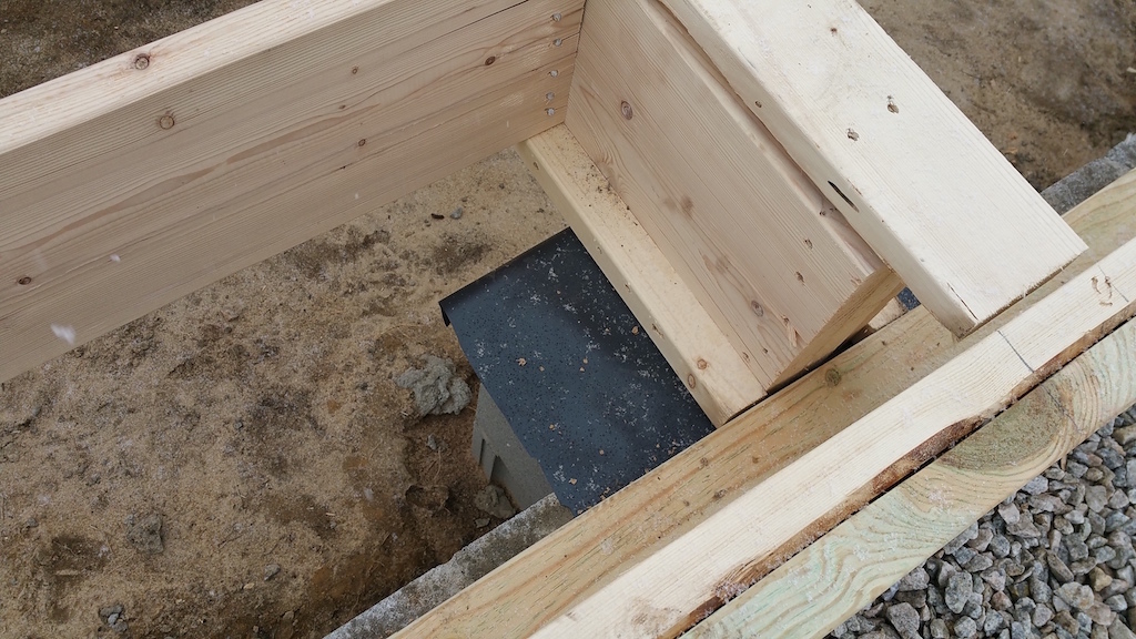

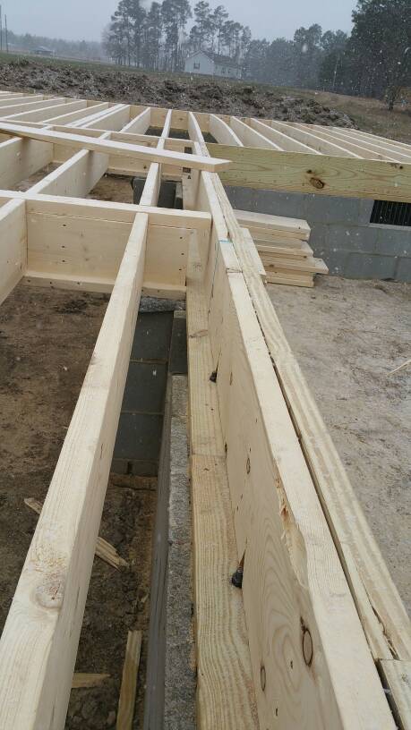

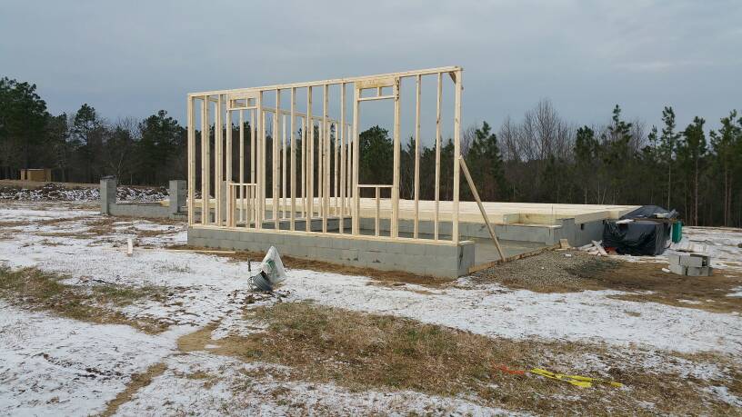

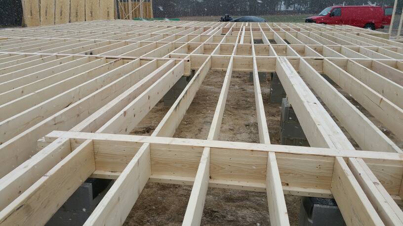

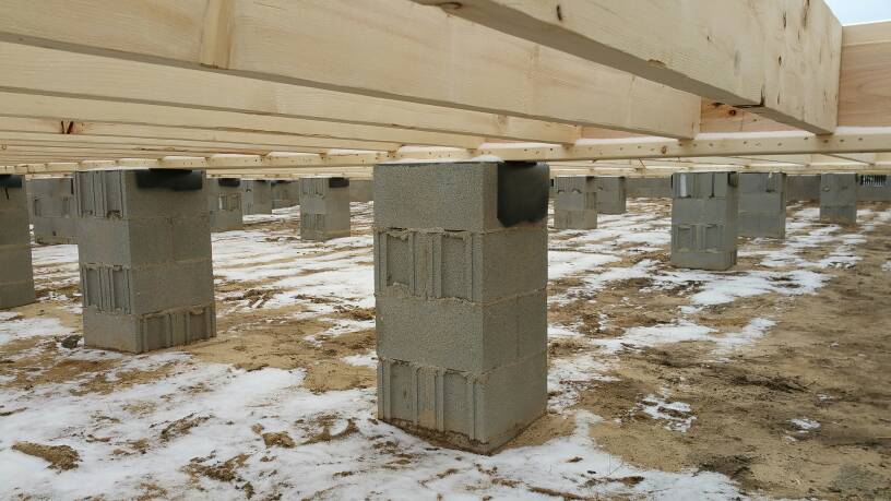

I appreciate all of the comments and advice. Please keep the suggestions coming. I need to talk to the builder about the crawl space. While I would love a skim coat - it just isnt going to be in the budget. At a minimum - there should be a vapor barrier laid down. The concrete that they poured in both garages looks good. Its quite a bit darker looking that what i'm used to seeing. I wonder if it 's because it was so cold when it was poured?? They kept blankets on the concrete for about two days after it was poured. Hopefully the sub 20 degree weather didn't have too much of an impact on the curing.
The framers are out in the snow today framing. Here are some updated pictures. I tried to take some pictures that how how they framed the floor, but its somewhat hard to get good angles.....

So - something that I didn't put too much thought into before framing started......
Some of the tract builders are framing with 2x6 dimensional lumber. I **assumed** that it must be the standard for our area - after all - why would a tract builder use anything above the bare minimum???? Well - looks like the are framing the house with 2x4's :confused:
It's my fault because I didnt ask the builder. A search on google leads me to believe that there are multiple different theories on what is better.
What is the norm in your areas?? Any thoughts on 2x4 vs. 2x6?
