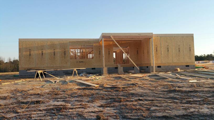

There is a header - you can't see it in the photo. Also - the flooring is tounge and groove osb and each piece is pretty tight.
Exciting times for sure! Thank Eddie for being a valuable resource. Just finishing reading this thread and enjoying following along now. Didn't look and especially examine all the pics you posted but I'm still puzzled on the header or lack thereof in the picture of what appears to be a sliding glass door opening. That is wrong in my book. You say it is there but you just can't see it. :confused3:
I misunderstood what Eddie was asking. Looks like the header is definately missing. That's interesting because they have headers over the other windows and doors. That sliding patio door opens up to a covered patio. Do all doors and windows require headers?

This is a view looking from the other side..... uploadfromtaptalk1456063444428.jpg
