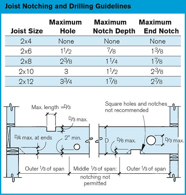

I have seen joists attached like they did, with a 2x2 under and joist notched. I don't like it, I'd use hangers myself In the end, the hangers are only held onto the beam with a few nails also, so is it much different?

Joist hangers have nails specially designed to support the load of the joist. My concern is that nails and screws are not structural and not designed to carry a load of any kind. Nails ans screws are designed to hold material in place. There is a HUGE difference!!!!
That 2x2 is acting as a Ledger Board just like done when people build a deck off of their house. A Ledger Board should be bolted to the beam, or the lag screwed. The spacing and number of bolts or screws is very important since it is supporting so much weight. Also the size of the Ledger Board is important because of all the weigh resting on it.
I fail to see where that 2x2 is strong enough to support much of a load, or that it is attached with bolts or lags in the appropriate manner.
The more I think about it, the more I don't like it.

Per Rules for Drilling and Notching Deck Framing - Professional Deck Builder Magazine and https://engineering.purdue.edu/~jliu/courses/CE479/extras/Notching_&_Boring_Guide_A11.pdf a notch should be less than 1/4 of the height of the board:
