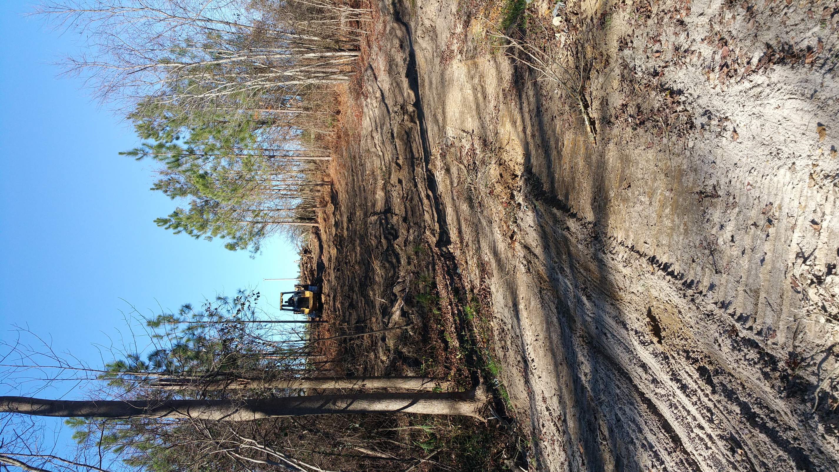

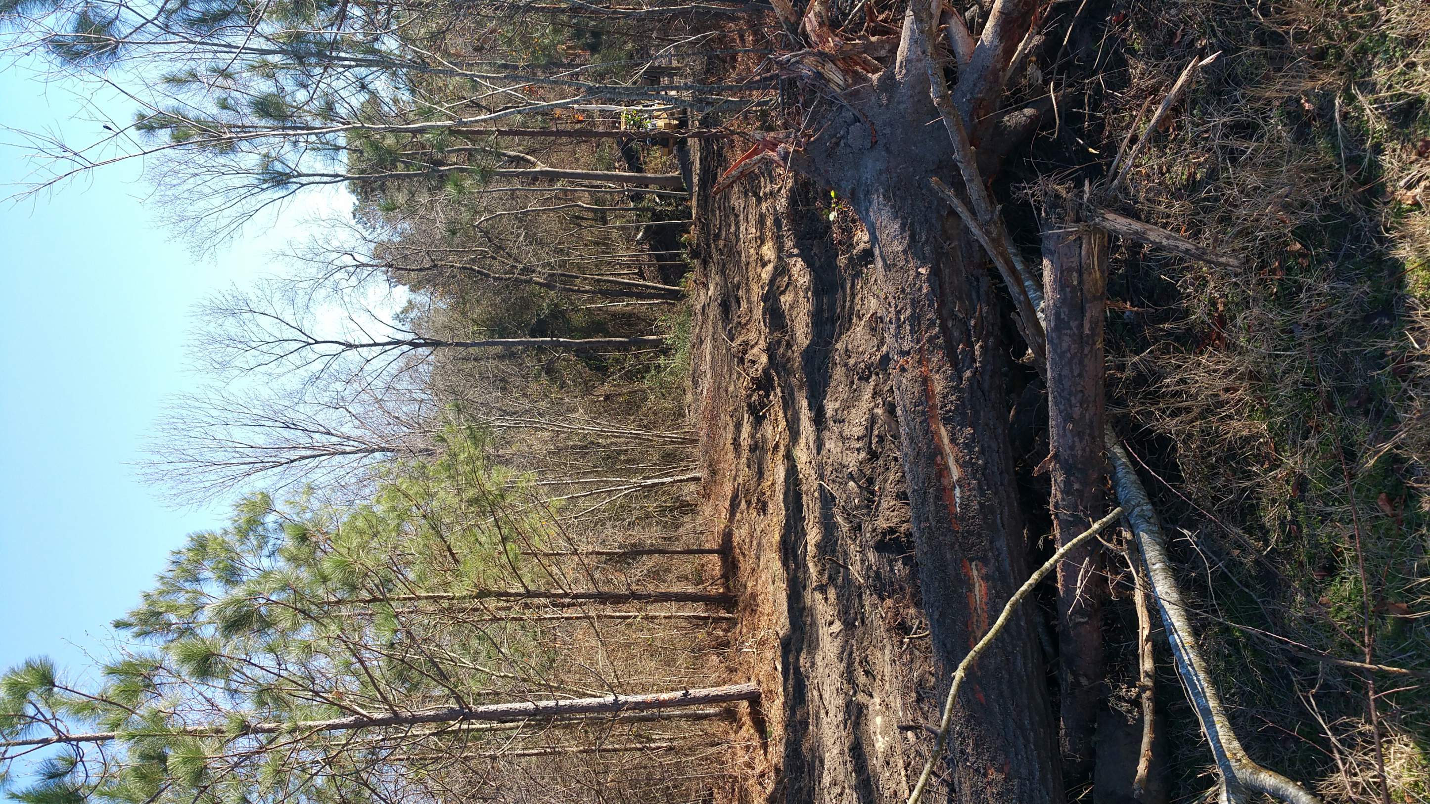

Today they started work on improving the 1300 foot road....
