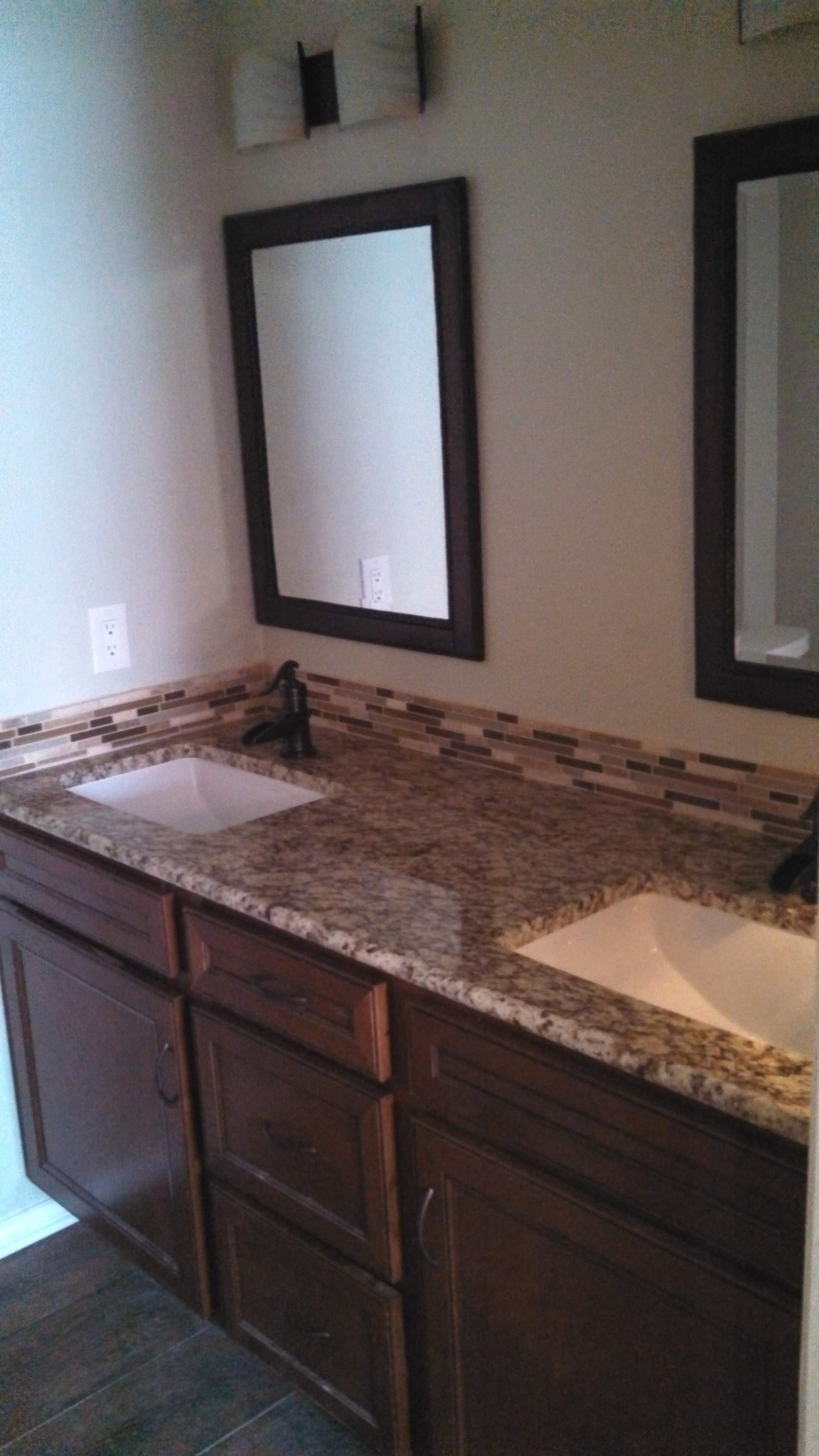

This picture is from a bathroom that I did just before my parents house. It's about the same sized tile and beautiful looking, but it's surface is so rough that it's very hard to clean. My clients likes it because it was so "not slippery" when walking on it after taking a shower, but the little grooves on the surface trapped dirt that is impossible to get clean.
