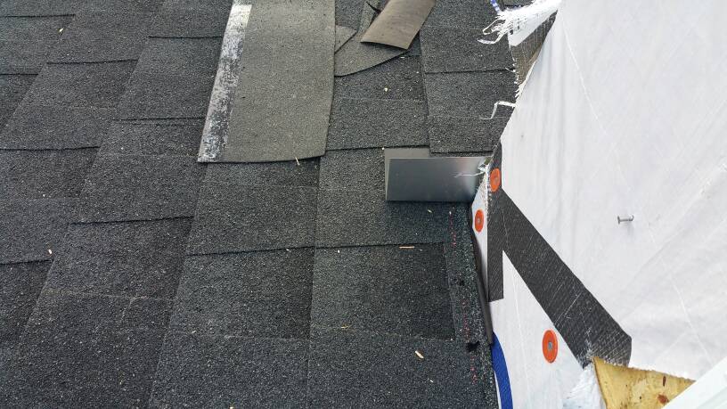

This is a link that shows several ways to properly install flashing to a wall. I do not see this in your pictures. You might also google "roof to wall flashing" and click on the images link. There are a lot of pictures showing how it should be done.

It looks to me like they used black step flashing. To paraphrase Aaron Rodgers, r-e-l-a-x ;)
And did you look at my link that shows numerous examples of how it should be done?

I did see the properly installed step flashing going up the sidewall. I'm not sure what your link on built up roofing membranes has to do with it though? They are obviously not finished but I'd be willing to bet they plan to flash under the window before they are done, heck if they want to get fancy they might even build a sill pan out of ice and water shield to tie all together.
How would you go about installing the lower flashing AFTER already installing the side flashing?
