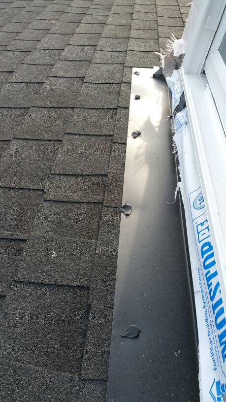

How would you go about installing the lower flashing AFTER already installing the side flashing?
I'd bend a piece of metal to fit, wrap it around the corners and slide it under the step flashing. Then cut and wrap the step flashing they left long to go around the corner and onto top of the lower flashing. Then I'd run grace on top of the flashing up to the window rough opening. I'd also slice the house wrap and run the the grace under it on either side of the window. I also like to build up a sill pan out of a piece of beveled siding and grace, seal everything up with tape and call it good for 30 years.
   / New House Build in the Country!!! #363
Lets see what happens. I don't see anything wrong with your plan, I just wonder if you would have done it in the order we are hoping these guys are doing it? To me, they should have done your step first, then the sides. The way they are doing it, if they do it like you suggest, makes it harder. From what I've seen in the pictures, when they skip something, like blocking the floor joists, they are done and don't plan on doing it.
   / New House Build in the Country!!! #364
I can see leaving it to be done later. I wouldn't want a junior guy on the crew stopping to bend up flashing... Probably do a half azz job and it breaks his momentum running shingles.
I'd want one experienced person handling the flashing details. If the same crew is going to do the windows and siding they might even wait to bend the flashing when they have their brake out anyways.

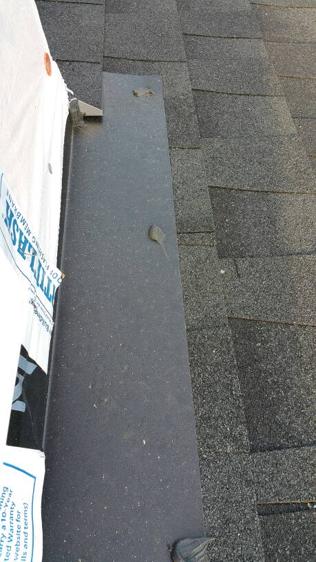

For those still wondering - here is what the dormer flashing looks like now....
   / New House Build in the Country!!! #370
Good to see it there. :)
