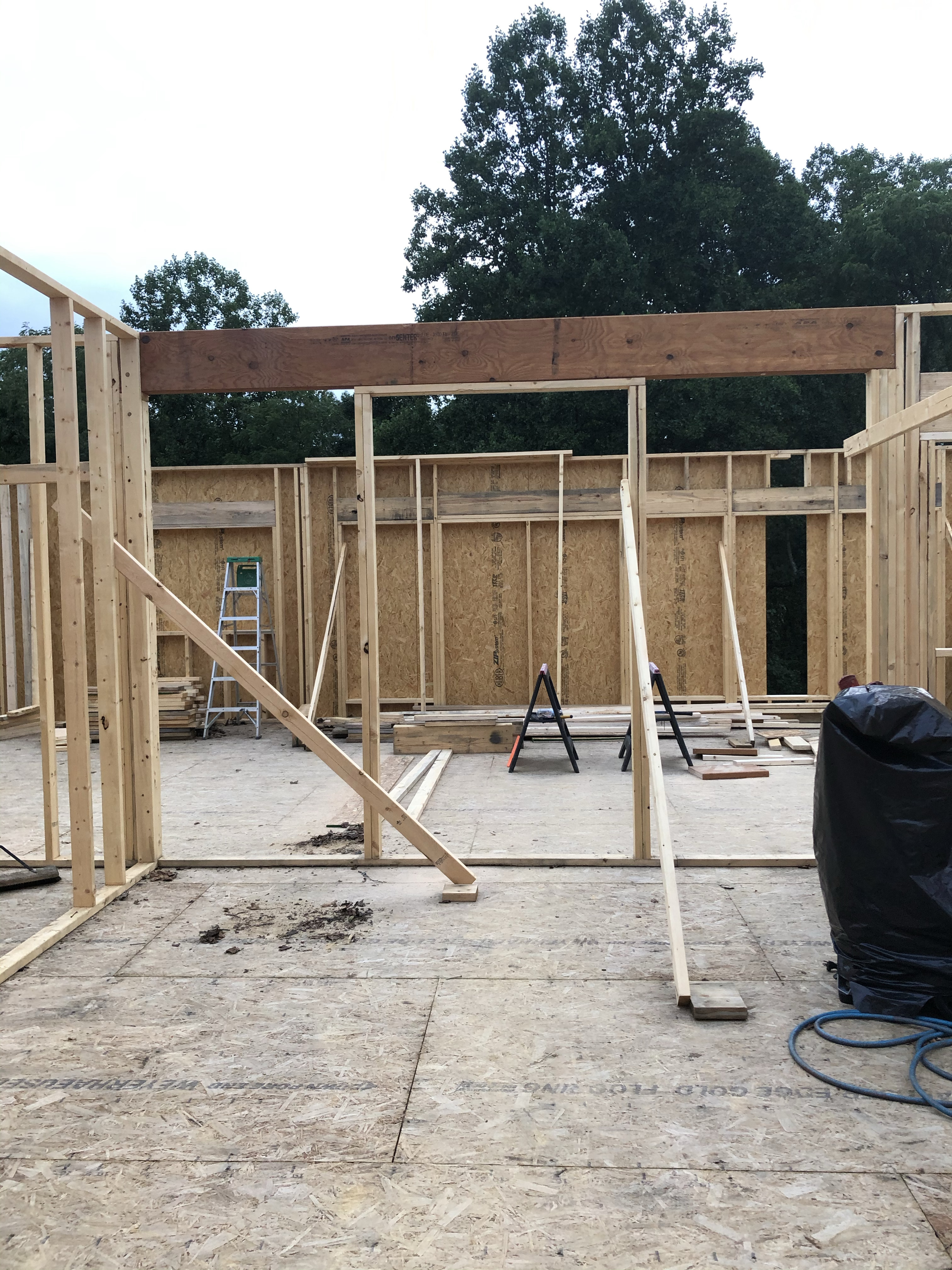

Didn’t get as much done as I had hoped I would this weekend, but made still made good progress. Interior walls are almost done, just need to install a few more headers, cripples and framing for a few more doors.
Here’s a shot of the foyer from the front door. I got the double LVL installed, this is the only weight bearing section of the interior framing. The space in the middle will be a closet on the foyer side and fire place on the other, with cased openings on both sides.

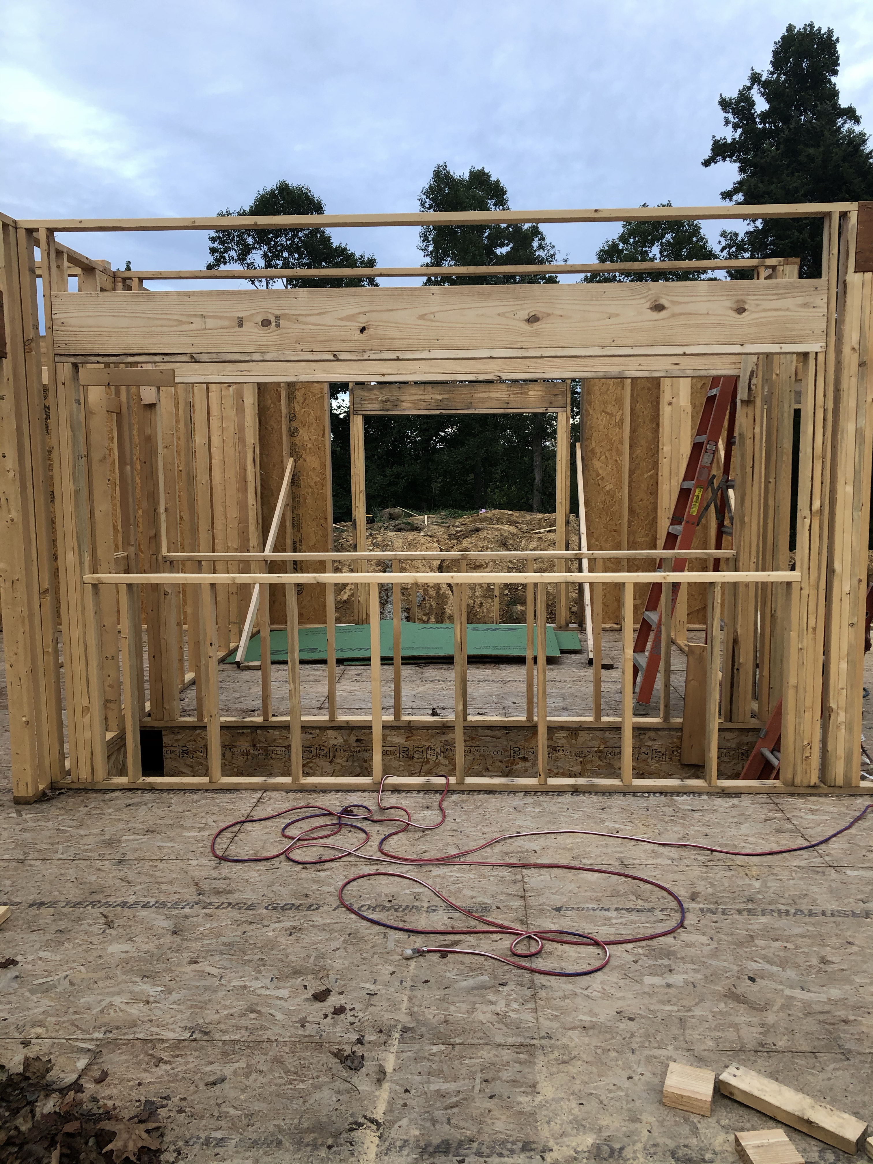

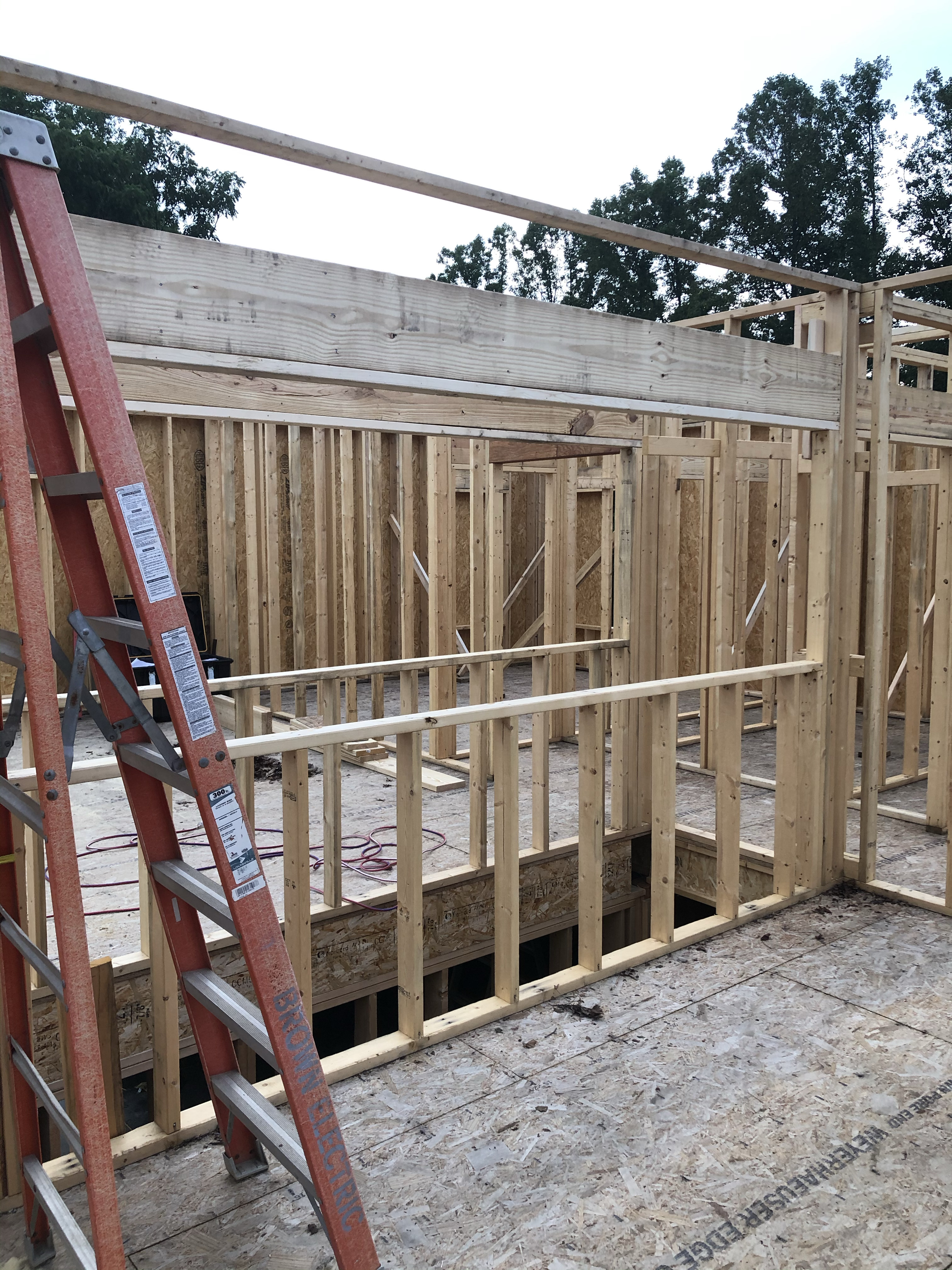

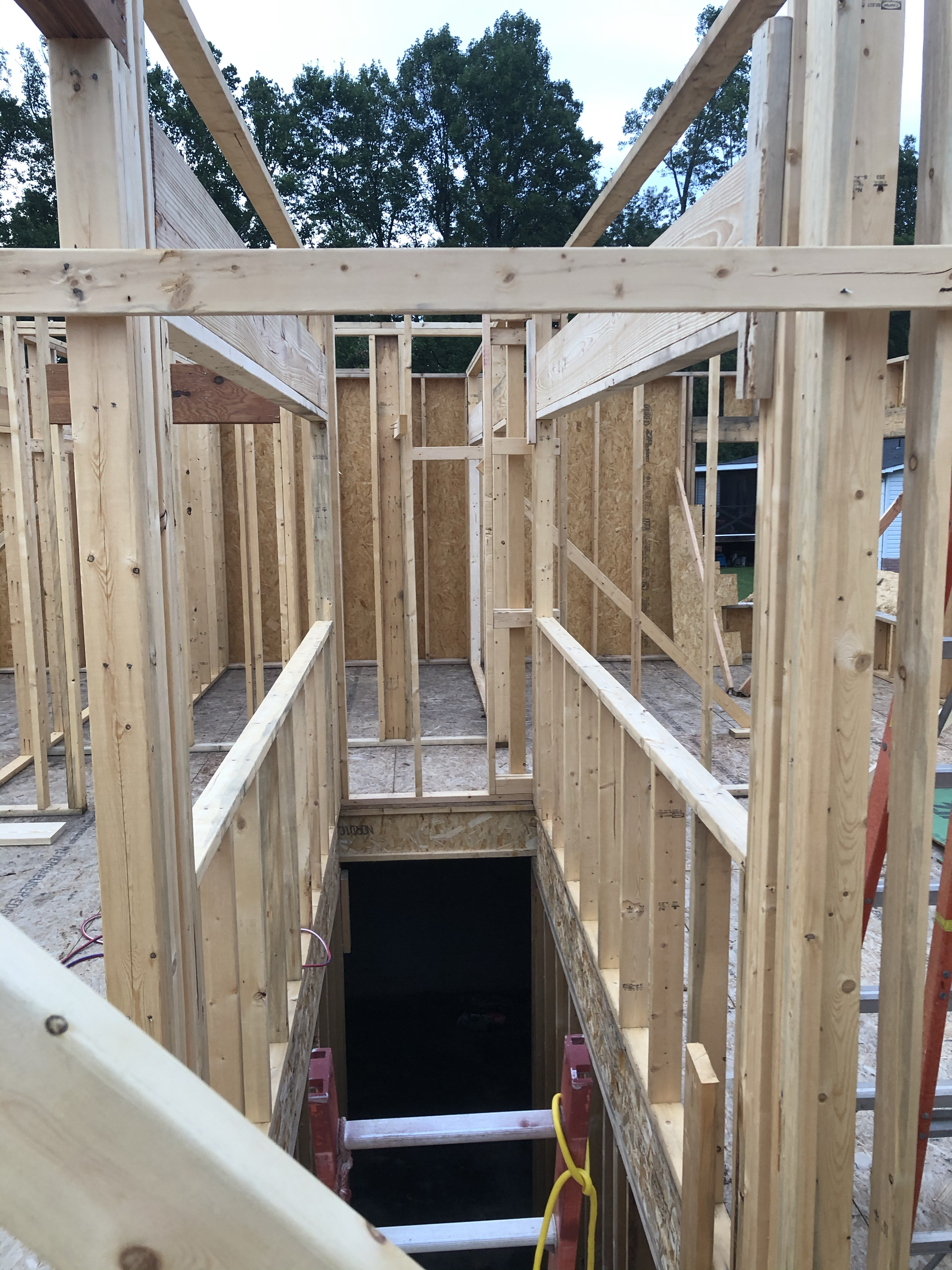

Here’s a few shots of the stairwell half walls. Wife didn’t want it completely walled off, so this is what we decided on. Those 2x12x12 headers were a beast and I was fortunate enough to have my brother in law and father in law to help with them. Stairwell separates the dining room and living room.
