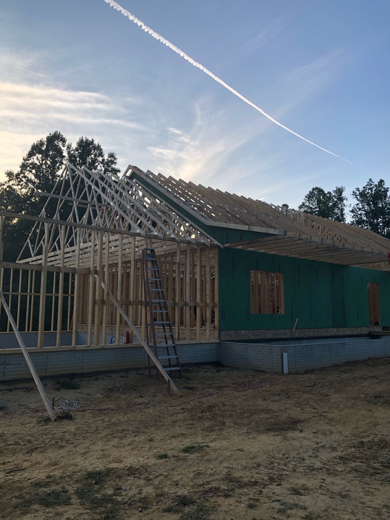

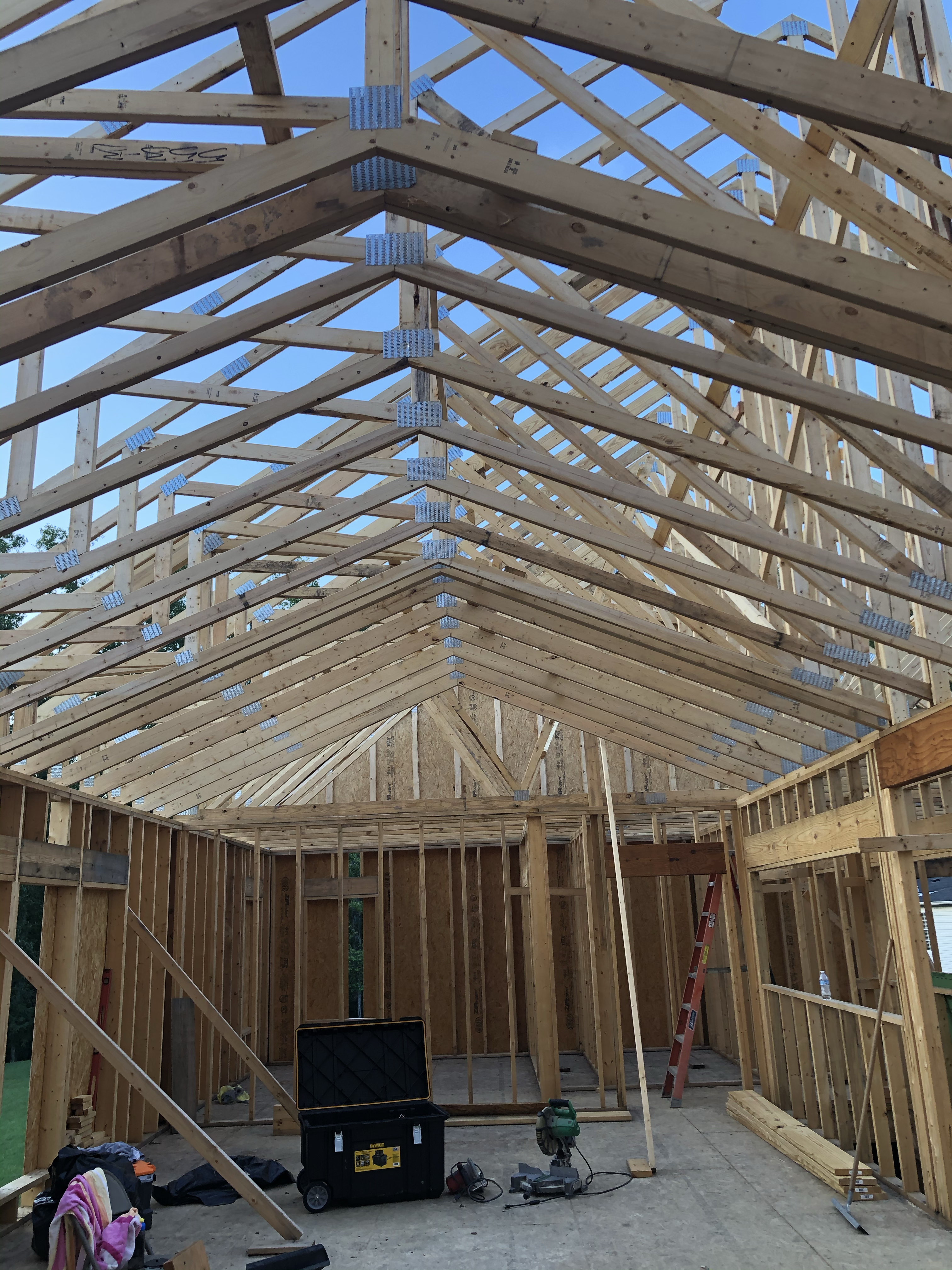

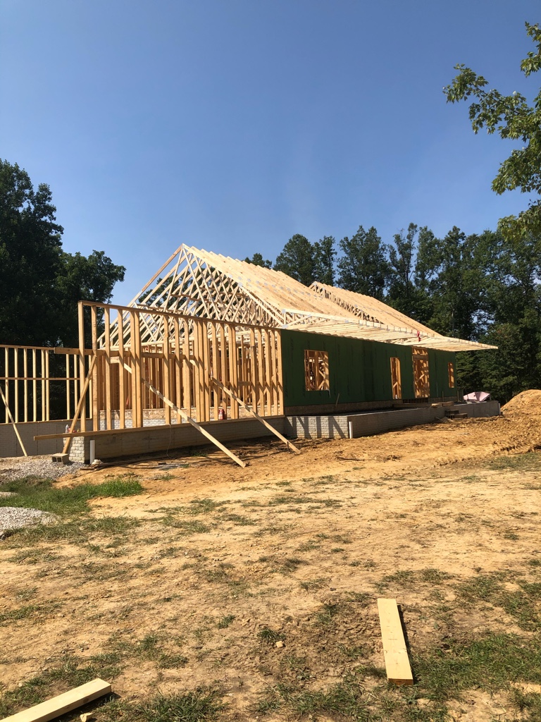

Trusses look very similar to mine. Mine were 36' + 8' over the porch. Are you setting some posts for support? Or complete floating them. I have 4 posts over 36 feet of porch width. Thanks for the posts. Looking good. Jon
The foyer has a former that is open to the inside, the trusses behind the foyer sit on a beam and that is the only weight betting wall, the rest clear span.

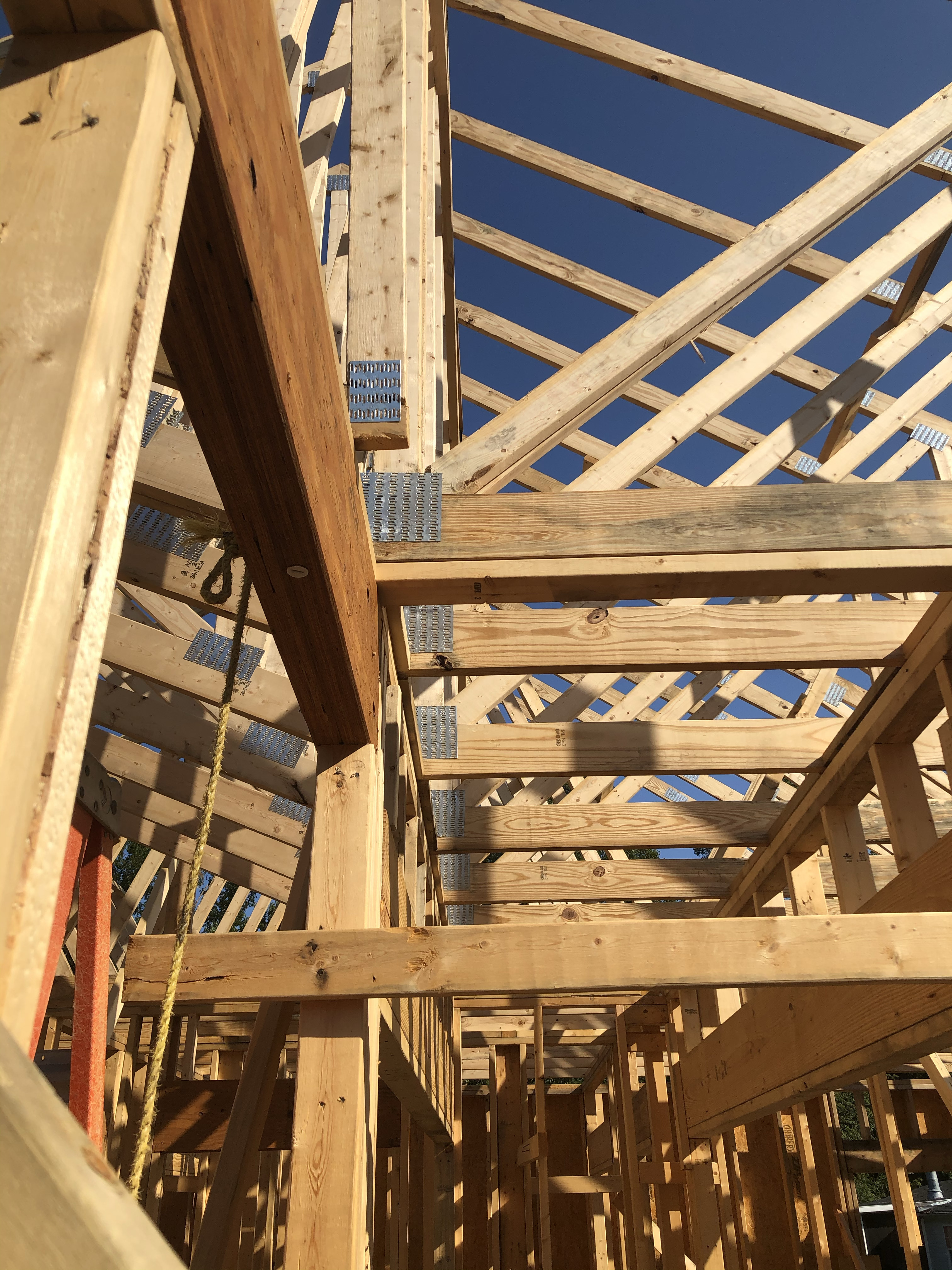

We got the rest of the house trusses set, except the ones behind the foyer. After setting the first one, we found they were built 3” to long and went past the beam, this left no flat portion of the truss on the weight betting beam. Truss company took their own measurements, so this is on them and it’s going to be an awkward conversation when I let them know they have until this Friday to correct the issue. I have to finish the trusses next week so the roof can be sheathed and shingled.

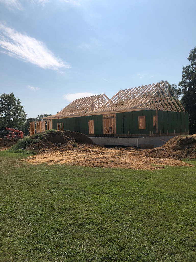

All house trusses are up except the ends, I’ll get those ready for next weekend. Garage should be easy after doing the house. Thank god for good help, I couldn’t have done this part without it, that’s for certain.

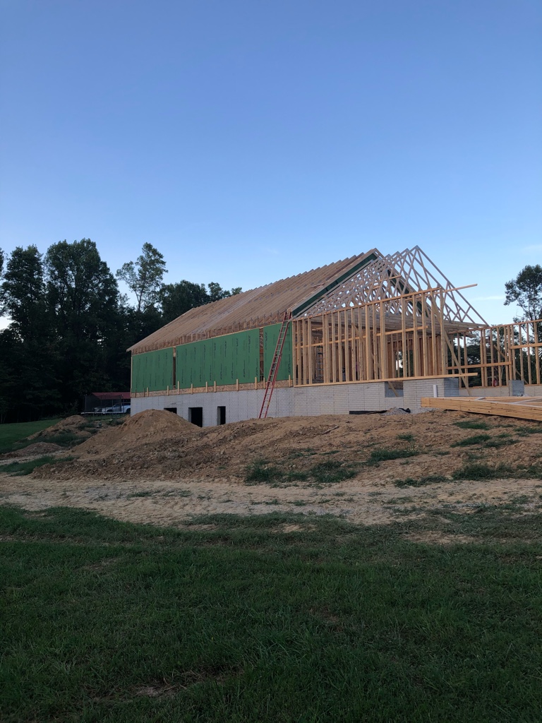

View attachment 668973View attachment 668972
Will be interested to hear how the truss company intends to resolve the 3" too long issue.

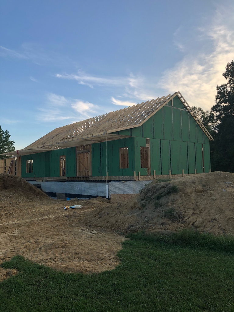

I agree, they took their own measurements, so it’s definitely on them. I’m waiting on a call back now to see what they plan to do. I have told them what I need them to do to make this right and I don’t plan on backing down. This issue cost me time, and money, so they need to make it right.
Here is a shot of the error. Technically, all of the trusses were too long, but at this beam is the only place it makes a difference.

I mistakenly said all trusses were too long, actually the trusses are the correct length overall, they are just long on the inside wall of the cathedral portion. It’s not a problem anywhere except on the short trusses that sit on the beam. The rest are clear span and if it creates a difference on the peak of the vaulted ceiling, it’s not an issue since they are all the same. I suppose the peak my not be 100% centered due to the error but I don’t believe it’s off enough to be noticed.

Been a long few days dealing with the truss issue. Resolution is not what I had hoped. Truss company tried to put the blame on me. Of course, it wasn’t the fault of the guy who came out and took measurements. Basically, they are too busy with current orders to waste their time correcting their mistake on trusses when the check has already cleared. Very disappointing and I’ll certainly not do business with them again. After some unpleasant exchange, they did agree to a refund for those trusses. That’s something I suppose.
I had a contractor look at them this evening and we worked out a fix, so hopefully that happens tomorrow and I can move forward.

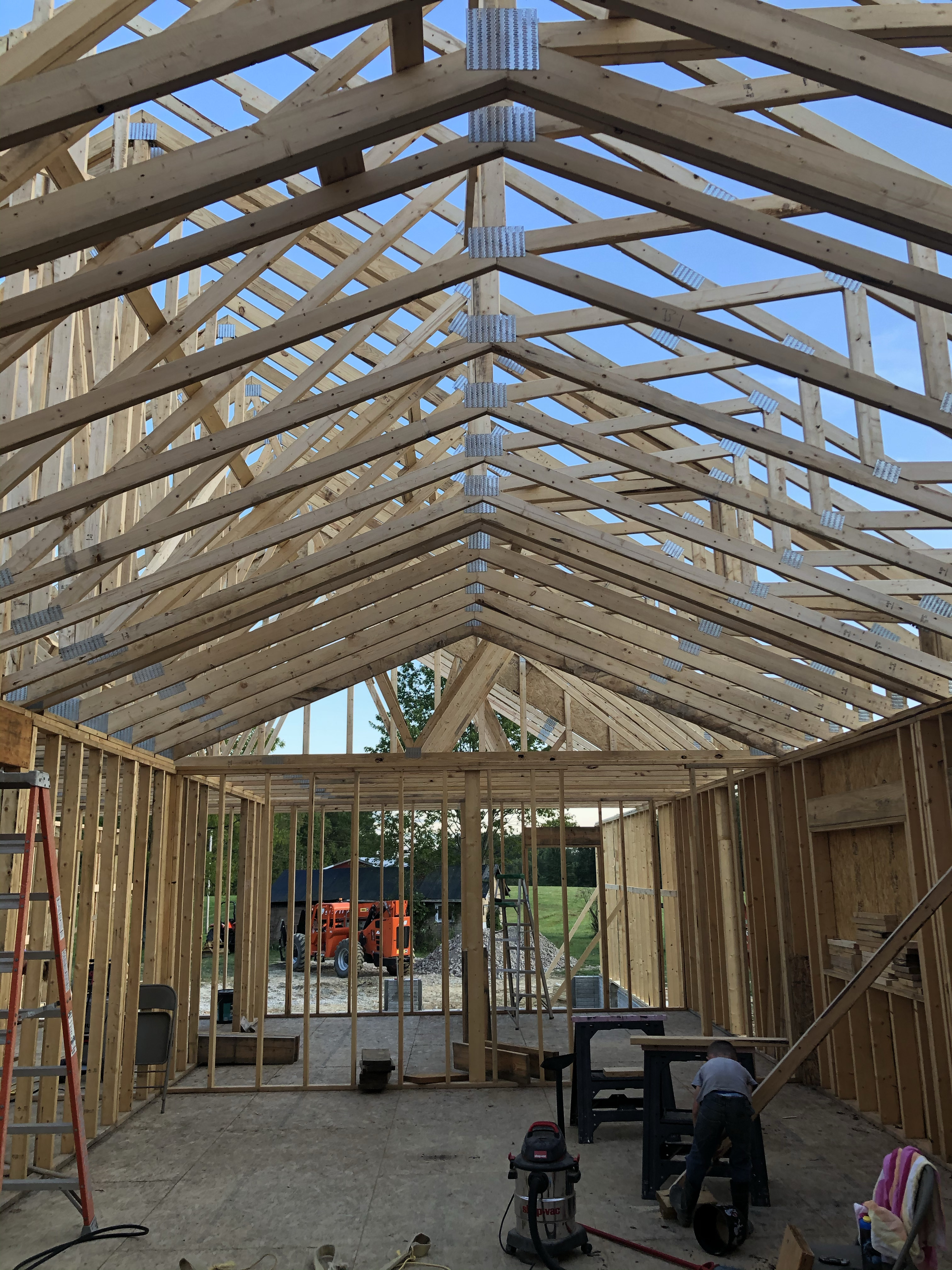

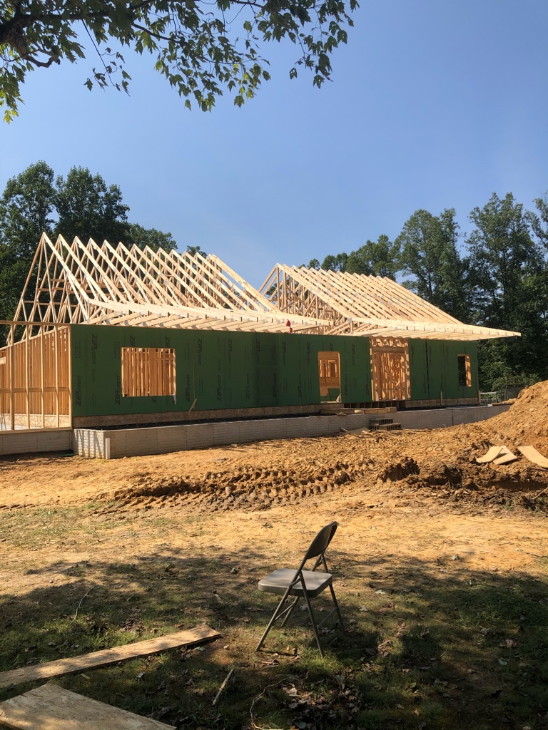

Got a lot done the last couple days, but not as much as hoped.
I fixed the incorrect trusses myself, they got installed today along with both house ends and several garage trusses. Some of my help wasn’t able to make it, so it was a bit slower with only 3 people, due to a lot of up and down.
It is likely to rain tomorrow, but if there is a break in it, I’ll attempt to get the rest of the garage done. If not, I’ll just have to rent a machine again next weekend.
Here is some after pictures.
Vault ceiling, kitchen looking into living room
Living room back into kitchen.
Lot of work, but i like the way it’s turning out so far.
