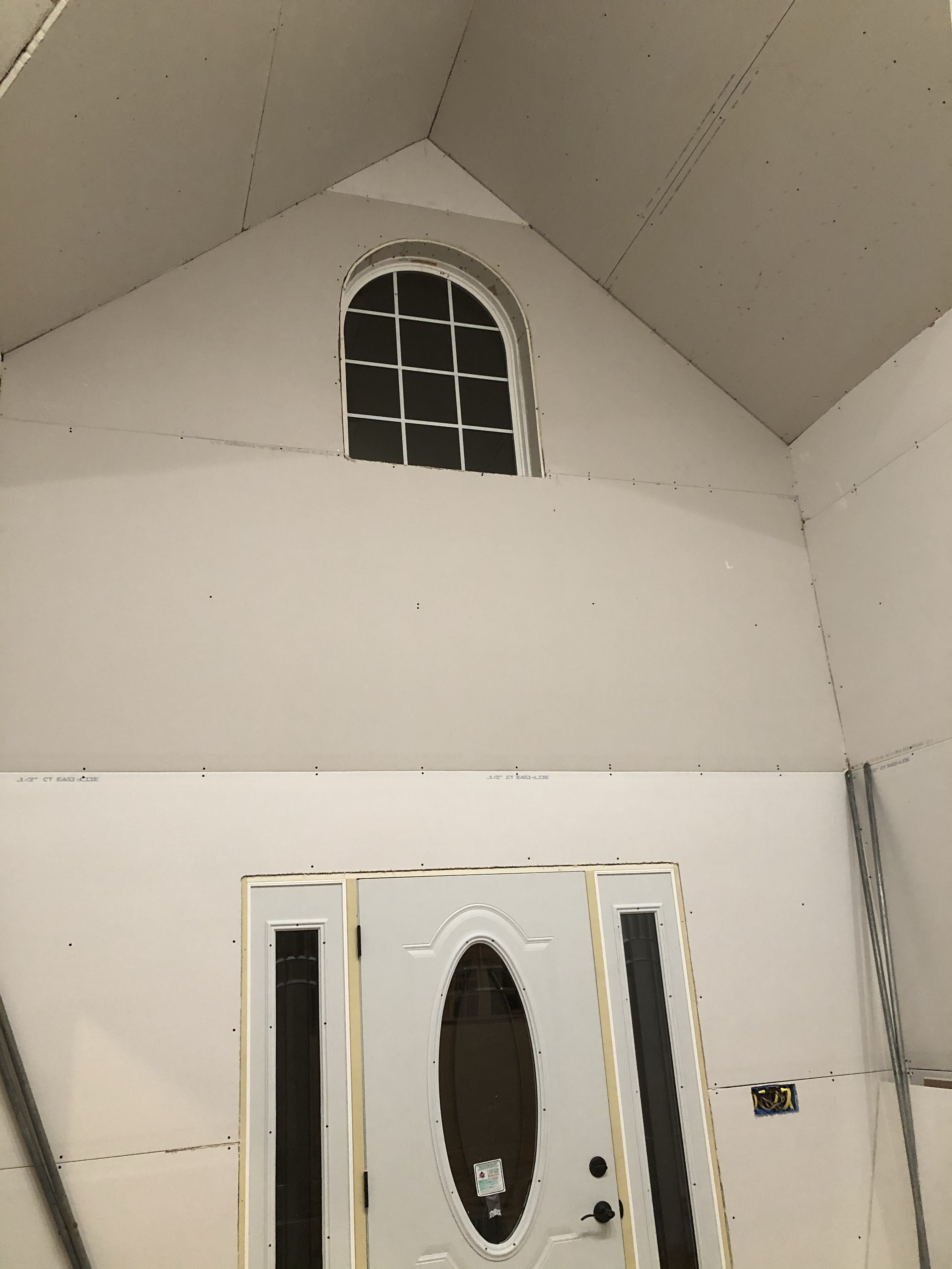

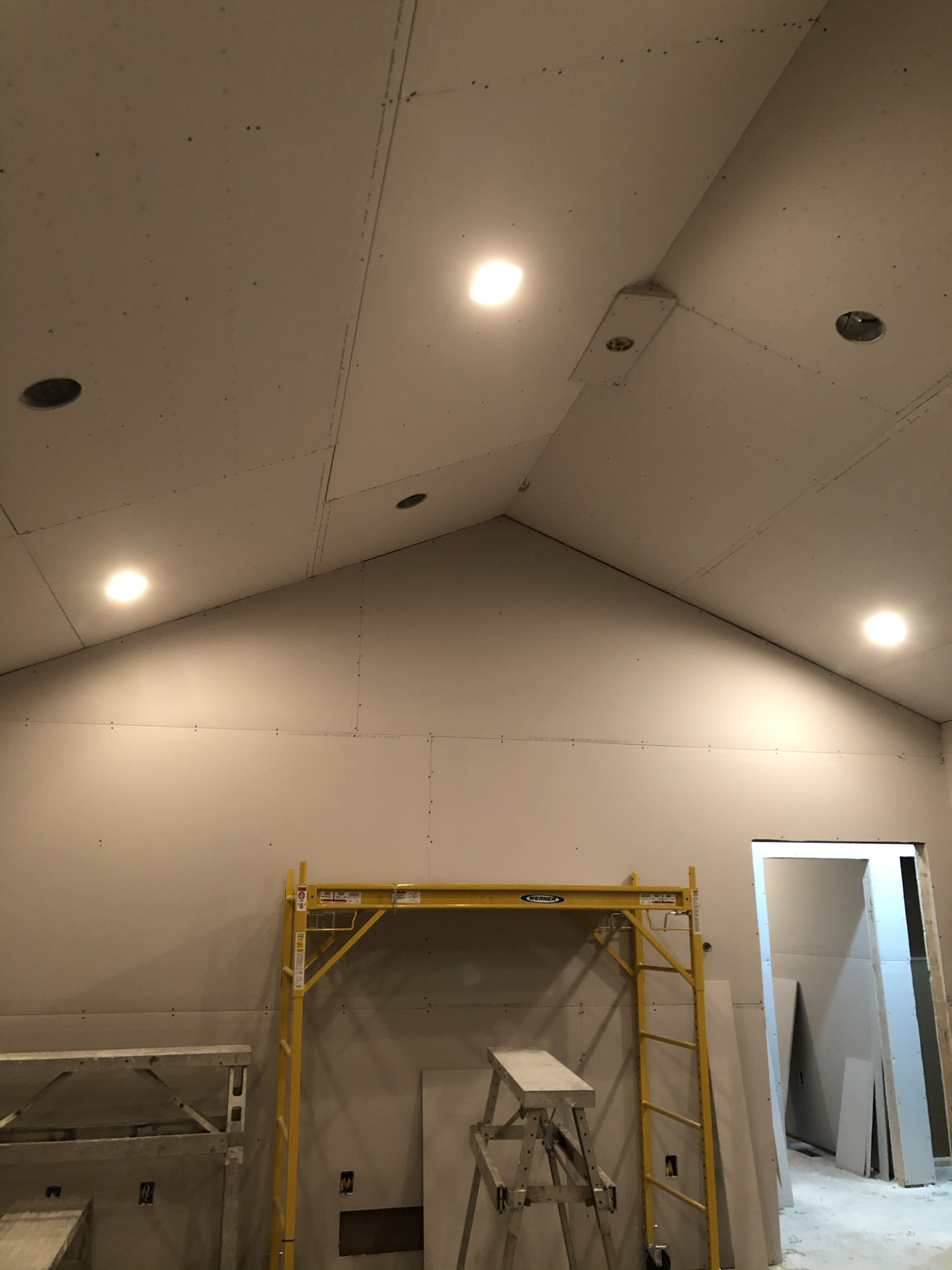

Good to see you figured out how to post pictures. The sheetrock looks nice, just be sure that they finish screwing it all in before you pay them. I've had to do this myself when I didn't check every room and accepted their word that it was done.

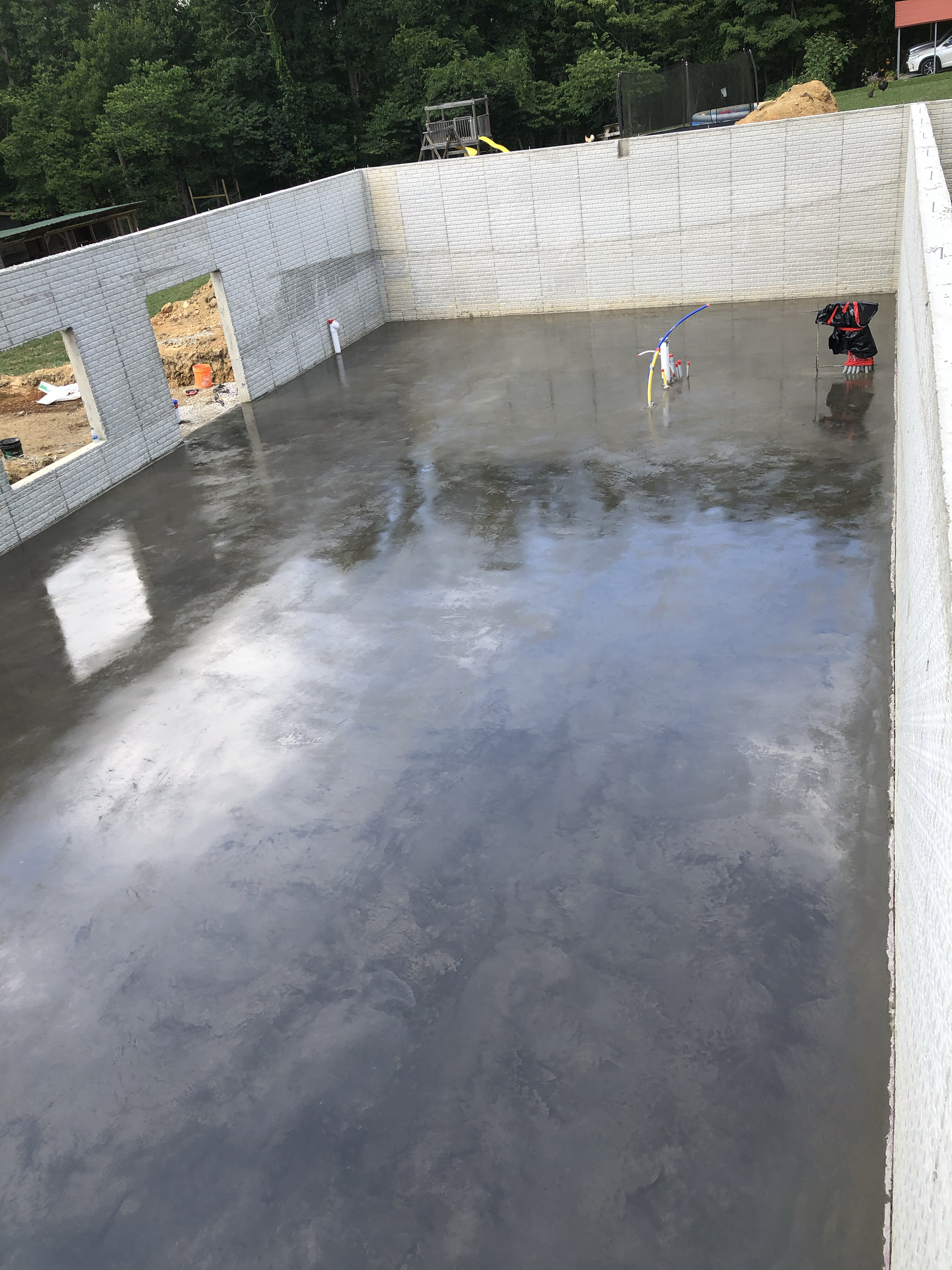

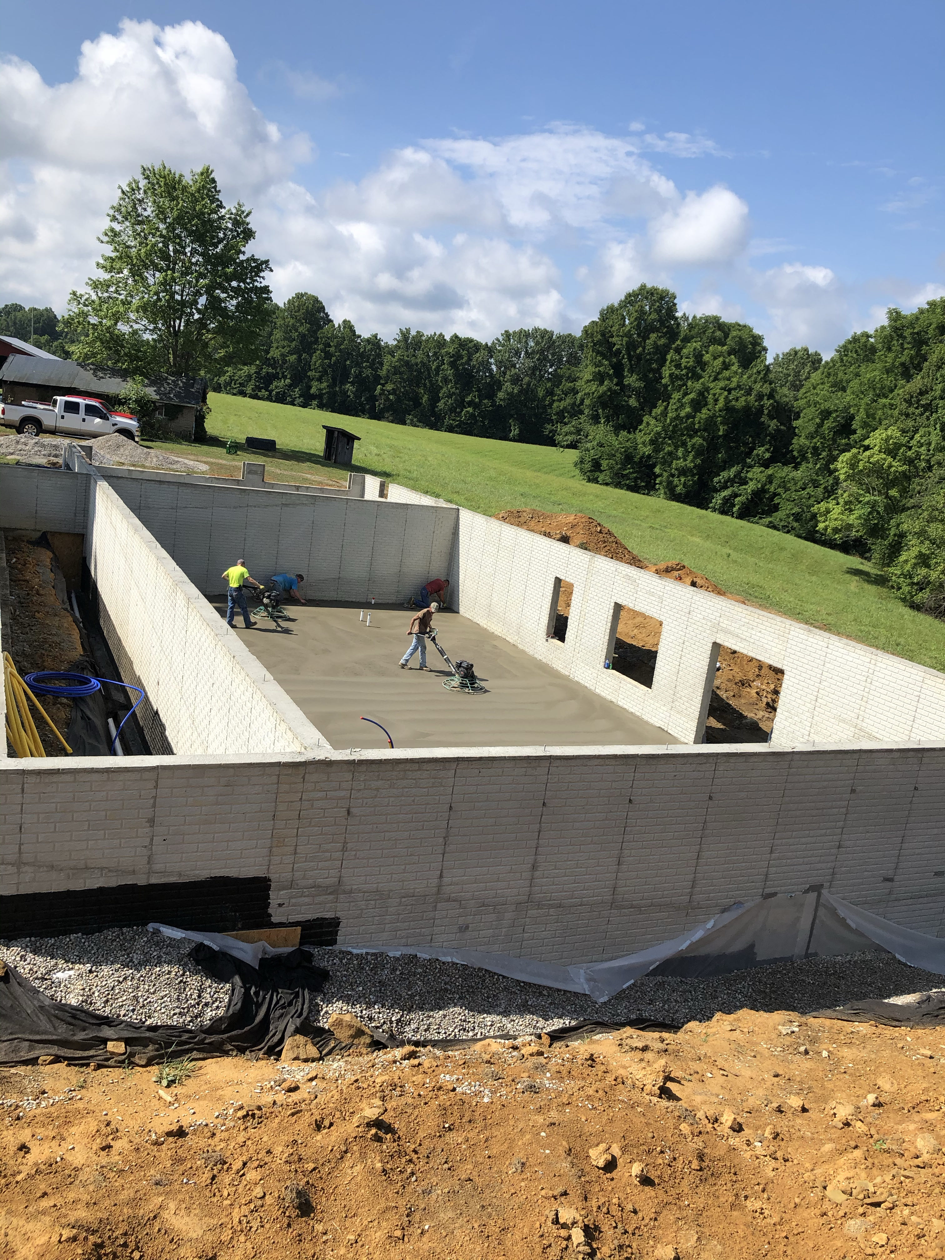

Hello All,
I have been planning a house build for a number of years and it is finally underway. We got a late start due to COVID-19, but the poured wall foundation was poured in late June. I am building the house myself, subbing out the pieces that I cannot/don't want to do. So far it has been mostly myself, my wife, my father in law, and one good friend who helps out when he is not traveling for work, so progress can be slow at times. I have been trying to get this thread started for a while, but work has been continuous until well after dark most days.
So far we have managed to get the basement water proofed, drain lines in, most of the gravel backfill done, concrete floor poured in the basement and we are now working on framing walls. Still have a few interior walls and a couple of garage walls to frame. Not all interior doors are completely framed in yet either. We have found it much easier to lift walls by ourselves if the headers are not put in until after the wall is in place. Trusses are do onsite in about 1.5-2 weeks, so hope to be ready for them as soon as they arrive. I will have some hired help to set the trusses and will also hire a crane to lift them in place. Currently talking to a contractor about getting them to sheath and shingle the roof, as those two tasks would take me forever to complete, so hoping that works out.
The house is one story over a full basement with attached garage. Front and rear porches will span the full length of the house, with the front being concrete and the back being treated frame with composite decking. We put PEX in the basement concrete floor for radiant heat.
Main floor is about 2200 square feet. Looked small on paper, but it definitely is not small now that it is going up! At this point, the only portions hired out have been the excavation, the poured walls, and the basement concrete floor.

I will add some progress pictures and try to put the blueprints up so you all can see what we will end up with. For some reason, the TBN website is not allowing me to add pictures through the manage attachments function, so I will have to work on that later. Below are the only two pictures that I can get to upload at the moment, maybe I will have better luck from the tapatalk app then my computer.
Is that ICF? If so, how much is it running you?

Looks great! Warms my heart to see drywall work being done by someone who's not me!
Walls are poured concrete, not ICF. I like the idea of ICF, but it isn’t common around here, so it’s would have been very expensive.
Yeah, no way I’d want to be hanging 5/8 on that ceiling. After doing all the other work, I’m not sure I’d be up to even if I wanted to do it.
My crew is 2 guys, the main one being probably in his mid 60’s. They are not the fastest hangers, but came highly recommended and at a very reasonable cost.
They finished hanging today and will start taping tomorrow. They should be complete first of next week.
