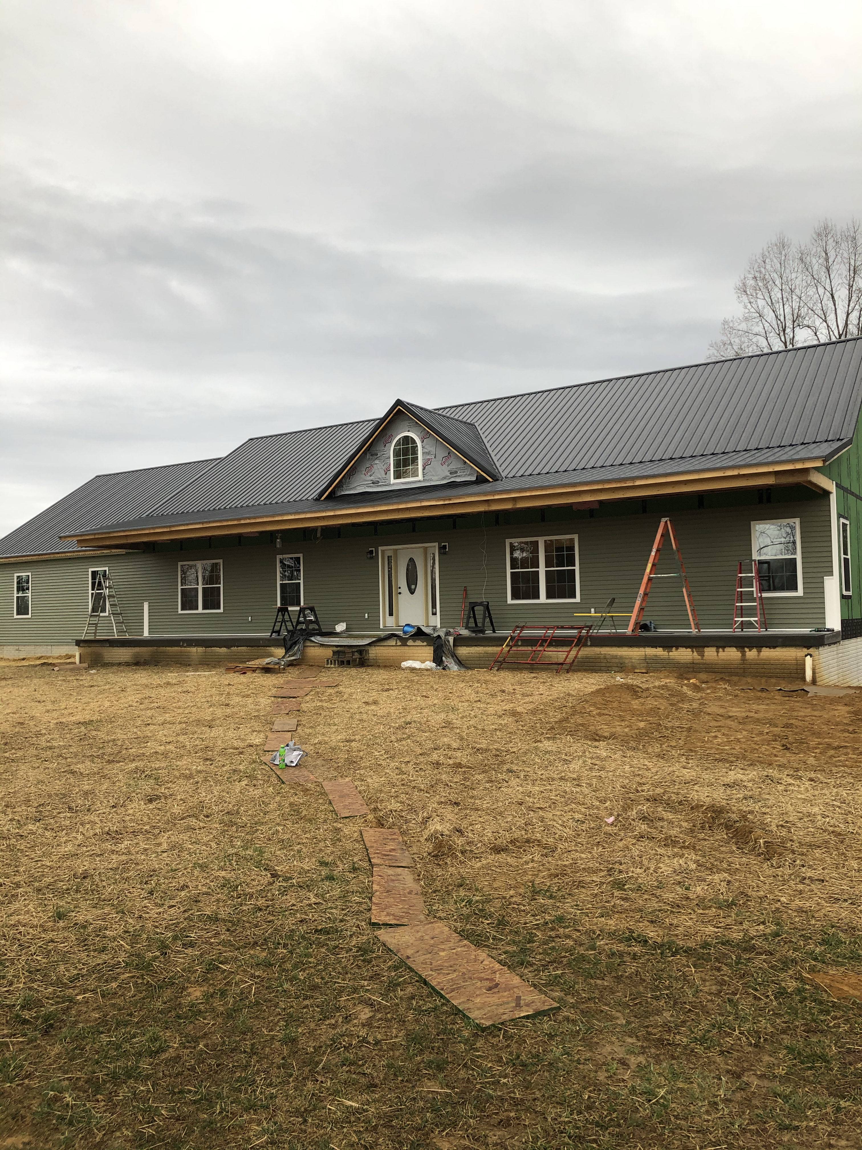

Downloaded a photo compression app, let’s see if it works.
Picture shows progress on the front of the house. Ignore my mess, had not cleaned everything up for the day.

Front siding looks great. Question, how wide is your porch? Any posts needed to support roof overhang? Jon
