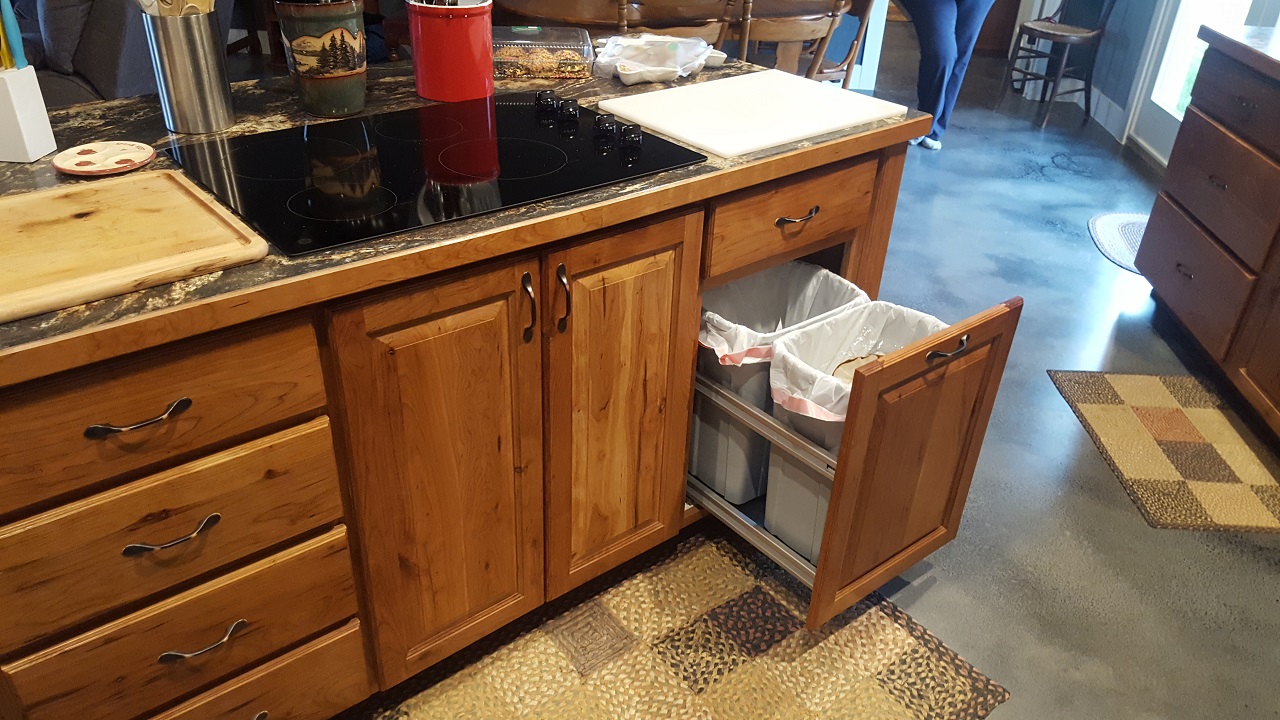

A pull out double trash container. This was a huge item of contention.... When Karrie installed the trash container he put if behind a swinging door. Open the door and then take hold of the trash container and pull them out. Terry derailed (rightfully so). She gave Karrie the "kill" look and said "I am NOT putting my hand in the trash container to pull them out!!!" I jumped in supporting her and said the trash container pullout is designed to fasten to a cabinet front. Pull out the front and the trash container comes with it. Karrie said "well I've never installed them that way". I said "this can be your first then". He rebuilt it.

That's the only way I've ever seen them (as in your pic). We have two in our kitchen and I know various other folks with them. It would be inconvenient having to open a door and then pull out cans.
Sounds like your cabinet maker may do good work but is a bit difficult to deal with...

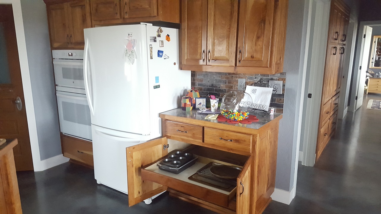

Somehow I screwed up and thumbnailed this pic into the previous post, sorry....
This cabinet makes room for the Refrigerator as well as a stacked Microwave/Oven. Good storage.
When Karrie started installing the Microwave/Oven he ran into a problem. The cabinetry was 1/2" too shallow. I had given him the Specifications sheet on the Ovens. He started making excuses saying the Ovens weren't built right and that he'd installed a lot of them with his cabinetry at this depth without problems. His helper (older gentleman, retire Aeronautical Engineer) picked up the paperwork on the ovens and started looking thru it. While Karrie was still making excuses John said "oh here it is right here Karrie" and showed him the specs which called for a cabinet 1/2" deeper than what he had built. So they pulled the Ovens out and cut the back out of the cabinet to get the needed 1/2". No big deal. Just shouldn't have happened.

Determining and meeting expectations can be challenging. The pull out trash drawer should have been specified as a pull out. I’ve seen them both ways.

We have a cabinet with sliding pan drawers like that. My wife hates them (I'm neutral). It's personal preference. She wants deep drawers so there's not two motions of opening the doors and then sliding the drawer out. Also the way they are built, the slider hardware goes right to the corner of the pan drawers. If you don't open the front doors all the way, the hardware gouges the inside of the doors. When we bought the house they were already heavily gouged up.

I don’t like opening 1 door to pull out a slide, I hate having to open 2. Have a drawer like that in my French door fridge.
