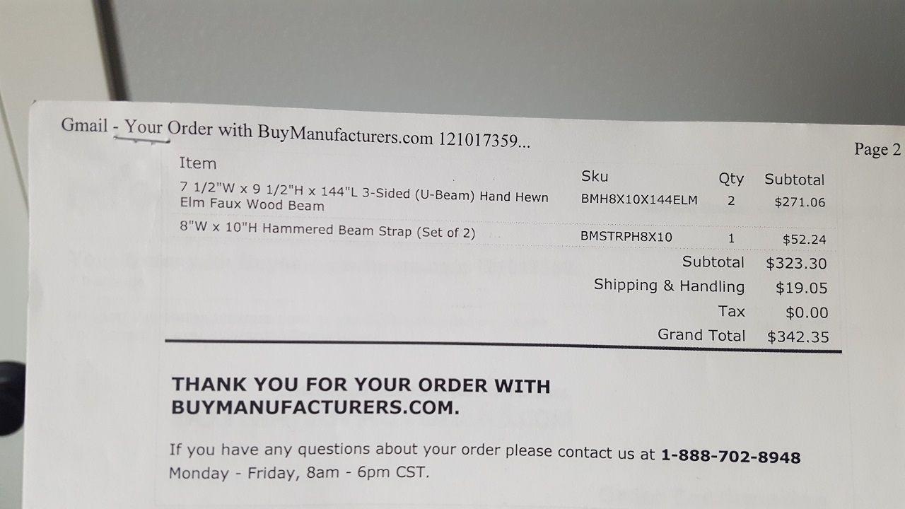

/ New House Build #174
Here ya go Rob.
Wholesale Millwork Products - Fypon, Spectis | BuyManufactur
They are Fypon beams.
Here's a pic of our invoice. I was off a few bucks on the price.
Awesome! Thanks for the info!
Since I'm bothering you, any info you have on that propane fired tankless radiant floor heater would be appreciated too. I have a pole barn with floor prepped for radiant. I just have to insulate (just!! Ha!) and get a boiler/heater. Propane is a good option for me.
Thanks again!
Rob
