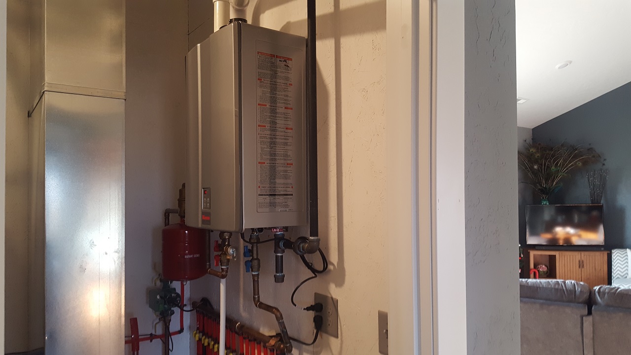

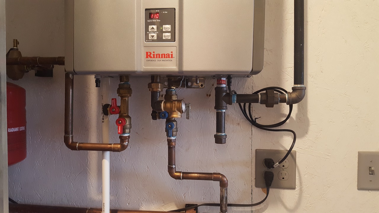

I was in my new shop thru last Winter and use Hydronic Radiant Floor heat in it as well as in the house. I use Rinnai Propane fired Tankless 199,000 btu Heaters. They are condensing heaters with efficiency rating somewhere around 96%. The shop heater is vented using 3" PVC, intake and exhaust. The house heater uses 2" PVC. I run the shop heater on 120F. House heater on 110F. Still experimenting with which might be best. I use a simple on/off thermostat in the house. I use a better multi function thermostat in the shop that measures air temp and concrete floor temp. Experimenting with that too.

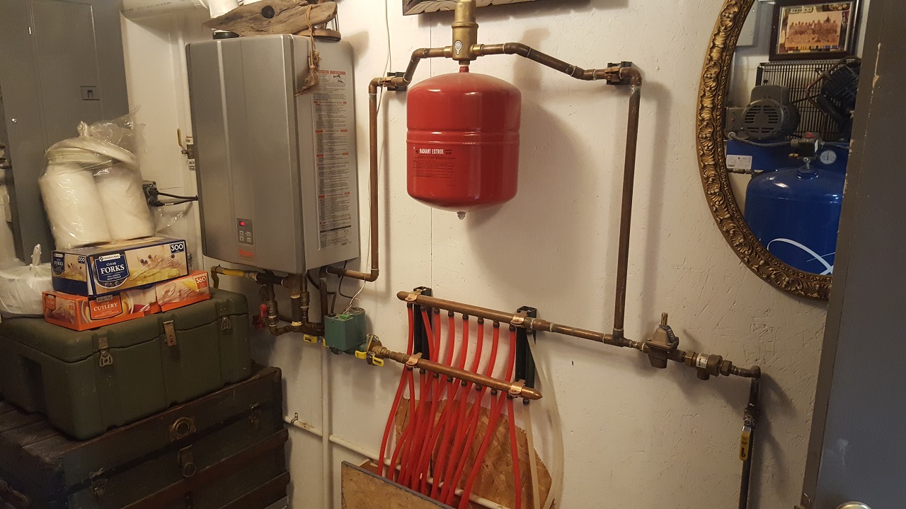

My systems are very simple. They are considered "open" systems. This means the building water supply is constantly open to the heat system using a backflow preventer and a 15psi regulator. After the supply regulator there is a T, one side is the water exiting the floor loops, other side goes to a "burp" tank. This gets rid of any air that might show up in the system and softens the pressure so there's no jar when it kicks on/off. Out of the tank to the inlet of the heater. Output of the heater goes to the pump. Output of the pump goes to the manifold pushing hot water into the floor loops.
This system functions as follows. Thermostat calls for heat. Pump starts moving water. Heater senses this movement and fires up. Pump moves water at about 3gpm. Heater regulates burner to maintain setting temp. 120F in shop. 110F in house. When thermostat is satisfied it turns off pump, which stops water movement and heater shuts down.

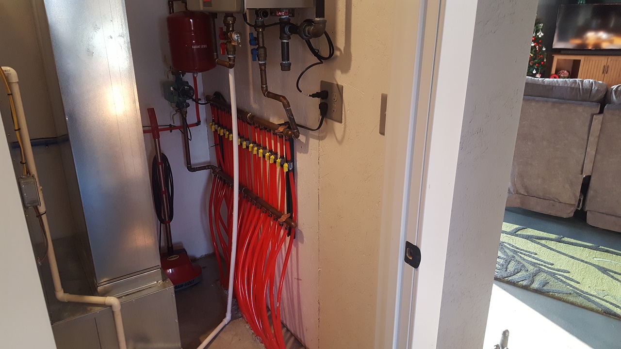

Here's my house system. It's located in the Mechanical room with the HVAC, Domestic Water Heater (Tankless) and the Water Softener system. Excuse the crude pics but best I can do. The room is 5x5. :)

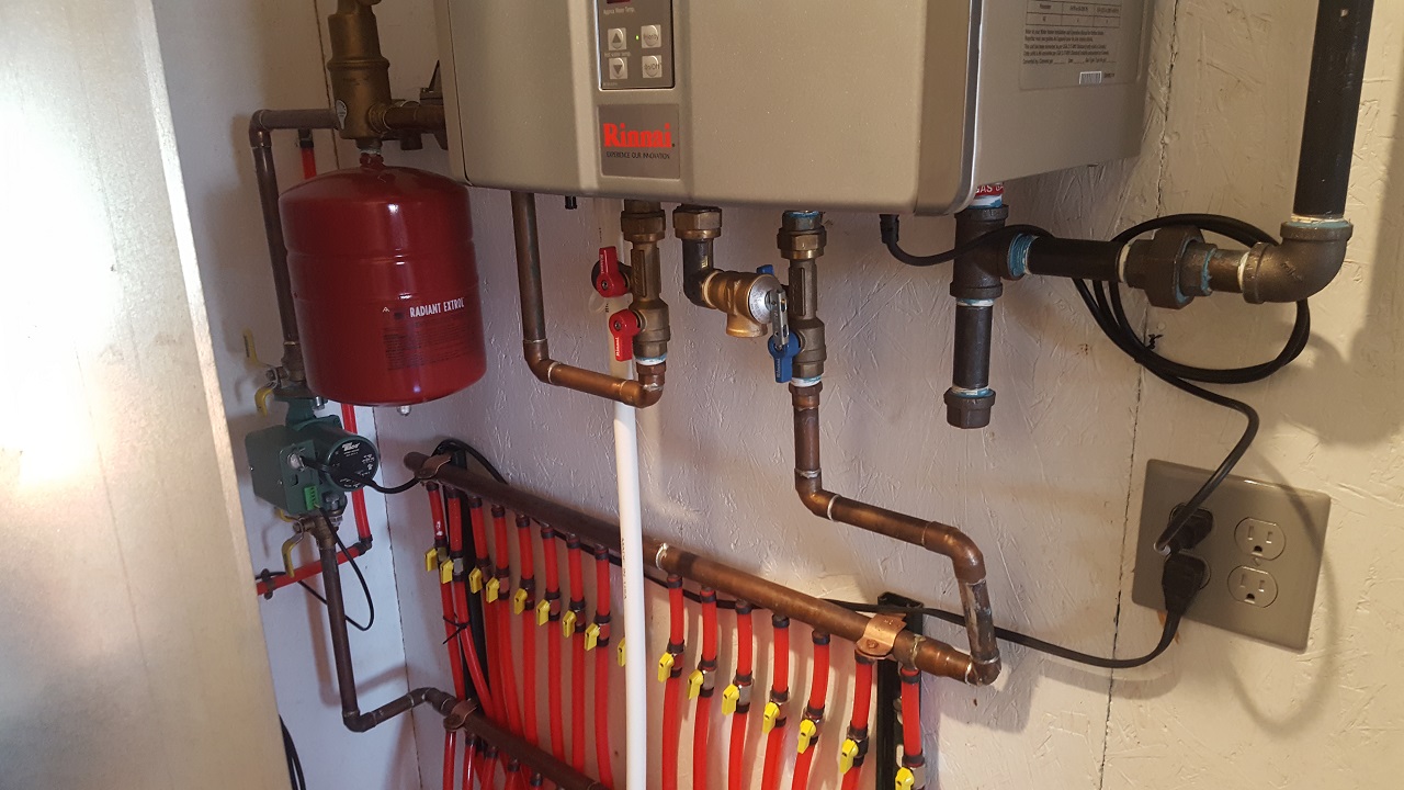

Here's my shop system. Some slight differences in plumbing due to space constraints in the house. Added shutoff valves on the house manifold.
