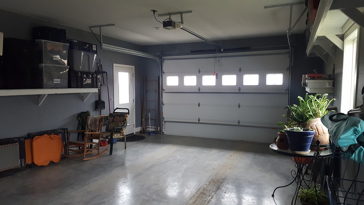

#189
I want to discuss the garage for a minute. It's 18x30x9. Has one 12' wide overhead insulated door with window panes. A walk out onto the front porch with glass. A walk out into the yard between the house and shop with glass. A walk thru into the house Laundry room. One window on the side facing the shop.
The floor is heated. It's also sloped toward the overhead with a 3" drop. The slope starts about where the front of the vehicle would sit when parked. Idea being any water dripping off the vehicle would go to the overhead. My insurance guy was very happy about it. Said if the vehicle loses any hazardous fluids they'll go to the door rather than trying to seep under the walls into the house.
We haven't been in it thru a Winter yet so we'll see how well it all works when Terry parks in it with a slush covered vehicle. :)
This pic is standing at the overhead looking toward the entrance door to the house. The wall on the right is also the living room wall. Wall next to the walk in door is the laundry room wall.

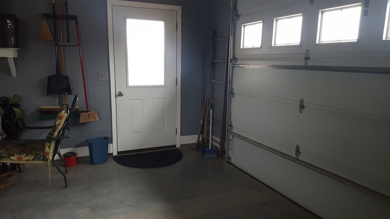

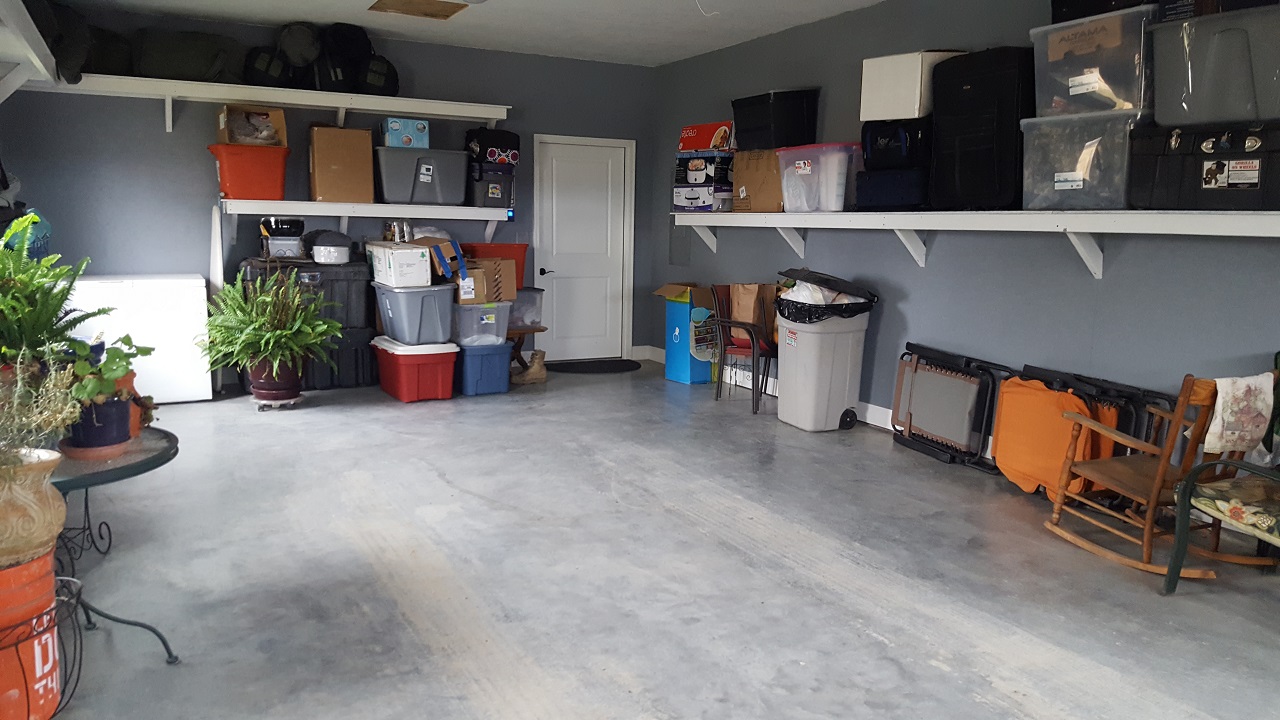

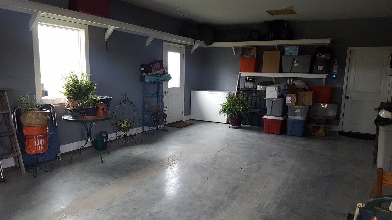

#190
Sorry, I meant to post all the garage pics in one post. Oooppss?
This pic is again taken near the overhead door. The walk out door is into the yard toward the shop.
This pic is taken near the walk out, facing the overhead.
In this pic you can see the drop in the concrete at the overhead. The mopboard is level, starting on the concrete at the upper end of the garage. You can see how far off the slab it is at the overhead end. The walkout is the only door in the entire houseplan that has any threshold. Would be slightly inconvenient to get a wheelchair thru that doorway. It goes out onto the front porch. A wheelchair might require going thru the house to get from the garage to the front porch. Couldn't figure out any way to avoid that ledge.
