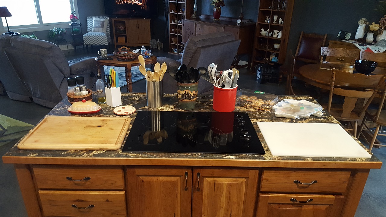

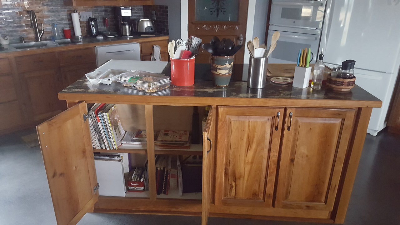

This is the Kitchen Island finished with cooktop stove. I get scolded sometimes for using the cooktop as a counter top..... :)
A pull out double trash container. This was a huge item of contention.... When Karrie installed the trash container he put if behind a swinging door. Open the door and then take hold of the trash container and pull them out. Terry derailed (rightfully so). She gave Karrie the "kill" look and said "I am NOT putting my hand in the trash container to pull them out!!!" I jumped in supporting her and said the trash container pullout is designed to fasten to a cabinet front. Pull out the front and the trash container comes with it. Karrie said "well I've never installed them that way". I said "this can be your first then". He rebuilt it.
Plenty of shelf storage space in the living room side of the cabinet.

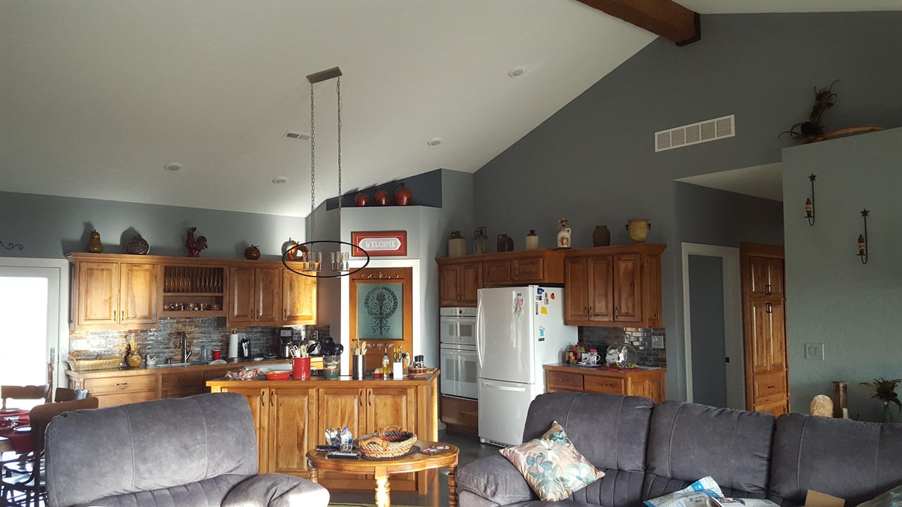

In this pic you can see the overhead light and get an idea of the size of the Kitchen work area. The Pantry is behind the stain glass door.

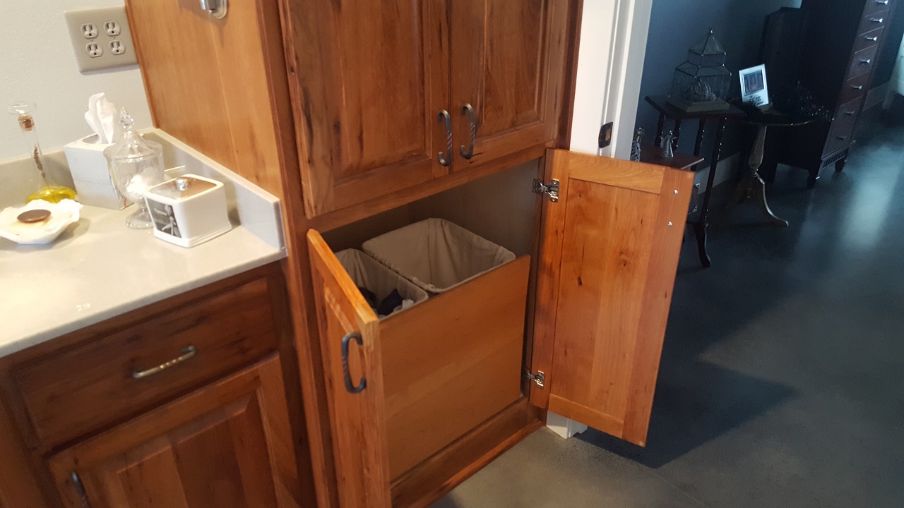

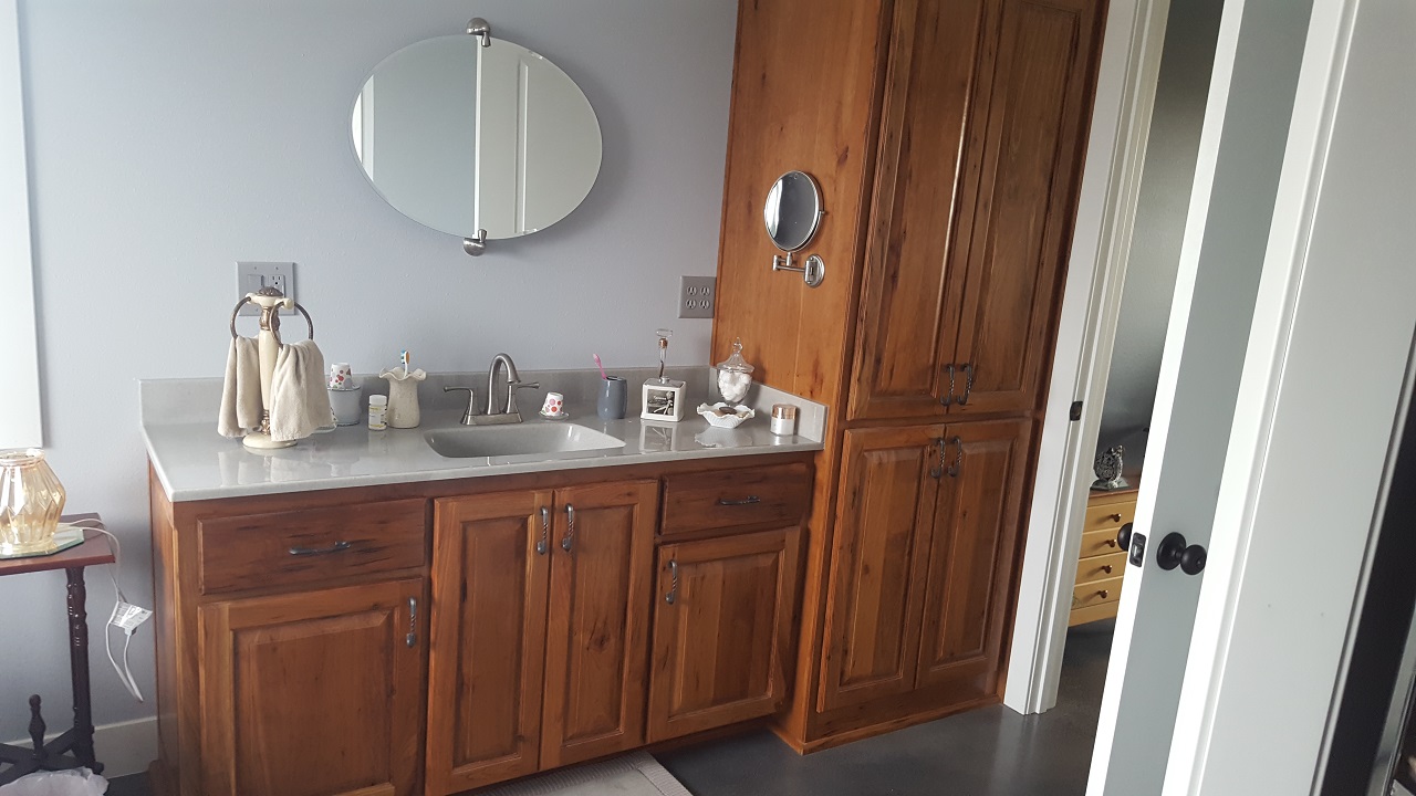

This is the Master Bath cabinet. Onyx sink/counter top unit. Plenty of storage in the cabinet. Pull out drawers behind the swinging doors on each side of the sink. Plenty of storage in the upper part of the cabinet to the right.
Dirty Laundry baskets in the bottom of the right cabinet. This too became a matter of contention. When Karrie was done the baskets didn't have a front on the pullout. Again, Terry said "I am not going to take ahold of the basket to pull these out". The pullout was designed with a metal flat front so it could be fastened to a pullout cabinet front. Karrie suggested not doing that because the tall cabinet front would make it hard to get the baskets out..... Okay, but put a front on the pullout. He did. White Pine. We stained and varnished it.....

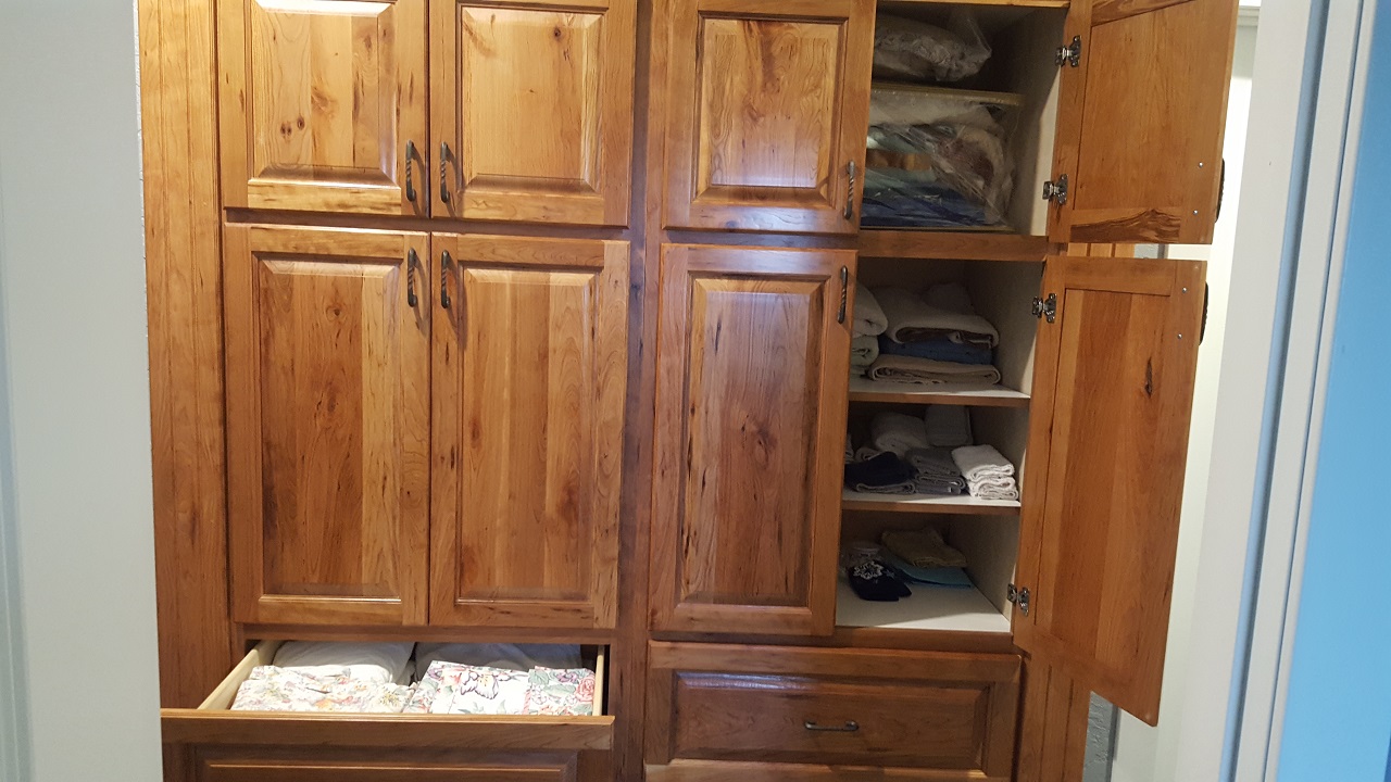

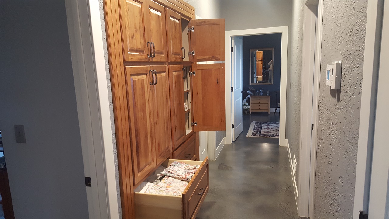

Our house plan called for a double bi-fold door closet in the hallway. Terry didn't like that idea. She wanted a built-in cabinet. With minimal input from Terry he designed this cabinet. He nailed it. Everything about it works perfectly. Size of the drawers are perfect. Fits and is trimmed out perfectly. I'm still not sure if he's capable of doing this level of work consistently or if he just got lucky....

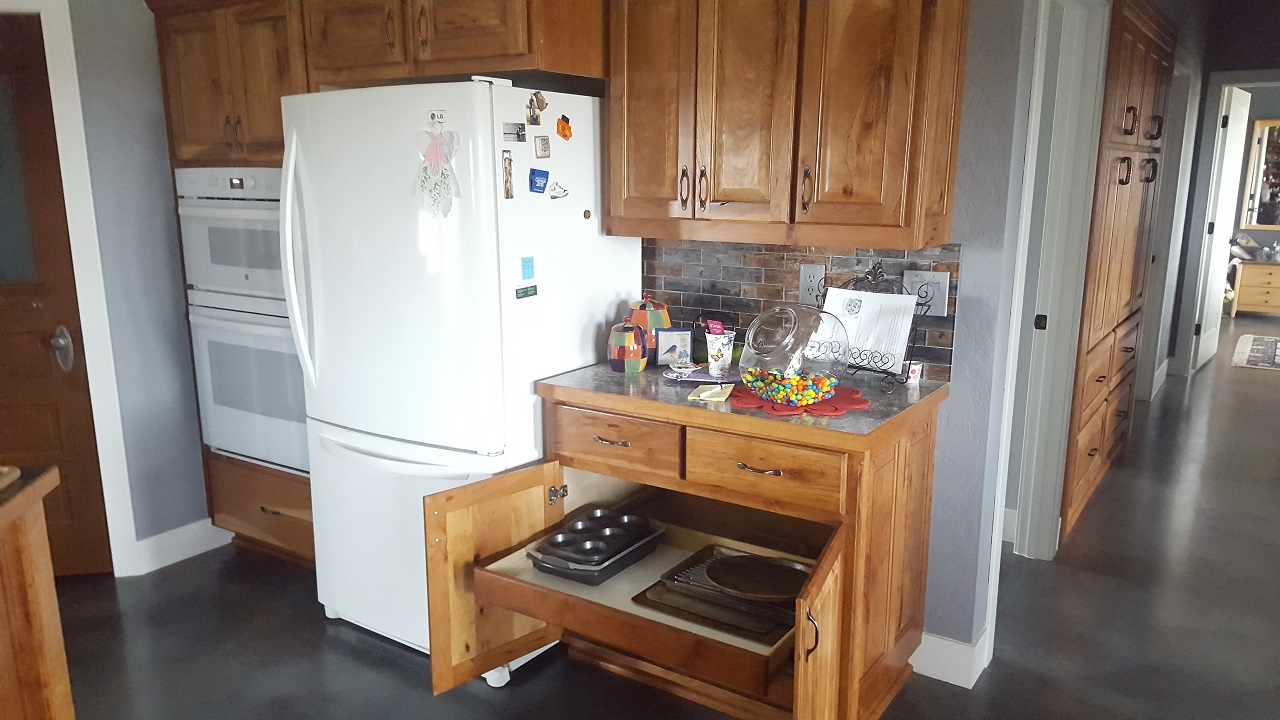

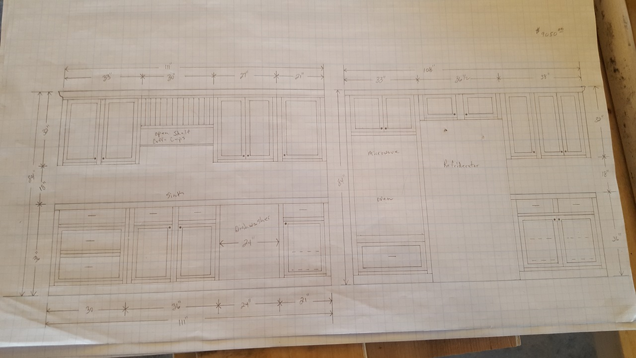

This cabinet makes room for the Refrigerator as well as a stacked Microwave/Oven. Good storage.
When Karrie started installing the Microwave/Oven he ran into a problem. The cabinetry was 1/2" too shallow. I had given him the Specifications sheet on the Ovens. He started making excuses saying the Ovens weren't built right and that he'd installed a lot of them with his cabinetry at this depth without problems. His helper (older gentleman, retire Aeronautical Engineer) picked up the paperwork on the ovens and started looking thru it. While Karrie was still making excuses John said "oh here it is right here Karrie" and showed him the specs which called for a cabinet 1/2" deeper than what he had built. So they pulled the Ovens out and cut the back out of the cabinet to get the needed 1/2". No big deal. Just shouldn't have happened.

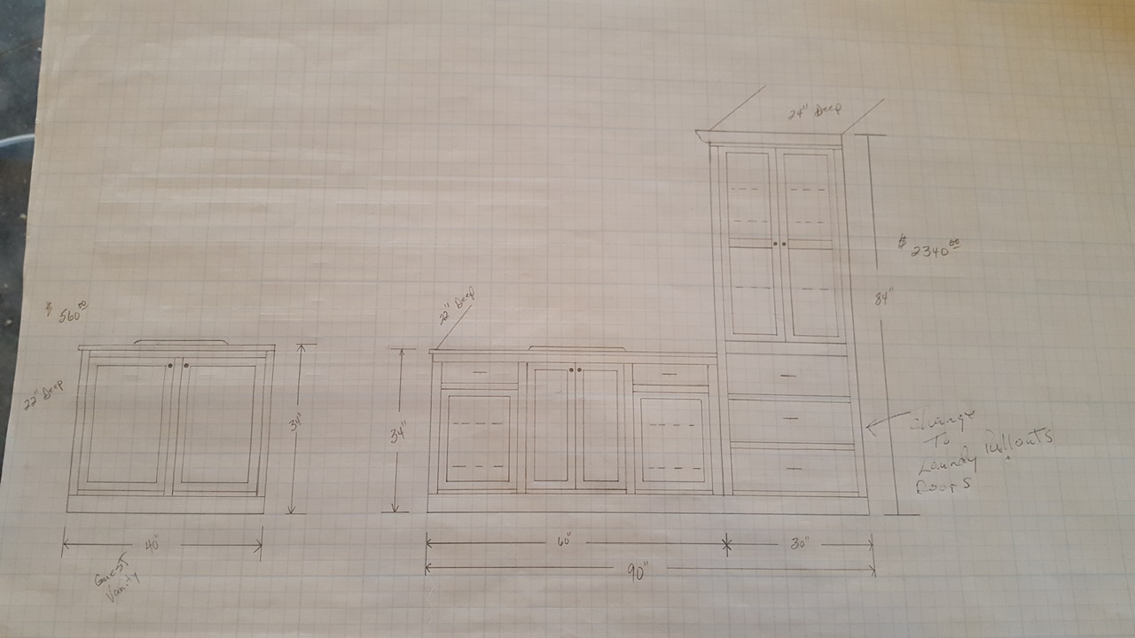

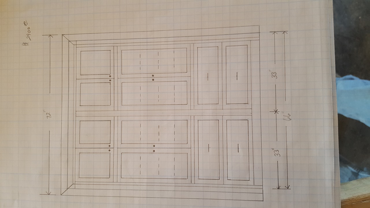

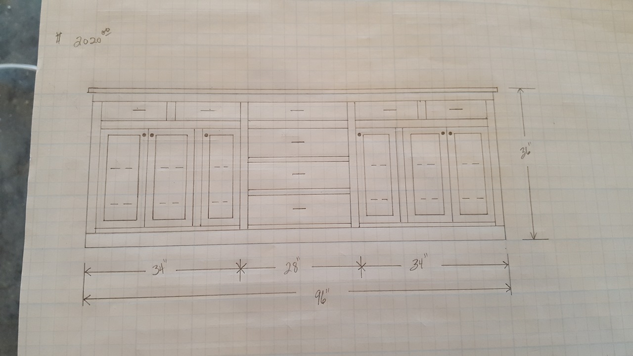

Here's the spec drawings for all the cabinetry that Karrie built for us. I think you can see the proposed cost for each. In the end we paid right around $19,800 for all of them installed.
