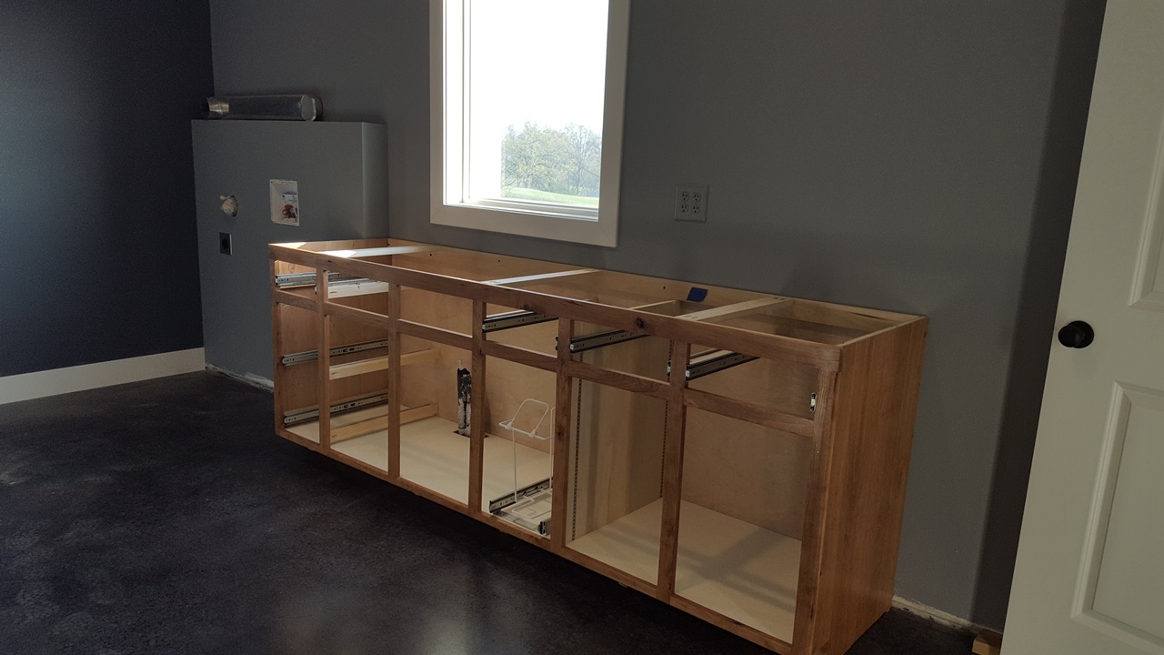

The cabinets are finished in Rustic Cherry like our previous cabinets were. We really like the look of Cherry. Karrie did a good job of finishing the fronts. There are an occasional visible nail hole but you have to inspect them pretty close to find those. The fit of the doors and drawer fronts are pretty good. I adjusted a couple doors for a better fit after Karrie was done.
He installed the units in the house without the drawers, doors attached. He added the counter tops and cut out the sink holes after the cabinets were installed. I was a bit surprised by that. We cleaned a LOT of sawdust out of the cabinets before he installed the drawers/doors.
Karrie was hired on 01 October, walls were roughed in so he could get accurate measurements 01 December. We set a move in date of 01 April. We finally told him we were moving in on 11 May. He wasn't done with the cabinetry. I told him there would be no more wearing shoes into the house. No more leaving a mess behind himself. He worked an additional week to finish after we had moved in.

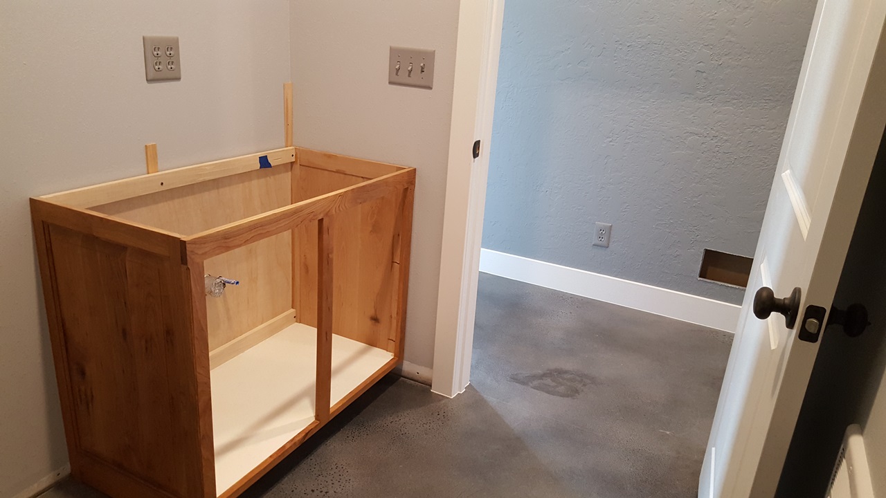

Here's a couple initial pics. First is the sink cabinet in the laundry room.

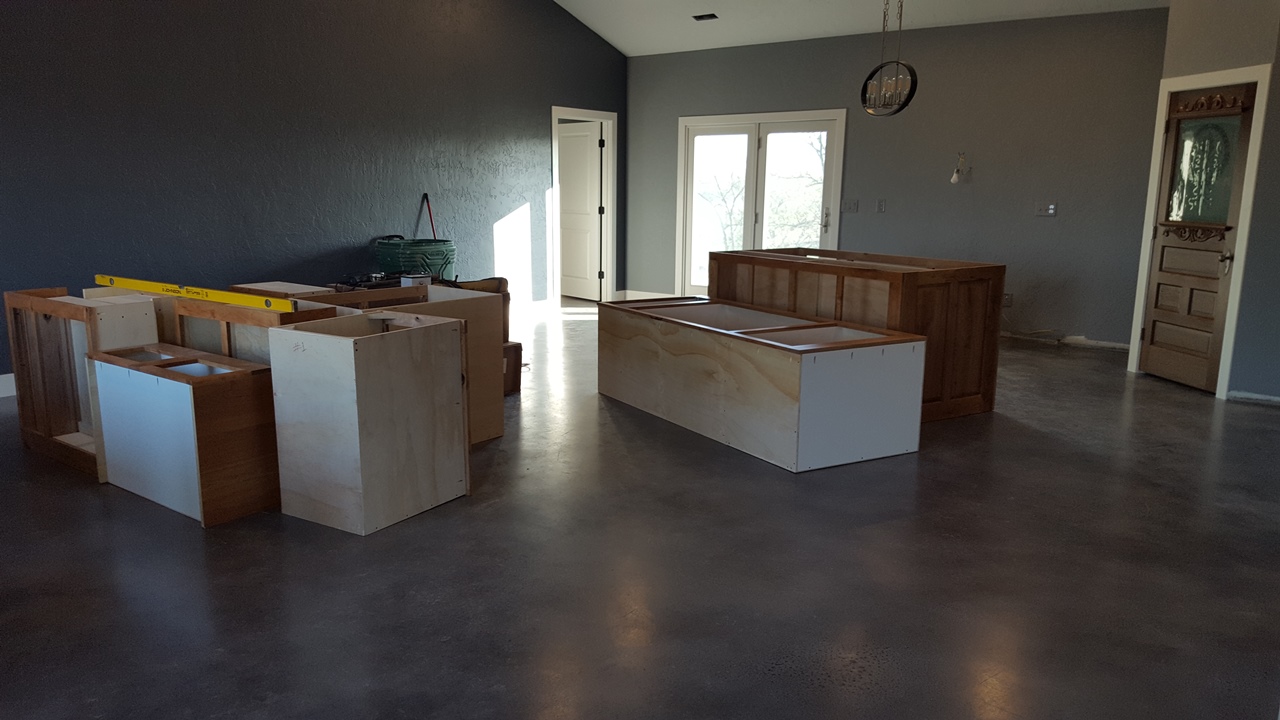

Next is miscellaneous cabinets in the kitchen area.

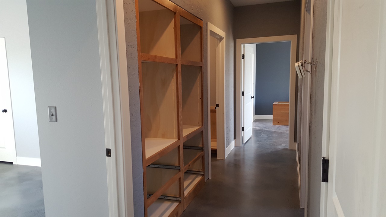

Hallway linen closet

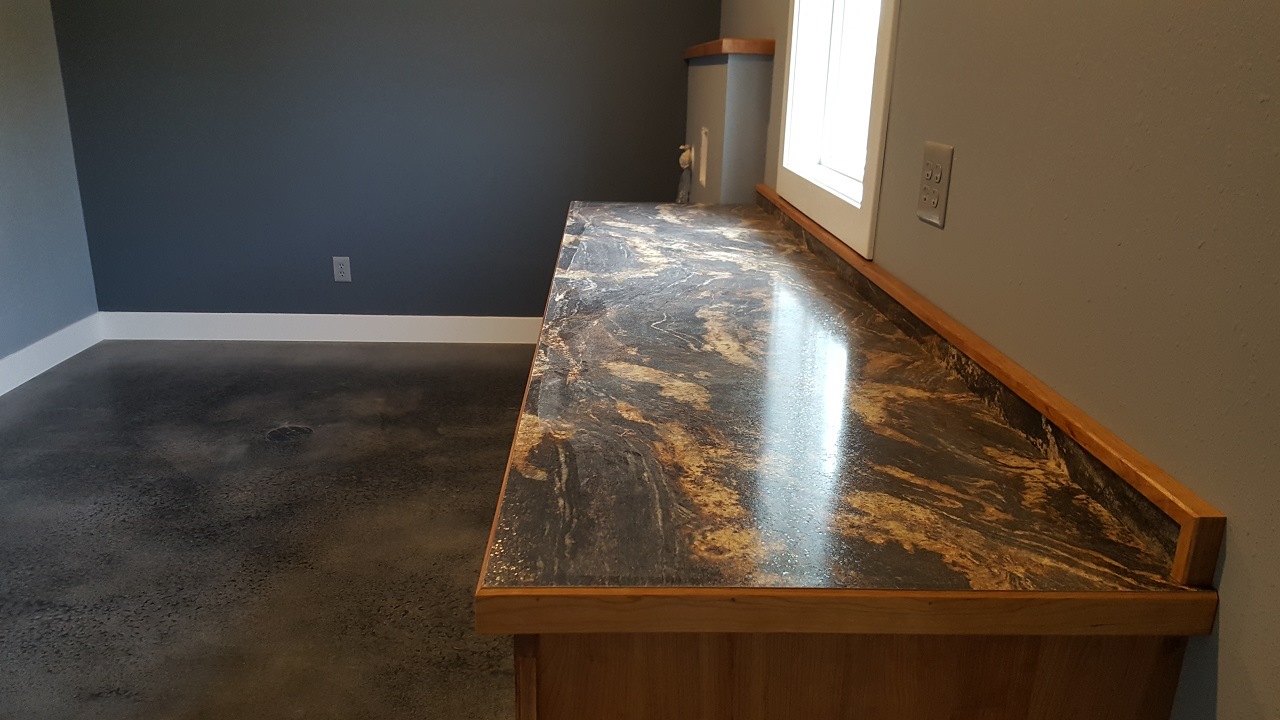

Terry selected two different styles of counter tops. First pic is the laundry room cabinet before sink install

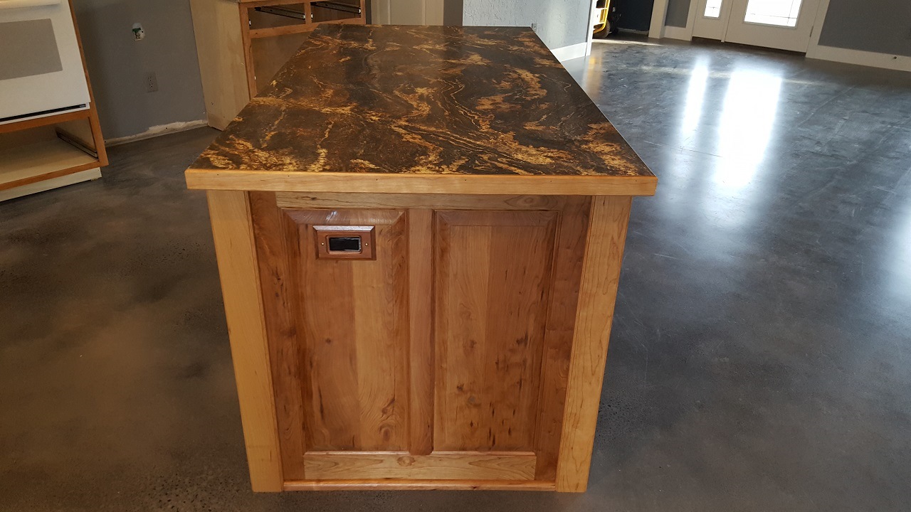

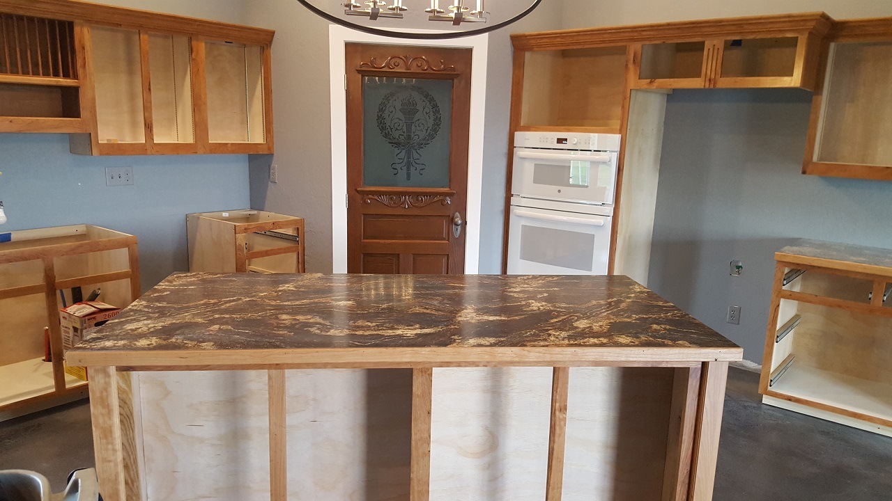

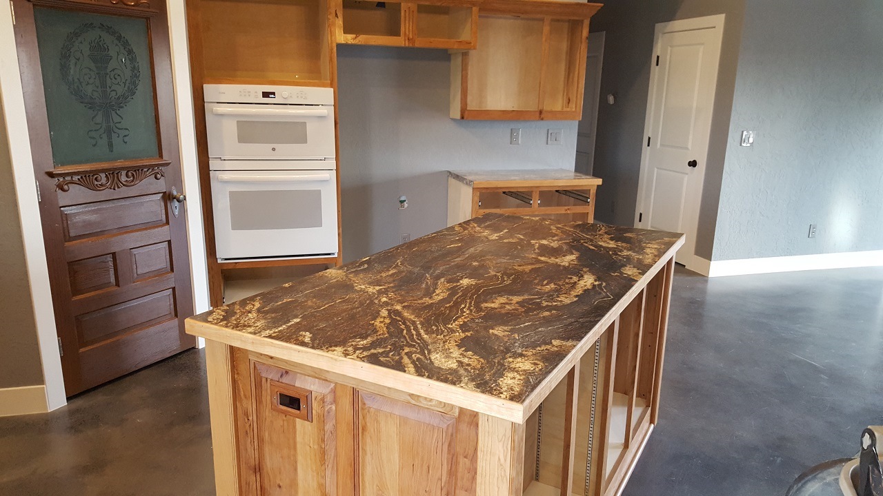

This is the kitchen island before cooktop install.

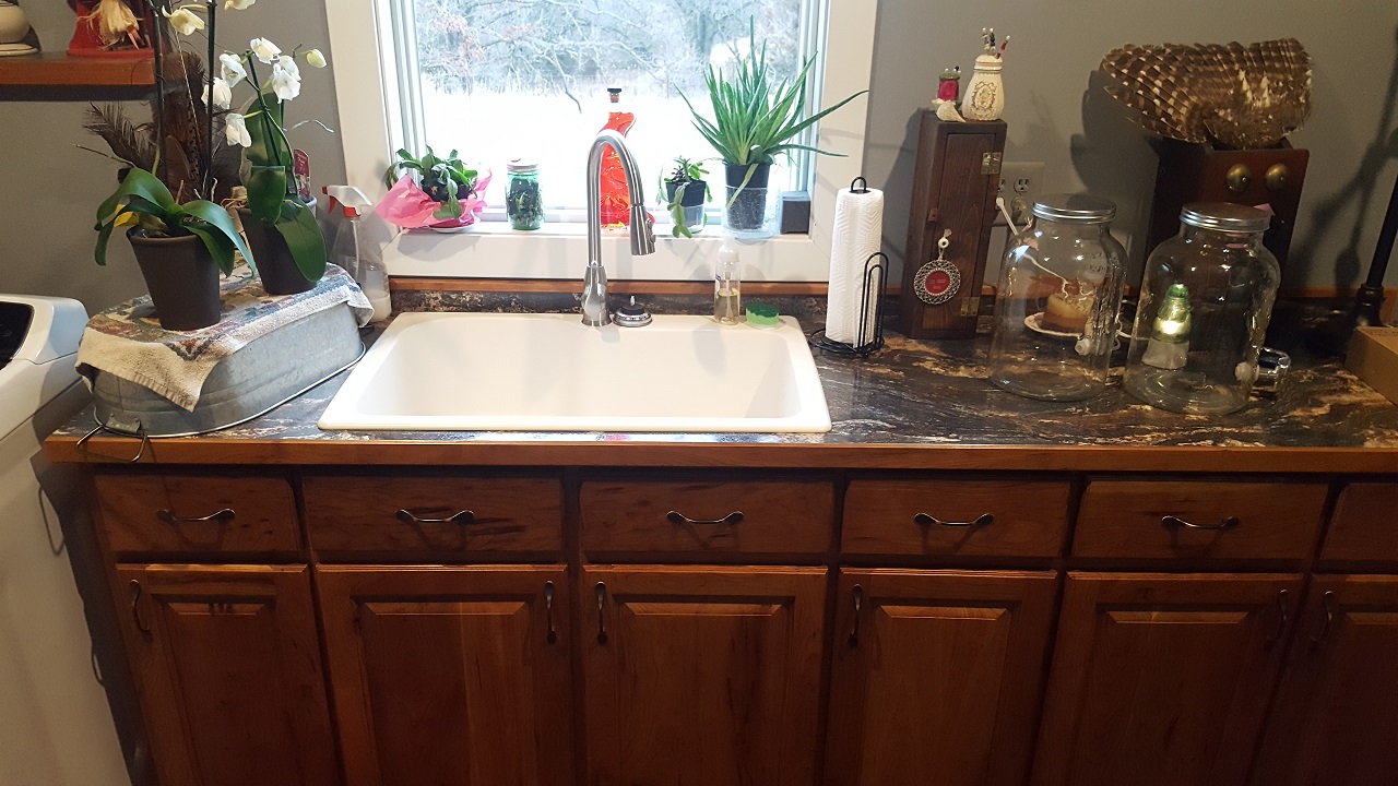

This is the Laundry Room Sink Cabinet finished. Drop in large bay sink. High clearance faucet. Pull out drawers behind swinging doors on the left to store laundry supplies. Pull out trash container behind swinging door on the right.

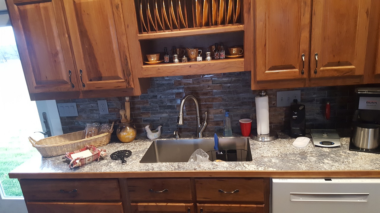

This is the Kitchen Sink Cabinet finished. Flush mount sink embedded into the counter top for easy cleaning. Single bay deep sink. High clearance faucet with extendable hose and a soap dispenser.
