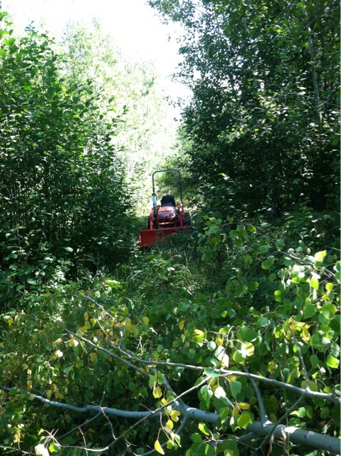

I've used my B2320 for five years for very rough bush hogging, a fair amount of loader work including maxing out the lift & scoop, and a bit of grading.
What I do is:
High range for long trips with no load in areas where it's not too beat up (good graded gravel or paved road). I've run six miles one way on roads, sometimes use the cruise if I'm not carrying the bush hog. The banging of that thing keeps me in a lower range.
Medium range for general running across a pasture or two-track etc while carrying no or light load, e.g. getting from a short point A to point B where work will start at point B.
Low range for all work: bush hogging, front loader work & carrying or dragging anything of significance, and it's in 4WD then too.
You'll learn pretty quickly the HST is very easy to use and the B2320 will get about anywhere if you keep yer wits about you. ImageUploadedByTractorByNet1472267711.670539.jpg
