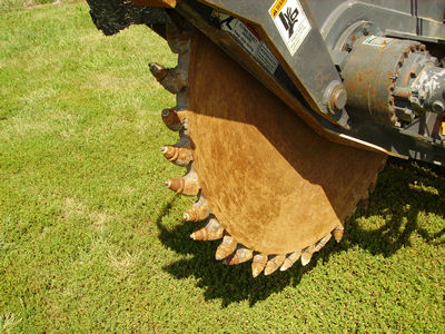

I built a "simple" trencher like your pic and it did not work worth a **** and that was in good soil. If you are going to try the tube or channel you will need to add a long tooth to the front to pull the trencher down (no down pressure on 3pt); otherwise it will just plug up and skid allong the surface. Similar to a plow share.

If you could buy or build these, they should work for you, if you have a fel, or something with forks,
You could pull a sub soiler through the ares and dig out the loose dirt/clay, or whatever.
That rock trencher in the last picture, should be able to cut the trench, then you have to clean it out.

A rotary drain cutter is what you need , easy to build and effective . A round heavy disc with rotary hoe blades driven off the PTO , i would make it swinging so you can set whatever offset you like . (left click on expanded image so you can read it)
