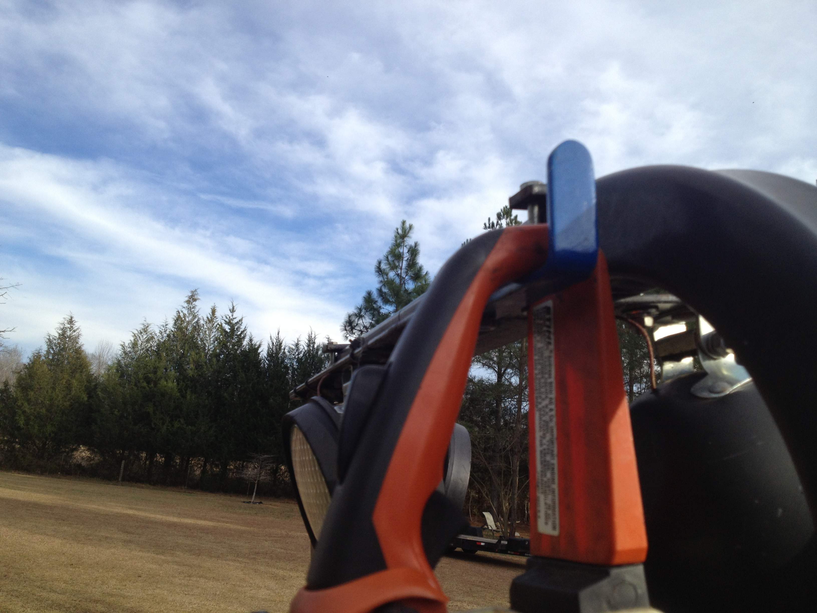

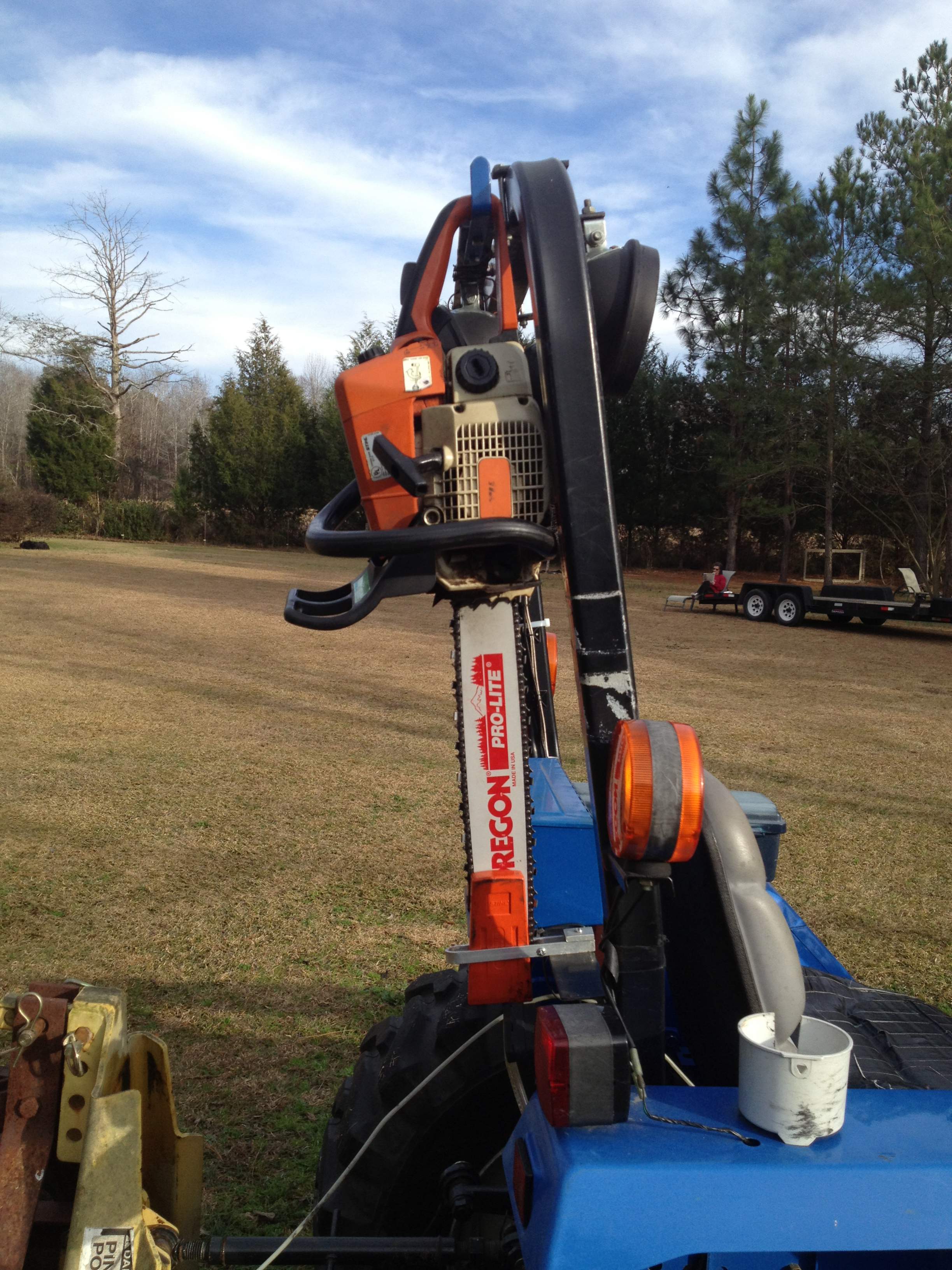

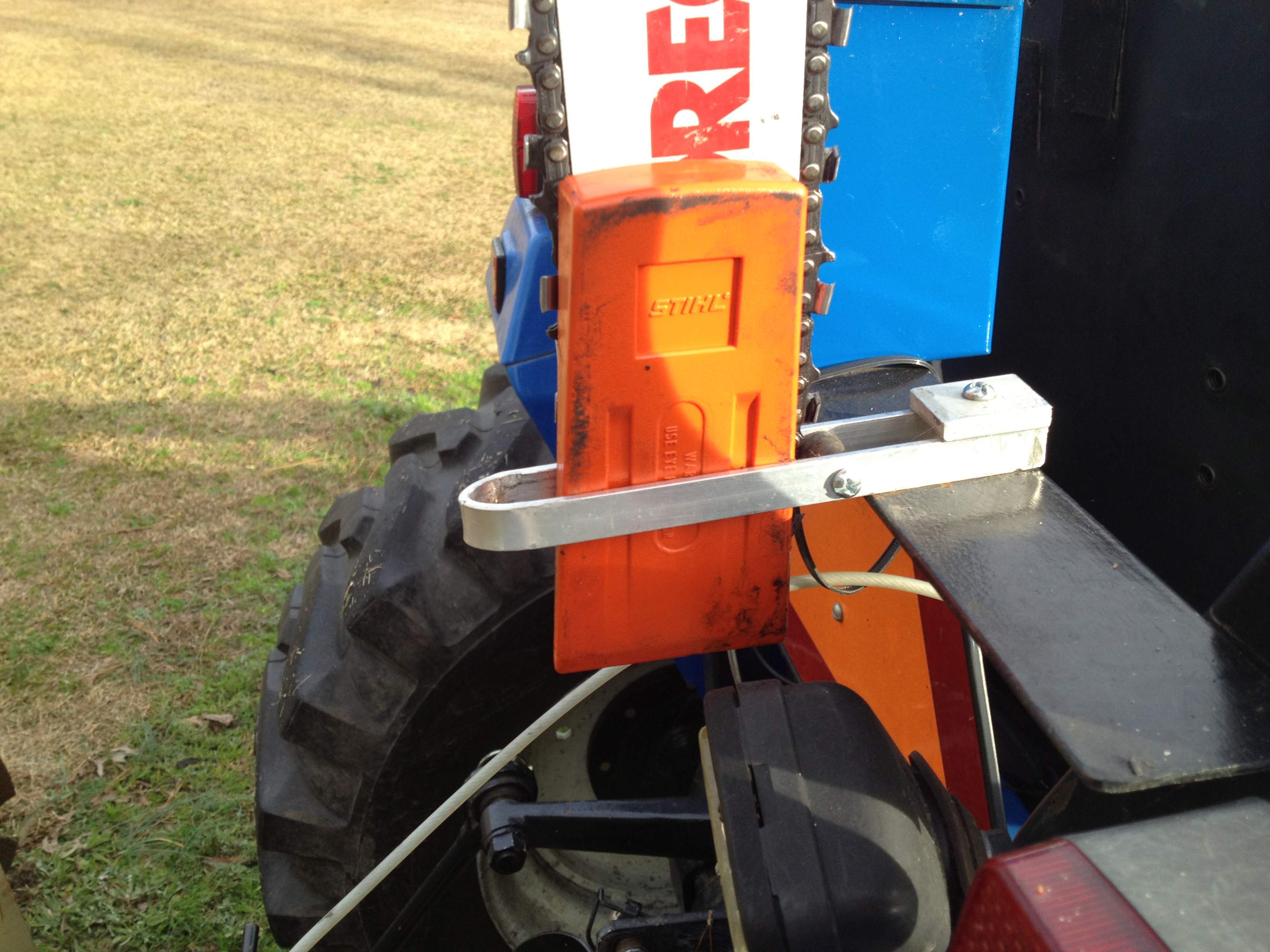

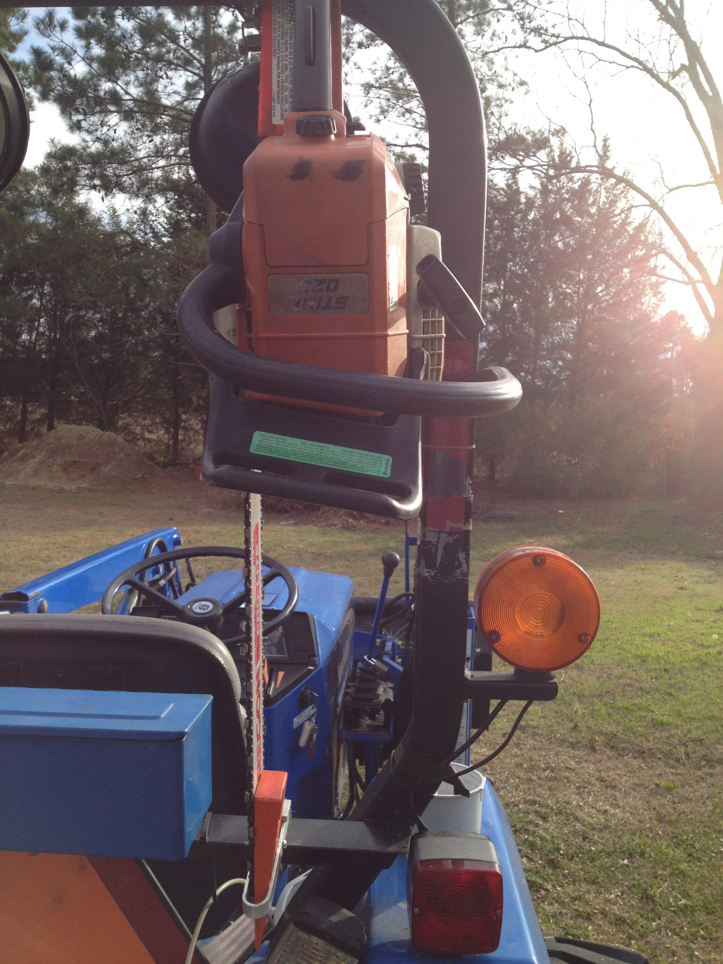

This is my latest setup for the Chainsaw.

Niffy idea,your vision block whan looking over shoulder backing up?
/ New Improved ROPS Chainsaw Holder #3
It looks like it would be difficult for me to get to it, not being too nimble to climb around on lift arms carrying a big saw but it sure beats putting it in the FEL bucket and forgetting it is there and deciding to do a little dirt work. I did that with a chain once and found it a few minutes later when travelling the same path. Had forgot I had put it in there till I saw it in the grass.
/ New Improved ROPS Chainsaw Holder #4
It would be too high mounted for what we do- branches would hit it- but it's a good idea. Out of the way, protected by the ROPS, and out of the bucket. Nice work.

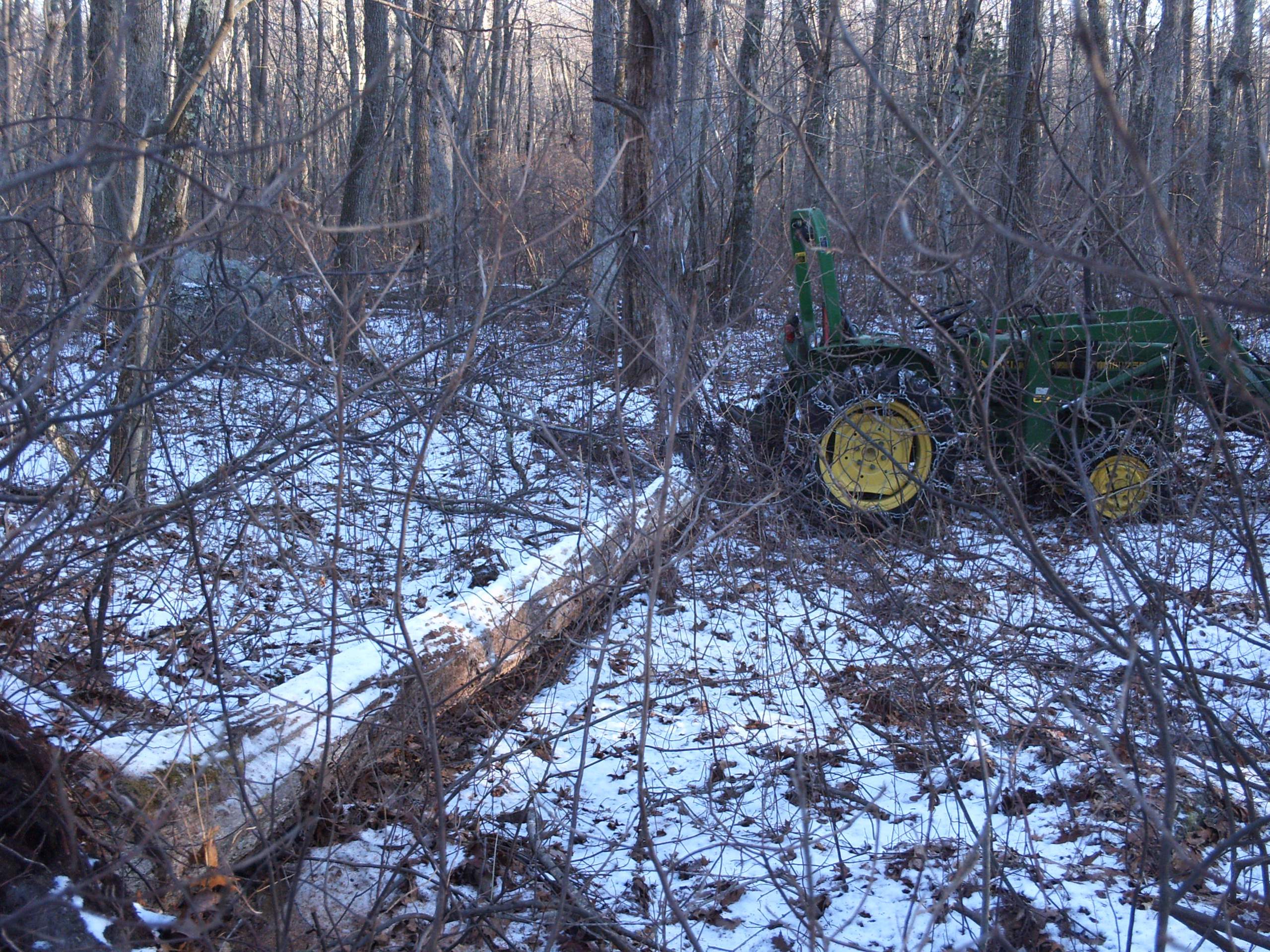

Nifty set up and elegantly simple. I'd destroy my chainsw there as the woods I go thru are very dense. With no winch, I have to back up to fallen trees and that's where the problems arise.

I have not had any trouble with brush in my area, but that is why I put it behind and lower than the ROPS top bar. As far as getting to it the lift arms at least on my tractor are not in the way. I have my skidding tongs on or my carryall with
a water tank for control burns when I carry the saw. I use to use the FEL but forgot it was up there not good. sorry for the double post I did not see the Chainsaw thread.

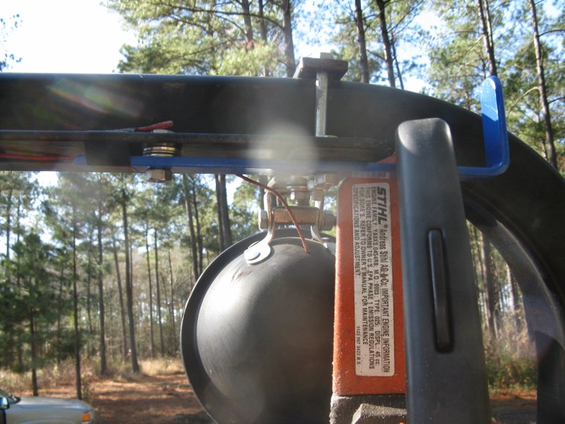

Very nice. Can you reach up that high or do you have to hold it by the bar to hang it? Can you post a head-on picture of the top hook if it isn't too much trouble. Thanks.
I hold the wrap around handle to hang it. but the TC 30 is a bit shorter than a full size tractor. I mounted the hook to
the bracket I bolted around the ROPS for my lights. No holes were drilled in the ROPS
Hope this helps

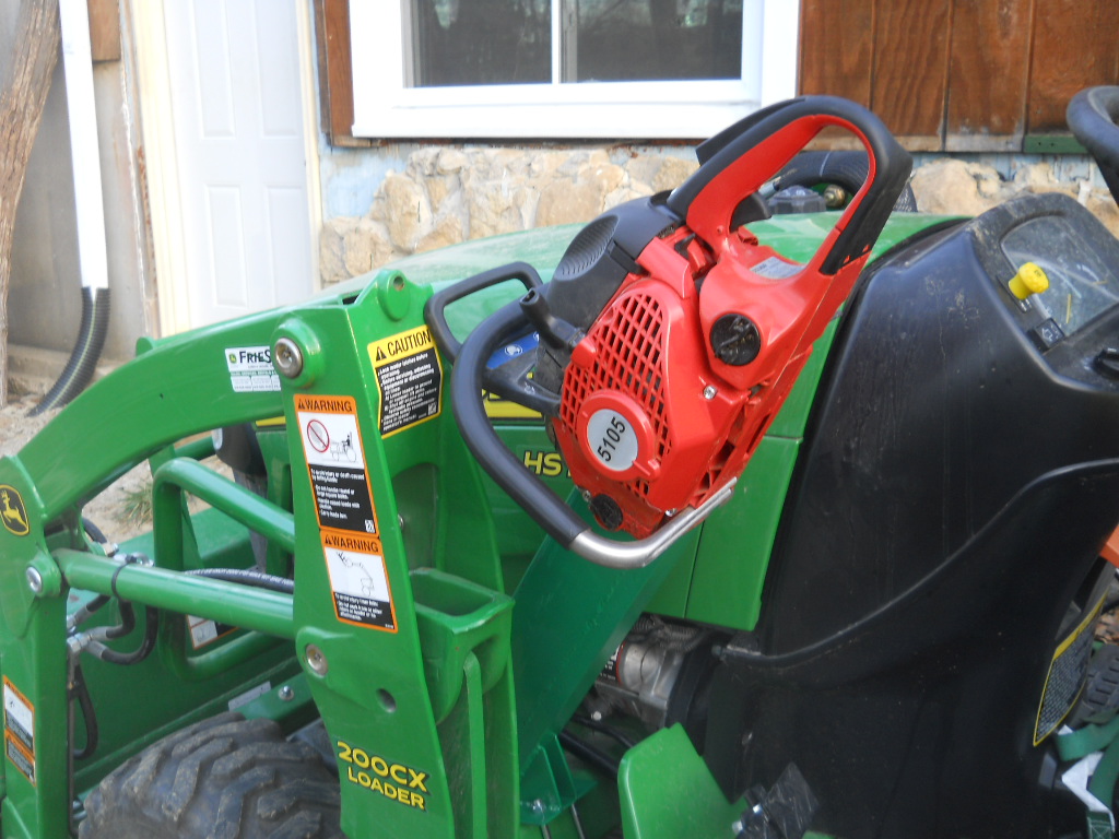

I mounted mine with simple 1/2" plywood inside the FEL arms on the frame - its out of the way and easy to access.
The hood clears the ammo box with 20' of chain in it too.
