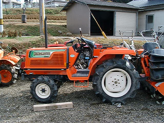

The 1712 is hydraulic. The N uses two. I used the old stand by NAPA 1334. But a 1344 or 1348 will fit. Post a picture when you get it ready to go.
   / New Iseki TA210 #22
Here is the picture overseas...

You can see one hyd. filter just above the step. The other is under the fender/ seat. That appears to be the same size as the N239 I had. It is a nice tractor. The push button 4x4 is handy.
