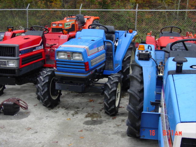

Here is a TA 262. Let's see how much they are alike.
   / New Iseki TA210 #15
Reed are those your machines,or are they in japan still ?

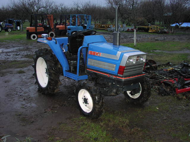

My website is still under construction. Here is a picture of our TA230.

   / New Iseki TA210 #17
This was taken at my importer's lot. I took the Iseki home and wanted the big Hino in the back. My mentor that got me started in the grey business wanted it for his own use so I passed on it. It was really neat. It was an N329. It has push button 4x4, power steering, and was BIG. In compact terms anyway. He has already had it in mud up to the floor pans.
I'll send you a picture of my flock.
   / New Iseki TA210 #18
I purchased that N209 and it should arrive in a couple of months. Are you familar with the filter numbers, especially for the fuel and oil (air and hydraulic also)? If the filters are the same as the E2304, I have those numbers...
   / New Iseki TA210 #19
The air filter is different. I have the N189 and N239 numbers.
The N189 uses a 6270 air but I never did match up the N239 air filter. The fuel is the same in the 2304 and N189 but the N239 uses 3390 fuel. The 1712 and 1174 filters fit the upper and lower on both N tractors. I have both parts manuals if they would help.
