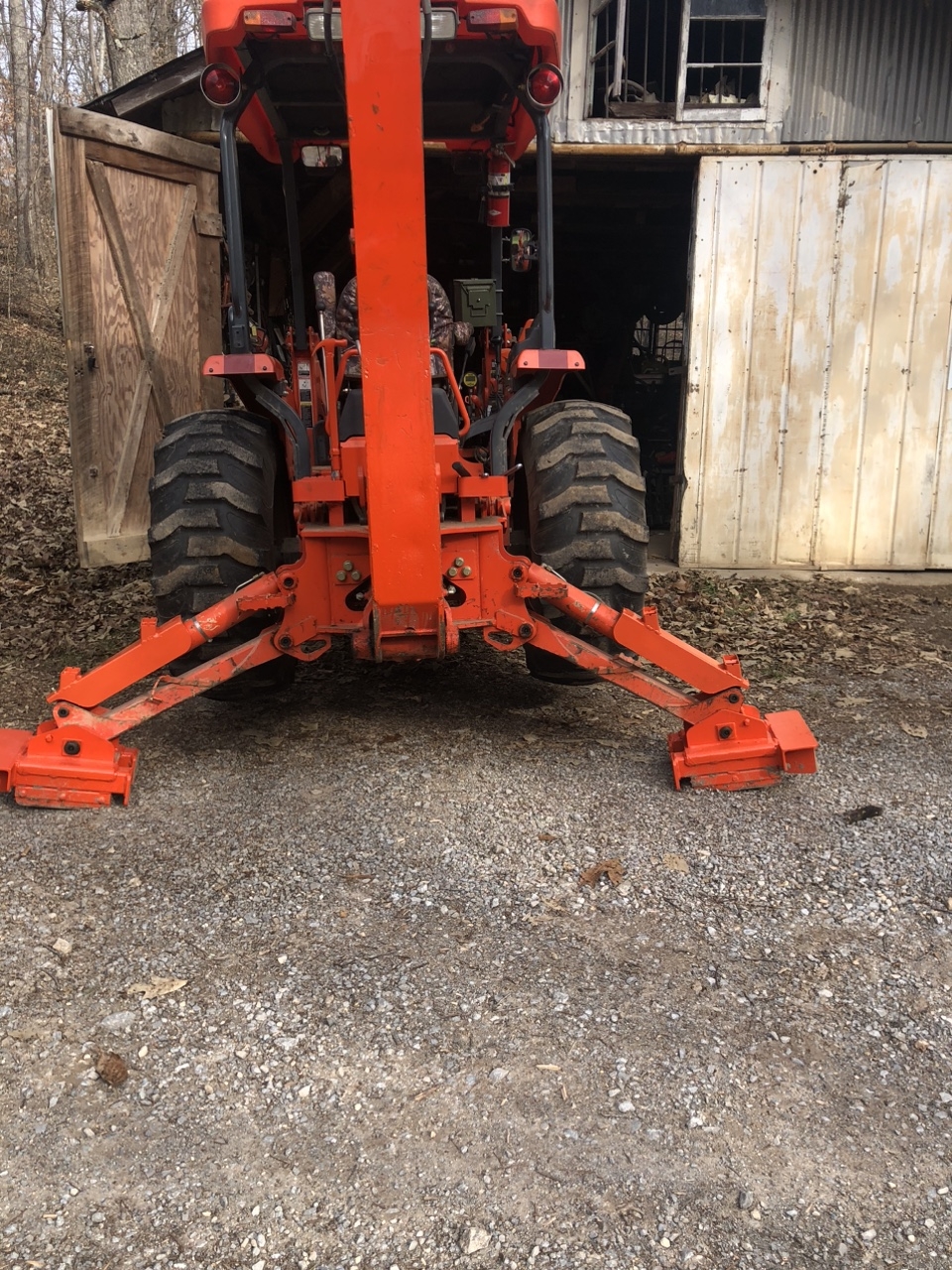

Making Mega pads for the M59 outriggers made a huge difference on our hillside farm. Improvements on soft ground and on slopes. Added steps to cylinder rod guards helps climbing up and down. Like them so much did the same for the B26.

Thanks for the mega-pad suggestion - we'd definitely benefit from a pair of those! We're on a hill as well.
We are also in very hilly country. After 15 years with the with this M59, I would have to agree that the outriggers slide too easily for the backhoe. It's not just the size of the pad, something isn't right about the shape as well. Making the pad larger is part of the answer, and a 4" spike in the middle might be an advantage too.
The outrigger geometry, width, lift, and actuation all seem to be good. The M59 comes with the steps built onto the cylinder rod protectors that I think had to be added to the smaller Kubota TLB.
I usually just spin the seat and get on/off from the front when using the backhoe. Spinning the seat conveniently did require removing the parking brake for foot clearance but haven't missed it.
