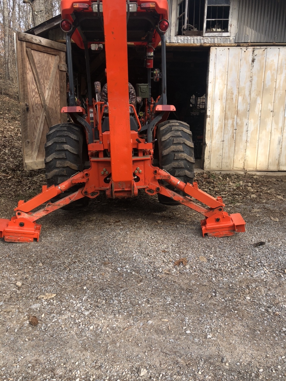

Making Mega pads for the M59 outriggers made a huge difference on our hillside farm. Improvements on soft ground and on slopes. Added steps to cylinder rod guards helps climbing up and down. Like them so much did the same for the B26.
