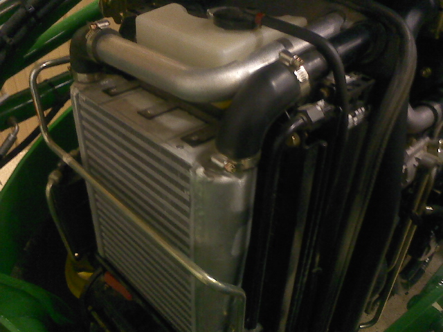

Picture of the cooler is on Page 3. Thats what I thought, there is no oil lines going to it, & definately has nothing to do with the air conditioning. My farmer cousin looked at it, and as soon as he saw it he said it was an intercooler.Maybe they just started this on the '11 models? Maybe somebody will have some more input. Is it on all 4000 models now?

I have no idea what that thing could be doesn't look like an inter cooler or ac unit i've ever seen before!

I'm going to see if I can find where the other line goes to.

Here it is. I followed the lines & one of the looks like it goes to the intake & the other line I cannot tell. It is behind the turbo. What do you think? View attachment 239283
Looks like an intercooler to me too. Hose clamps won't hold AC pressure, and piping looks too big for oil cooler.

I just looked it up on John Deere parts breakdown, it is indeed an intercooler.
Charge Air Cooler
LVA151199 - Intercooler
John Deere - Parts Catalog
4320 does not have an intercooler. So that would help explain the price difference between the models as well.
