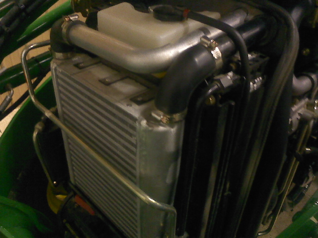

"I'm also pretty sure the 4320 does not have the intercooler which cools the air coming into the engine. Cooler air=more horsepower. "
Not true! None of the 4000 series tractors have intercoolers!
   / New John Deere 4520 (Pics)
#22
What is the extra cooler on the very front of my tractor for? Looks like a radiator, but my previous 4120 did not have it. I will have to look at it again, but I was sure it was hooked to the intake/turbo area. I could be wrong.
Maybe the correct term is aftercooler instead of intercooler?
#24
I'm almost sure that the optional cooler is for the Power Reverser transmission. There is a few different coolers on the front, but this one is about the same size of the radiator & is silver in color. It doesn't appear to be for oil? :S
   / New John Deere 4520 (Pics) #25
Could you snap a quick pic of it? Having trouble getting a visual.
   / New John Deere 4520 (Pics) #26
If it has a cab, that will be for the AC. You can't get power reverser on a JD cab compact, ehydro only.
#27
That is correct. I will take a picture of it but I thought the condensor was behind this cooler. I will get it uploaded shortly.
   / New John Deere 4520 (Pics) #28
Almost all of the 4000's come with the power reverser standard. Ehydro is an option for everyone besides the 4720.
But I do agree it's probably for ac.
#29
Here it is. I followed the lines & one of the looks like it goes to the intake & the other line I cannot tell. It is behind the turbo. What do you think? John Deere.jpg
