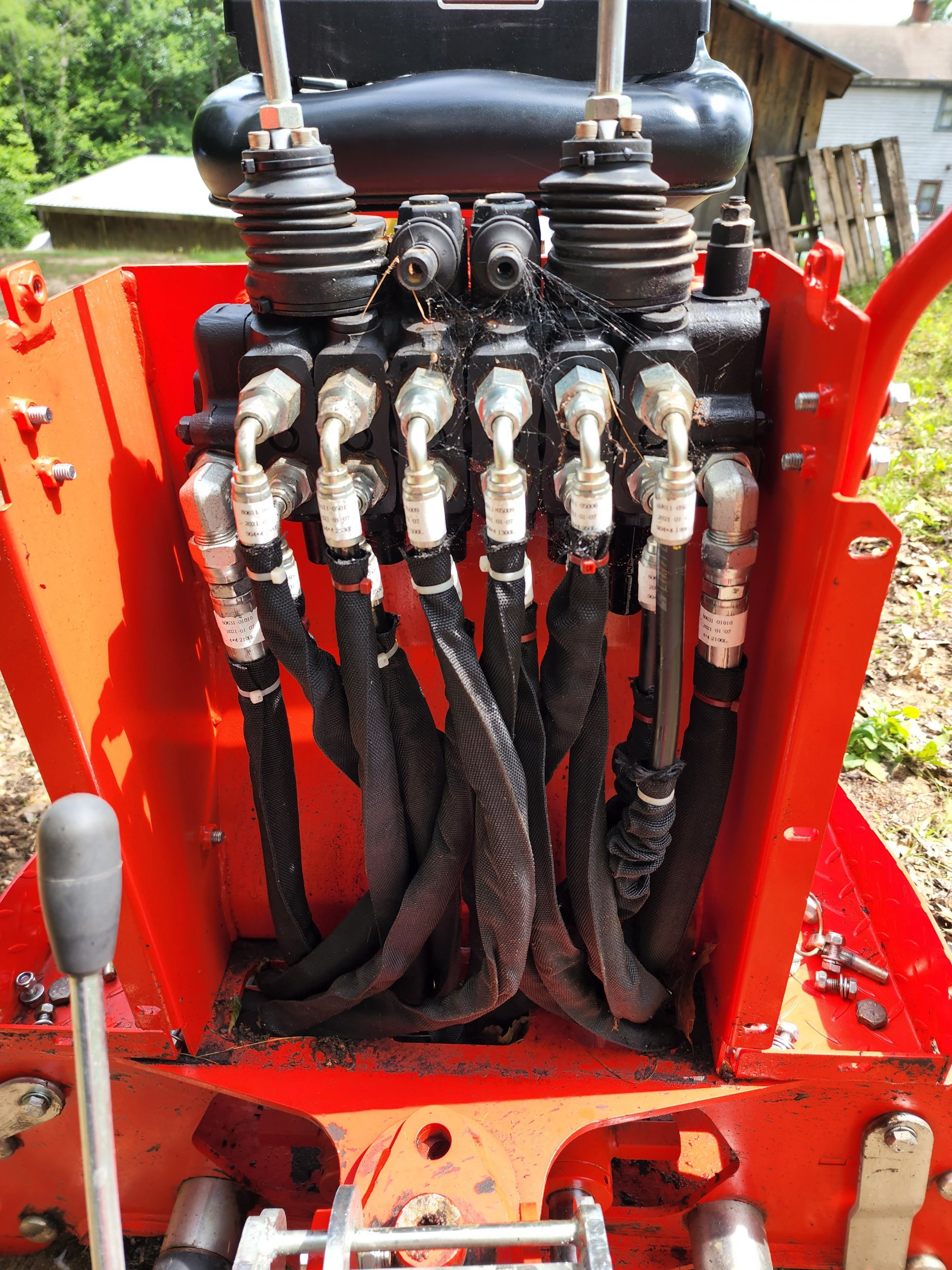

Most seriously: Back hoe control knobs hit the outrigger knobs and causes the outrigger to swing up randomly. It damages the back hoe and can crush your foot or knee. Adjustments can easily be made but it is unacceptable that this passes QA.

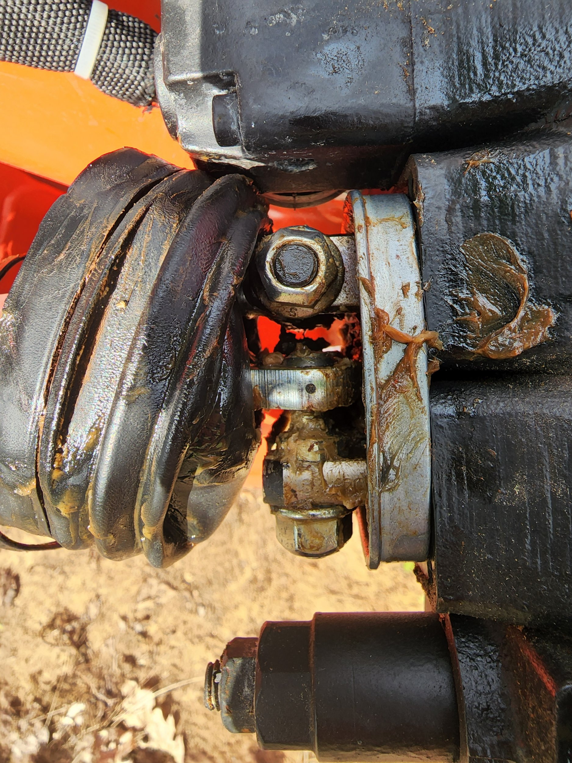

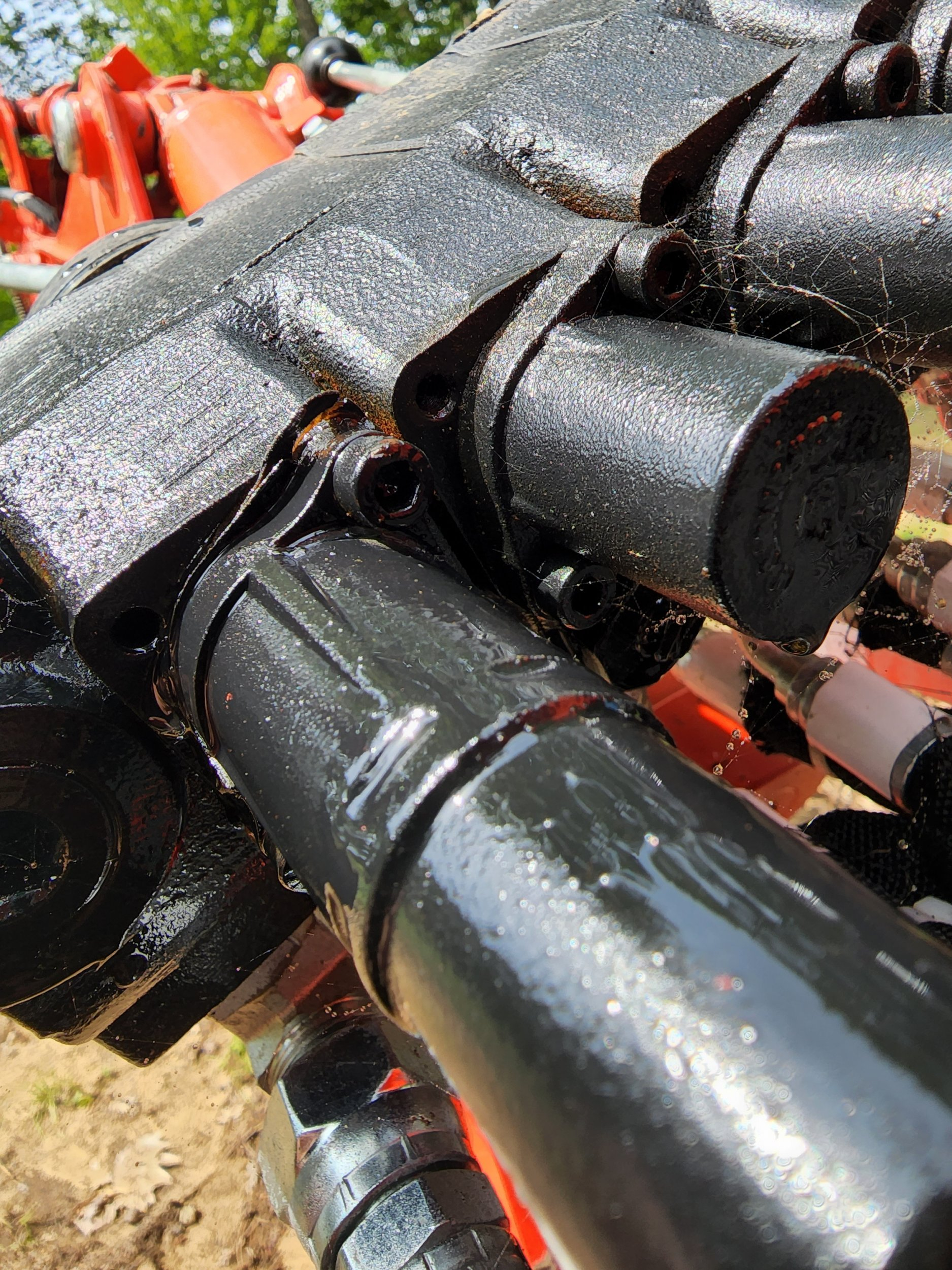

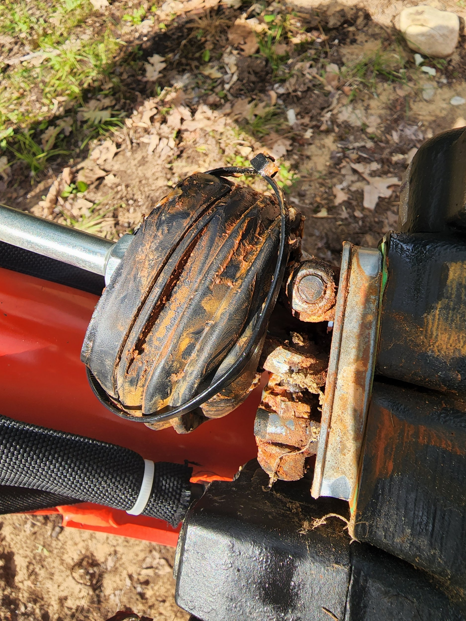

Less serious: hydraulics drop relatively quick and my loader "tilt back" goes into free fall before going up causing me to lose lots of loads. The loader also drops so fast that if I'm using the forks to hold lumber and walk away for 5 mins the whole load is dropped on the ground. I'll leave it up to your imagination of what happens when I use the forks as scaffolding... 1 month after the warranty expired the spring housing end cap of the back hoe hydroulic manifold blew a gasket and cracked. When I was fixing it, I noticed a screw on the toggle was loose, so I pulled up the rubber boot and a gush of water poured out and all the gears were already rusting. I treat the tractor well. I store it in my carport and very rarely does it get rained on. Looks to me as water snuck in through the loose bolt and had no way out once inside the boot. Would have been a simple design fix to put a cap over the boot and screws to avoid this.posted some pictures of this below.

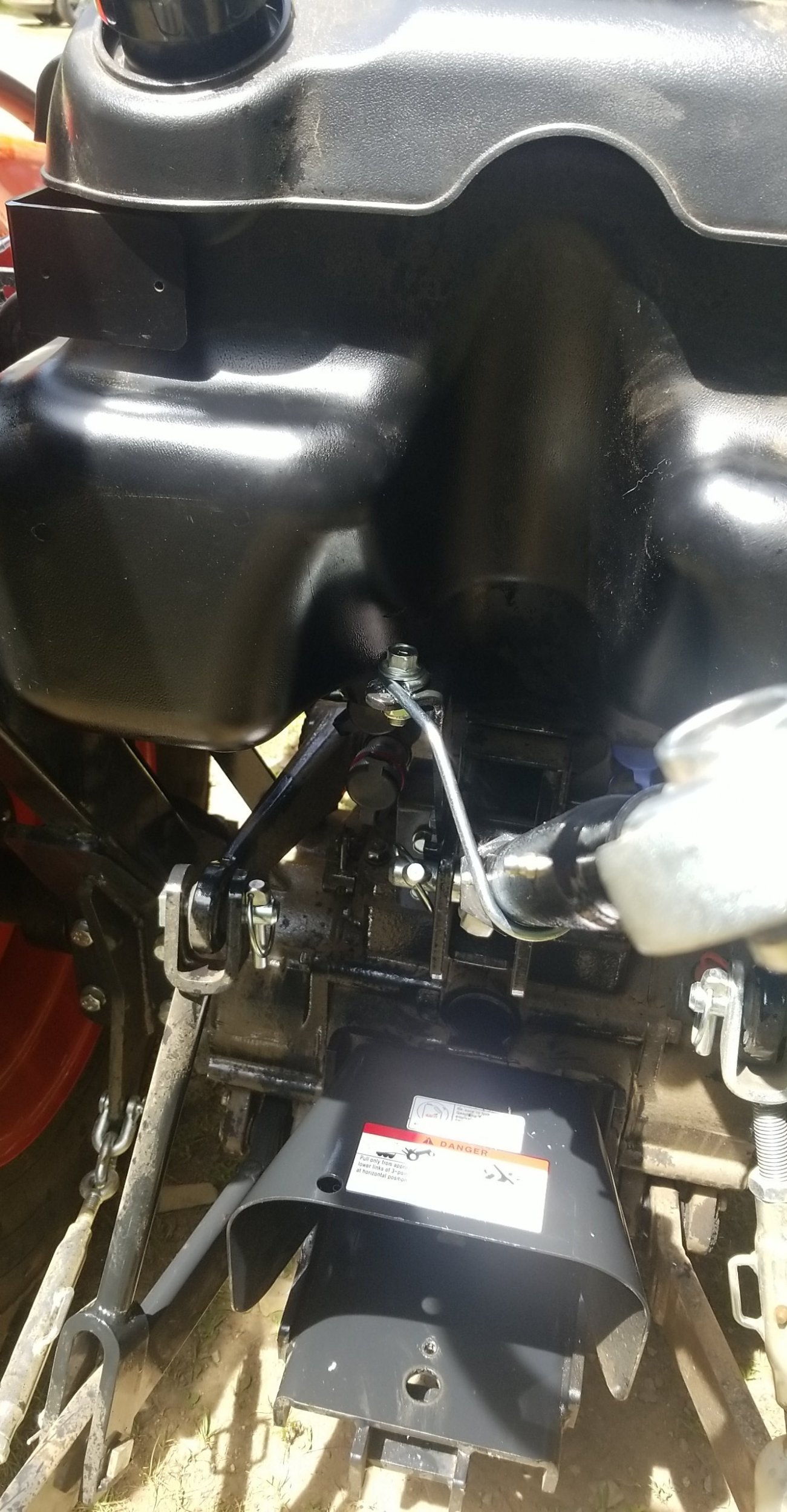

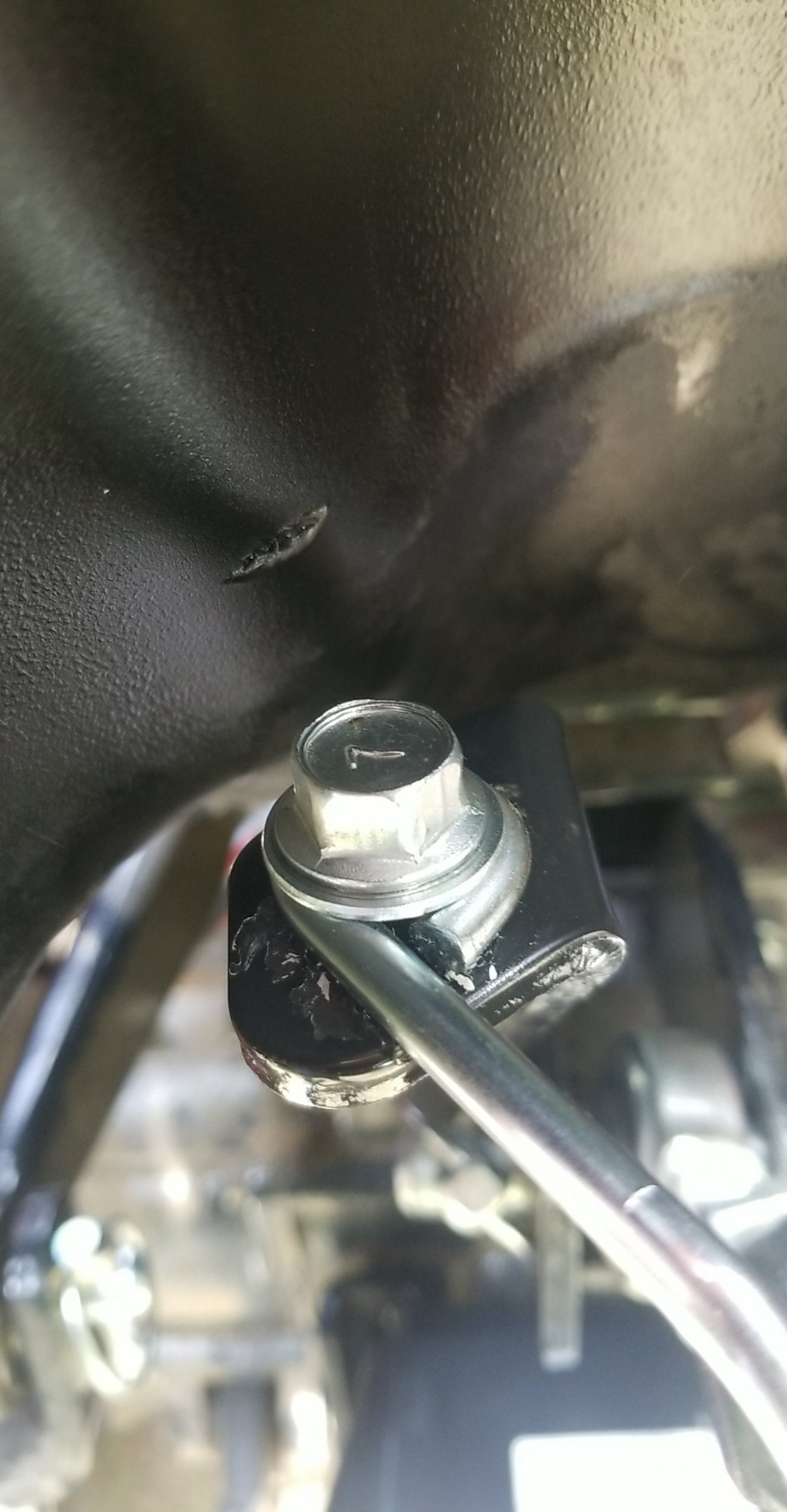

Hey, would you take a look at something on your 2610 for me?
Friday night I noticed that the hook to hold the top link was against the fuel tank; thinking about it, and not wanting to rub I pulled it away, to discover it had already put a hole in it.
Would you check your 2610 and let me know how close your hook is far enough from the fuel tank to not touch it?
