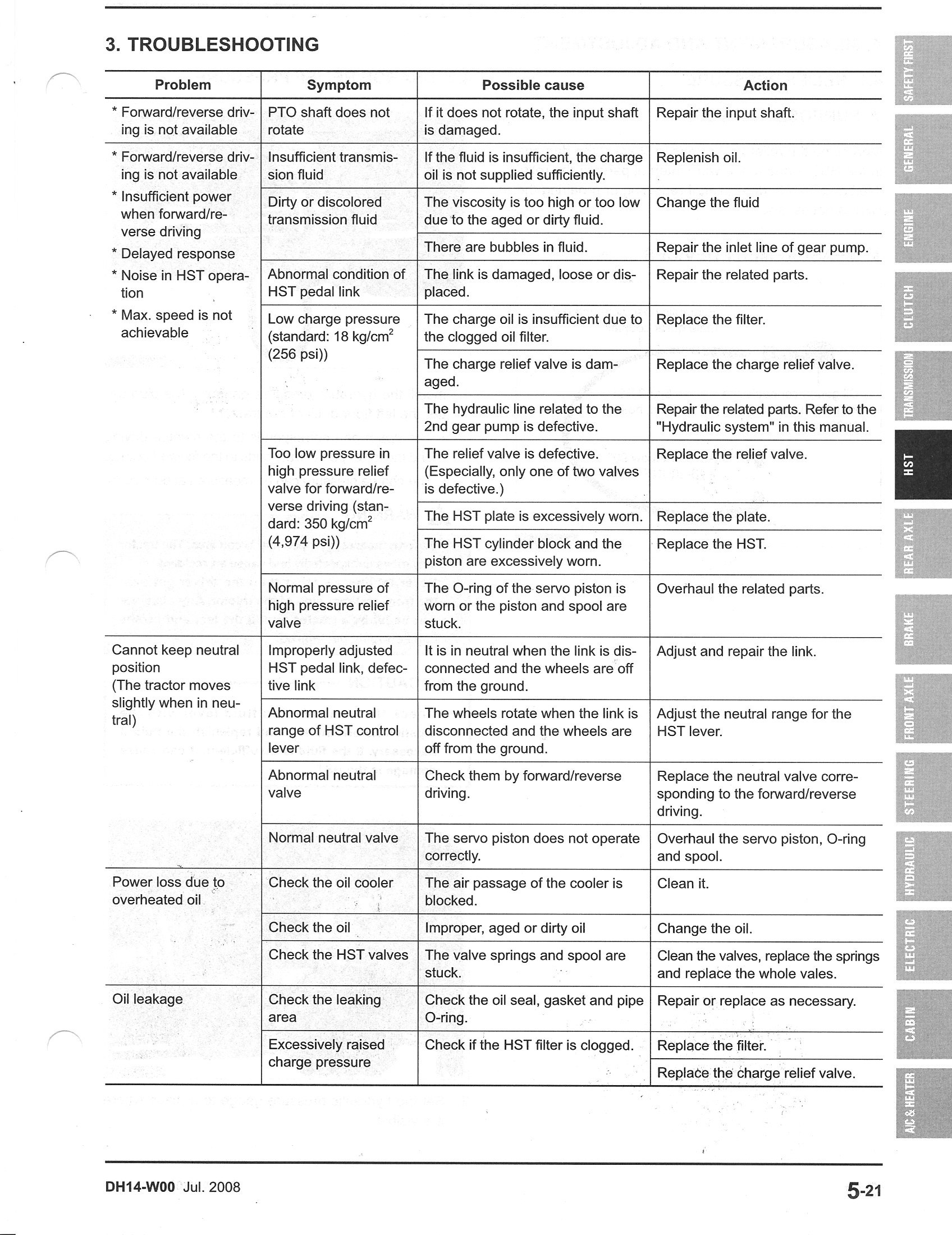

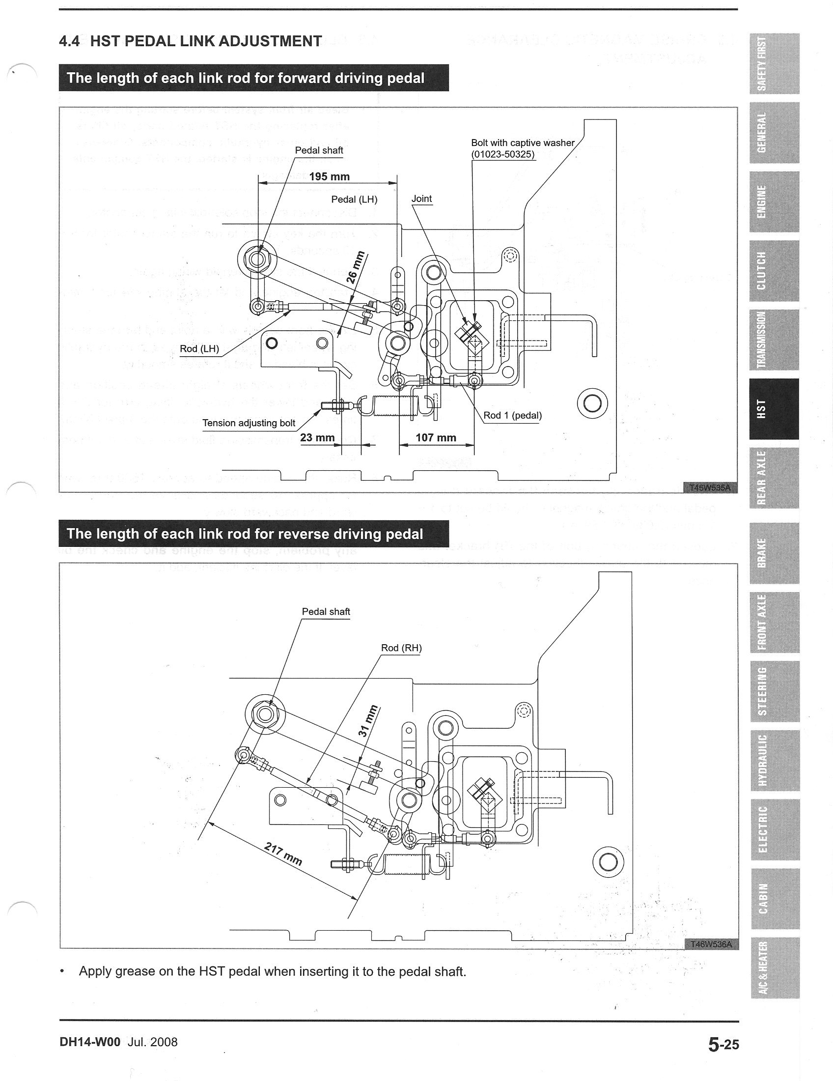

Usually rod 1 needs to be adjusted.

It is the top diagram and the rod is marked rod 1 it is in the lower right hand corner of the picture.
The picture will blow up click on it and you will see a little arrow box click on the arrow box.
   / New Kioti DK 35se/hst #14
