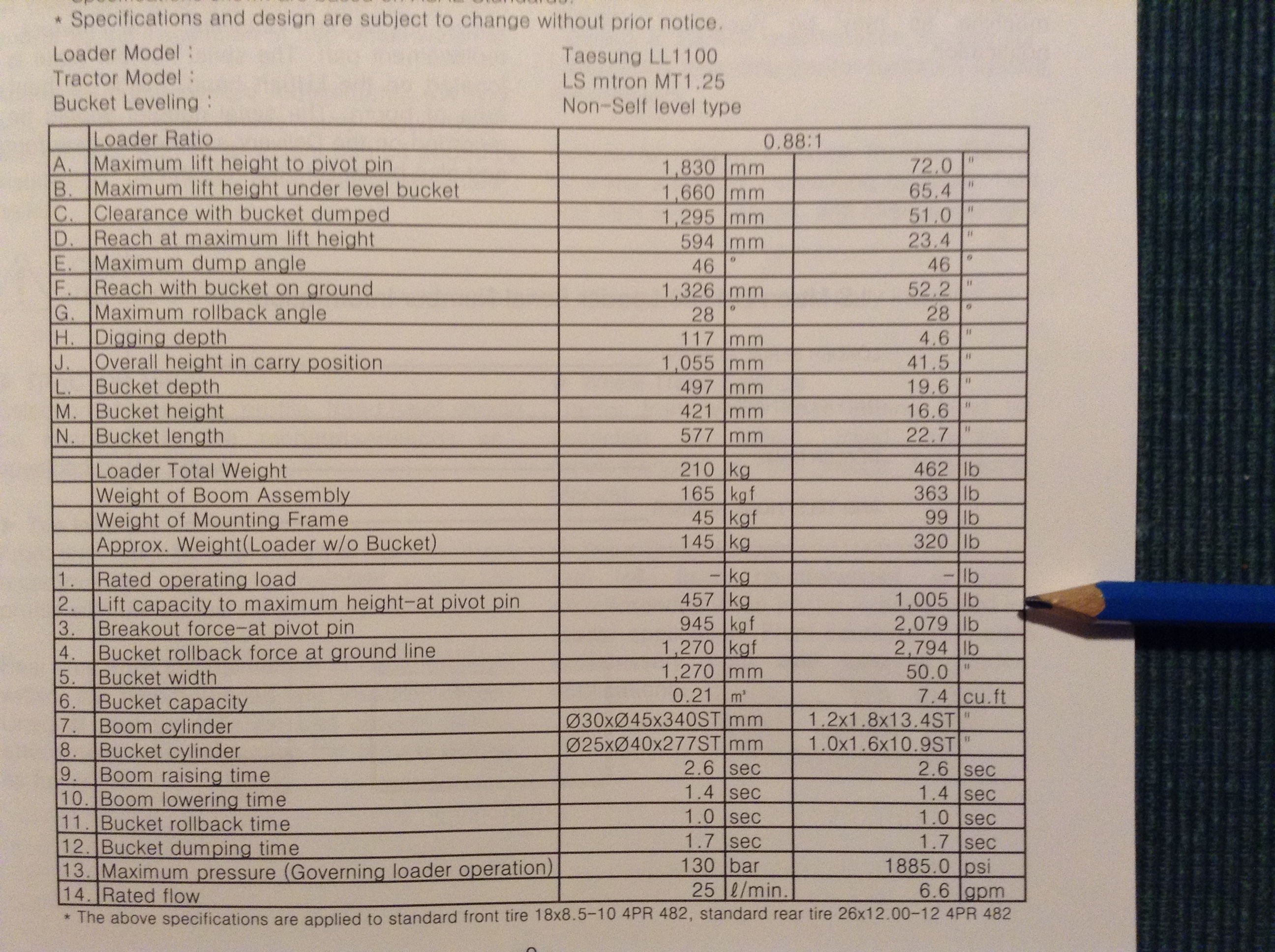

The LS website says the Loader Lift Capacity is 886 lbs (I literally just copied and pasted direct from their website). Is the 1,005 pound figure with no bucket?
   / New kubota 23s vs new ls scut tlb #22
I got the spec from the LL1100 owners manual. Here is a photo of the specs. Not sure how they measure it
