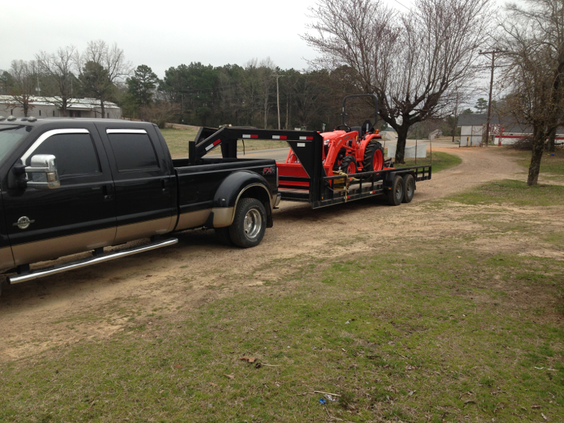

Ya I just bought a brand new one to day . It's a little jerky but I can live with it . I read all about it so knew it before buying . But I wanted the L3800 and want a Kubota .
Sent from my iPhone 5 using TractorByNet
   / New Kubota L3800 Owner #29
Looks great, enjoy machine. Love your gooseneck also, been looking at getting one of those soon myself.
