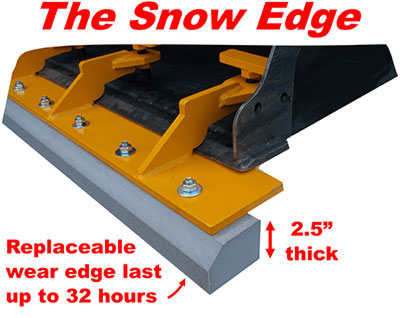

The Edge Tamers are great, but will leave 1/2" or so of snow. The bolt on edge from bxpanded is still a steel edge engaging the pavement, with potential marking likely. The Snow Edge is damage free, easy on/off with large hand tightened clamps.
I have the Tamers, and for the price are a great option to have for a bucket. I used a Snow Edge on my previous tractor, and it was ((IMHO) the ideal bucket addition for damage free snow removal, if you must use a bucket.

Thanks, after watching a couple YouTube videos the Snow Edge looks like the best option for my situation.
   / New Kubota..loader edge? #59
Another factor with the snow edge is ......... it makes a novice operator like myself much better in that the angle of the FEL does not have to be as precise. You have maybe a 15 degree leeway on the bucket position to be effective when pushing off snow.
When I bought mine I included a spare sacrificial wear edge ..... but after three seasons the original has yet to show any significant wear.

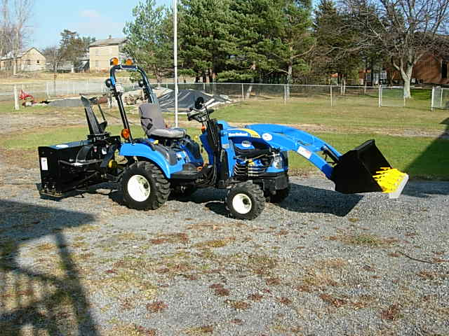

I don't have edge tamers but I think they would work great on my gravel driveway for the first couple snow falls because they leave a thin layer of snow behind and help keep the cutting edge of the bucket from digging in. Every year I fight for the first several snow falls to keep the bucket from digging up the gravel, even with the pipe installed on the cutting edge. But I would remove them after a decent base is established and put my pipe back on. We get snow so often here that doesn't melt until spring and if I just plowed with the egde tamers all winter I would have way too much base built up by spring.
I know exactly what you are meaning about the rear blade. I bought one for snow removal also but it isn't very user freindly for the way my yard is set up. My bucket is much faster.
Thanks for posting this because I completely forgot about the edge tamers. I will have to build some.
