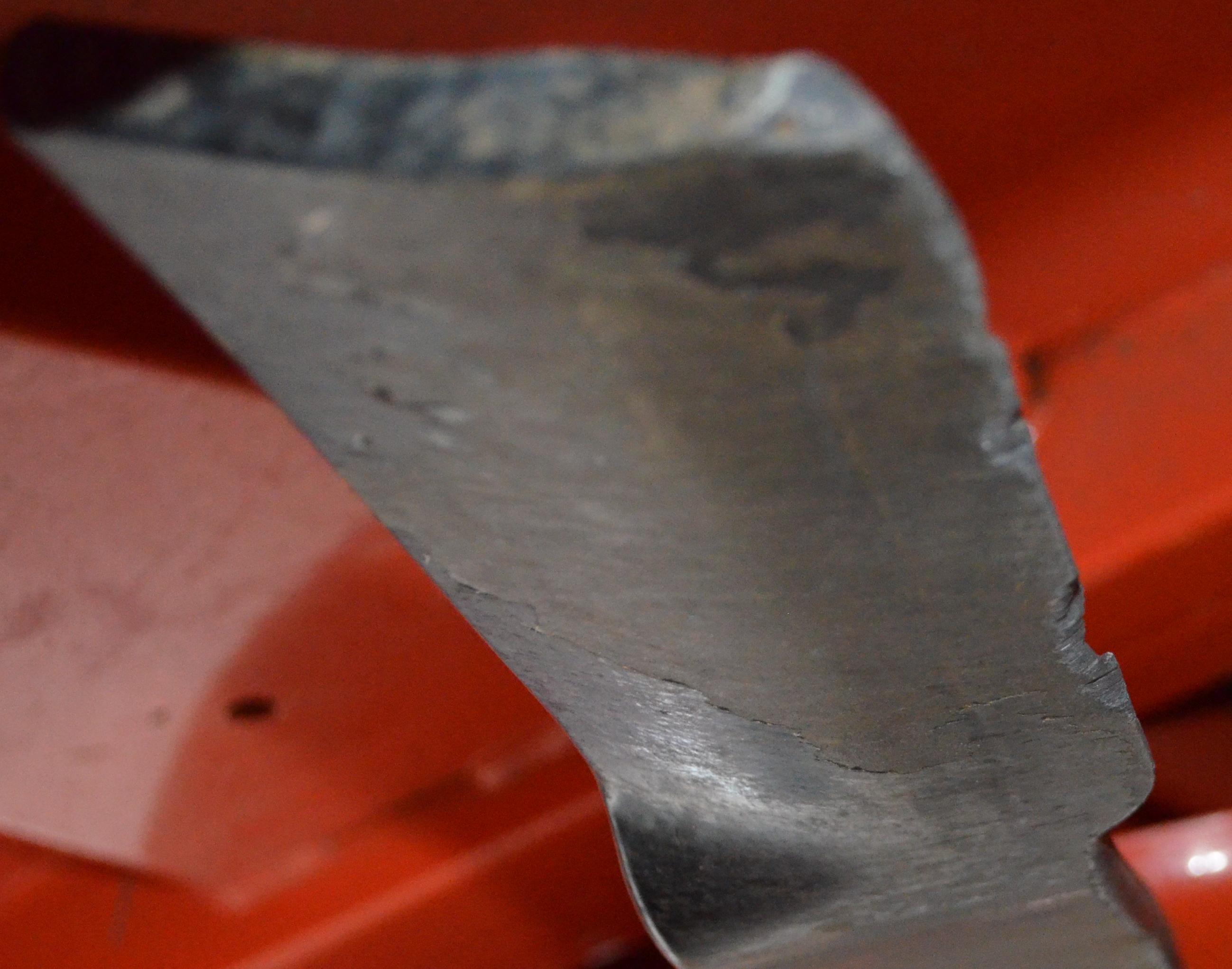

Given the irregularities of my field I know it's going to be demanding on my brush hog. In my first couple of hours on it, I was careful to avoid rocks (some of which I'll be working to remove soon), though at some point I hit something that I believe triggered the slip clutch. I thought it was just a mound of dirt, but perhaps not.
Anyway, it isn't that I'm surprised by the beating the blade took in short order (though I am, a bit, because I was careful about rocks), it is the _chip_ taken out of the blade, instead of just a good old fashioned dent. Too much carbon in the steel? Ah well, not really asking, just sharing. The flower is off my new shiny blade. (If you click into the photo, the chip should be evident). This is a Land Pride cutter.
I was running with the 3ph lift setting at about 4 (where 1 is lowest, 8 is highest) so that on level ground the front runners were easily over an inch off the ground (and the blades higher still inside the cutter), trying to be conservative as I get the lay of the land. Of coursed nothing in my field is level.
Or is this type of blade abuse also expected for all the saplings? (Which is pretty much the focus on my activity here, the guy who cut last year left all manner of saplings uncut, so I was going over a lot of 1" stuff with the occasional 2" thing in there. I wouldn't expect saplings to do that.

That looks like impact damage from hitting rocks to me.
