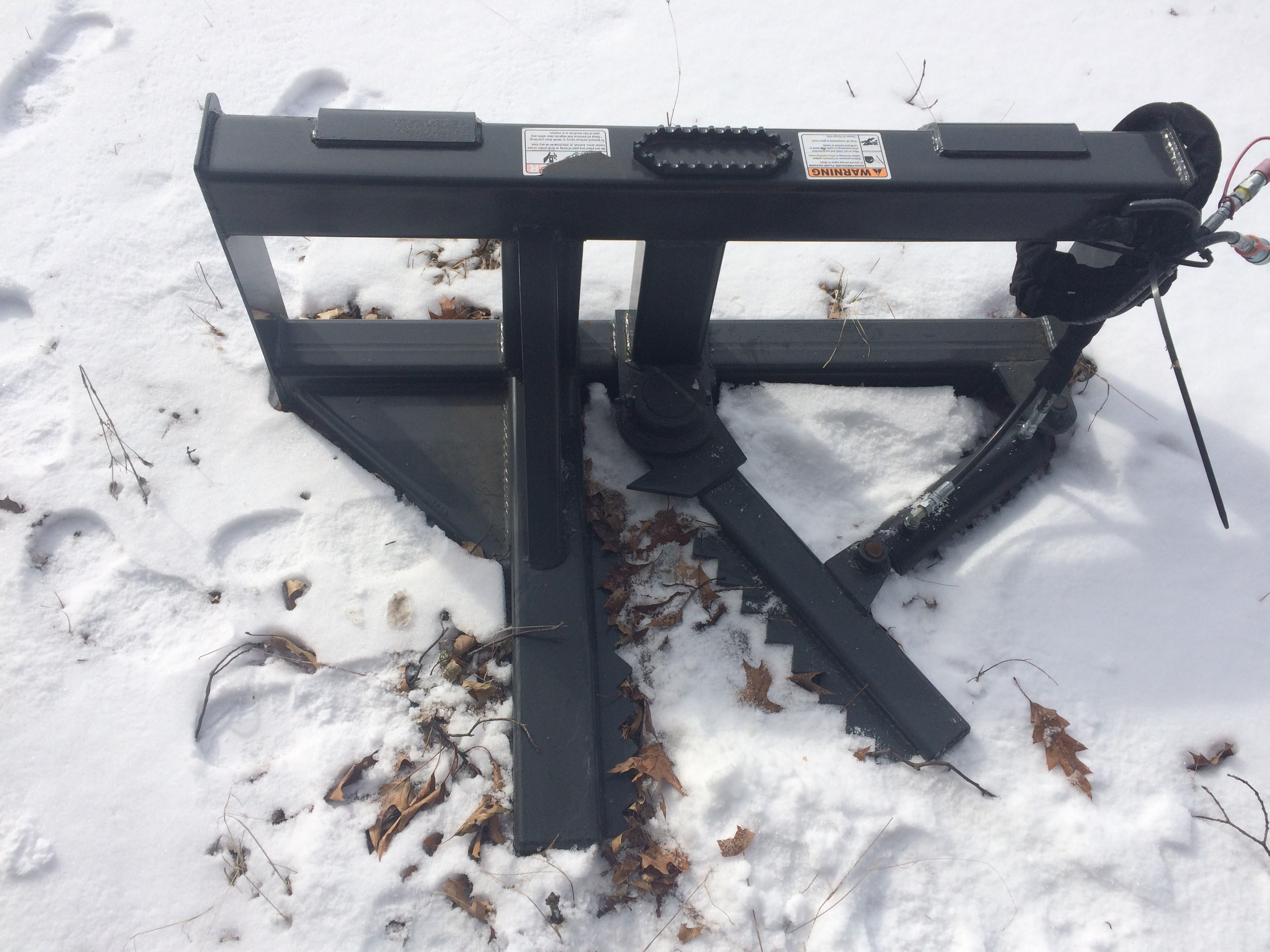

Remember to subtract the weight of any grapple from the FEL's capacity. I have one that digs ok with the jaw closed and doesn't weigh much. It's for pulling trees/shrubs, and will move to my bigger (cap) FEL soon. (12 LA) btw, I got a smokin' deal on another 12v diverter valve today from SC. #9-6802 It's ~12 gpm but that's not a prob on my other FEL (110 TL)
