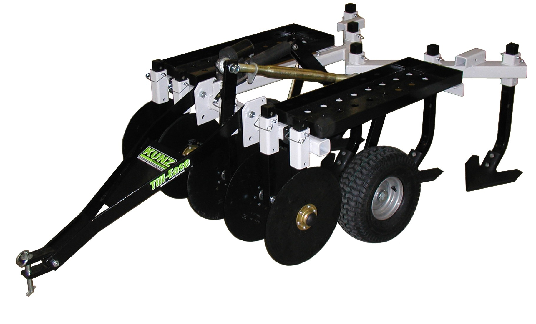

If you are considering a disc w/ angled coulters along with extra weight in place, as you already know it seems, 26 hp may not be enough, not to mention the incorrect tires for traction purposes. There is a Till-Ease Model 543 Chisel Plow / Field Cultivator on the market that is built-like-a-tank but also small enough to access hard to reach areas / food plots. You may not need to trade-in for a new tractor but different tires may still be a necessity. The 5 coulters on the 543 are in-line (not angled) to slice the soil & tree roots (depending on diameter) before the five chisel plow / cultivator shovels turn the soil directly behind them. Two styles of cultivator shanks are included - standard chisel point & 9" sweeps. The manufacturer realizes the Model 543 will face virgin soil conditions often. Wisely - they have made the shanks easily removable into any configuration depending on type of soil or tractor horsepower. Even though the 543 has two plates for extra weight, it normally is not needed because the angle of cultivator shanks pulls itself into whatever depth is desired.

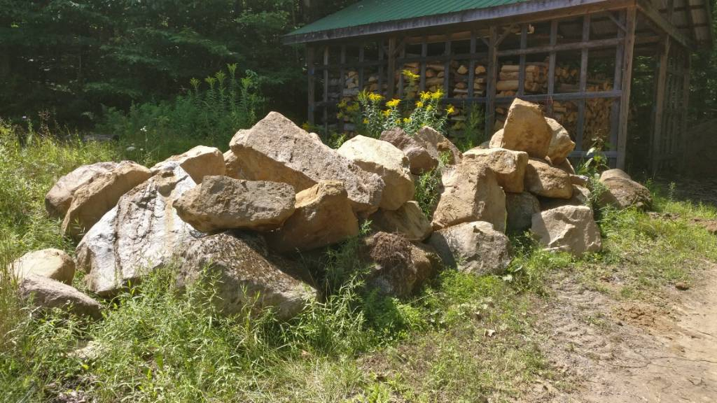

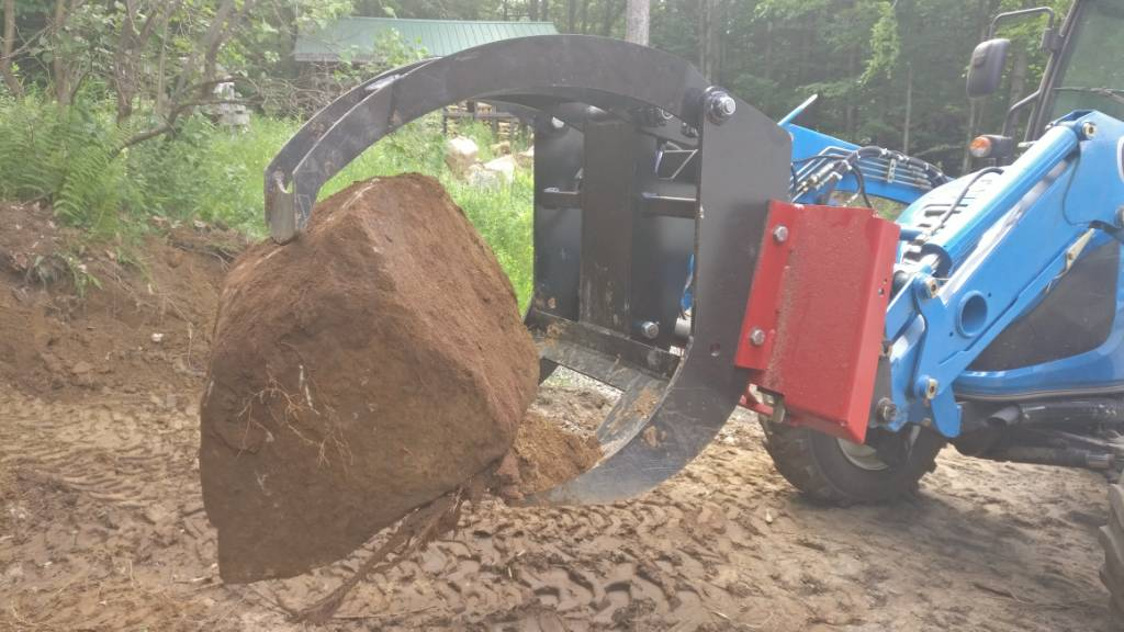

If you're wanting to dig rocks with a grapple, get the right type of grapple, and a large enough tractor. I have a 4,400 lb dry weight tractor (with loaded tires and loader, pushing 6,500 lbs) for 5 acres.
If you want to dig rocks, don't get a wide clamshell grapple. You will catch edges on other rocks, making digging rocks almost impossible. Instead, get a frost bite (or Igland/Sundown Gr-20) style grapple. They are cheaper too (~$1,500). It is much easier to get under rocks and pop them out. You can do it with forks, but then you are changing implements to pick them up and move them.
The earlier advice to first break the soil up with a subsoiler first is sound advice as well. I learned that too late.
Here are two piles of rocks I dug out last summer using a Sundown GR-20 grapple to put in a parking pad that was about 30 ft × 40 ft. I have extremely rocky ground.
