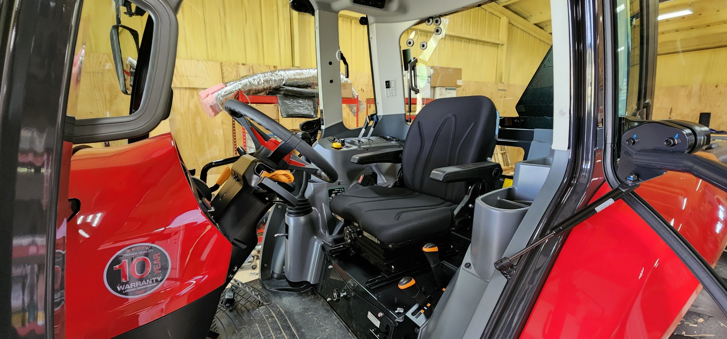

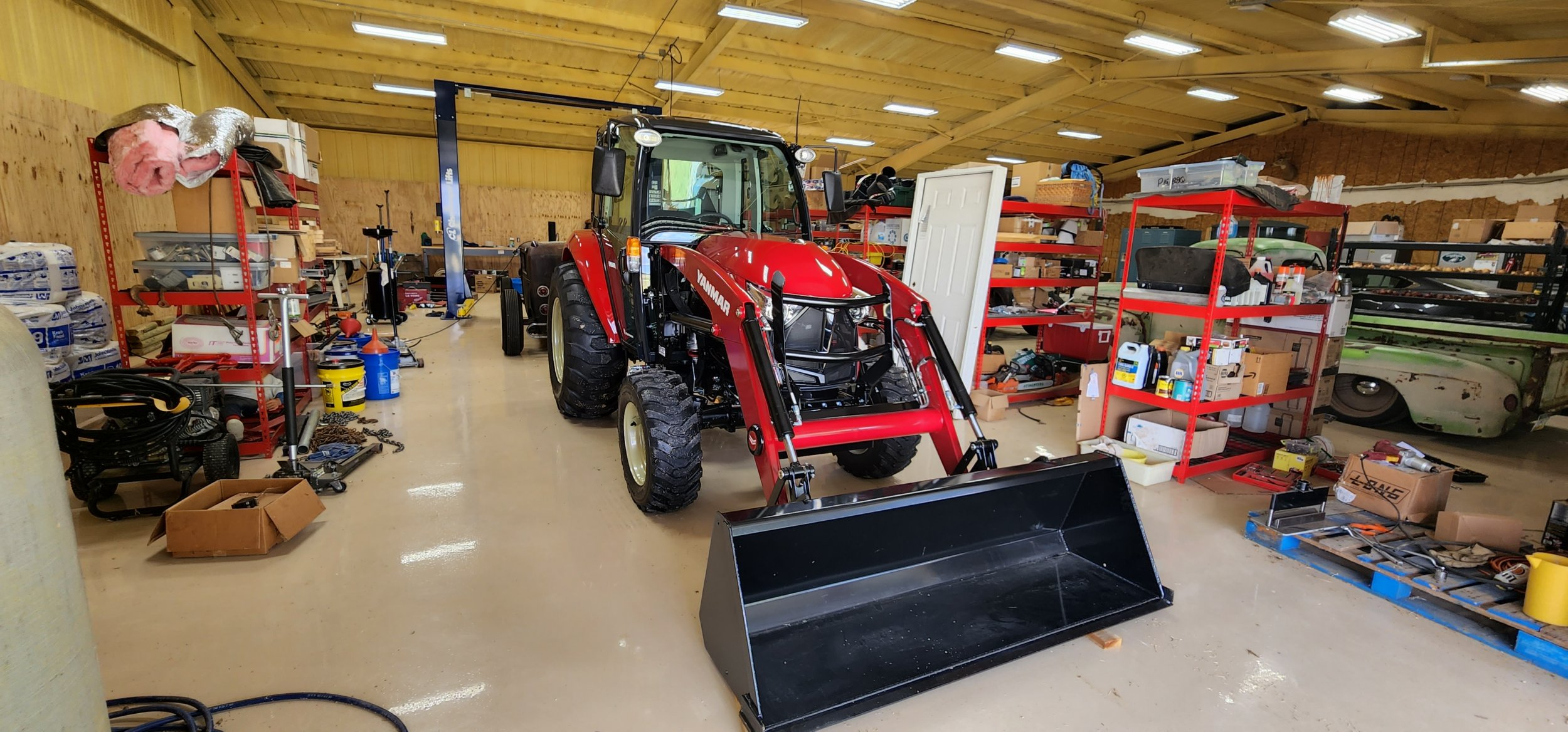

Have a look at the Yanmar. I bought a brand new YT359C this year. 59hp. Amazing transmission and comes factory with two rear remotes and a 10 year powertrain warranty.

Take a look at Yanmar. 59hp, amazing transmission and a 10 year powertrain warranty.
