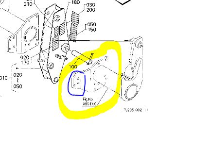

Update: Set up mechanic said the right side tire/hub comes off the axle when shipped in the crate as it does not fit the crate. They assemble at the dealership and seal may have been nicked or paint chip etc. The one I thought was the easiest to fix (leaking loader block under the deck), should not need to be tightened by anyone - comes from factory set (per mechanic), it's a special bolt that is prone to crack if over tightened. He said he will take all bolts out near the antifreeze leak and try to get the pocket emptied. Going on 4 days, I think if it was a pocket it would be emptied already?
Confidence is getting lower. I was looking to replace an old JD LX188 in the spring with either a ferris zero turn or BX 2x70. At home we have a 3 acre lot, 1 acre grass, 2 open woods with partial slope (hence the 4wd BX). That is 6 months away, so I will see what becomes of the L2501.
If your heart is set on this tractor I would wait a few days after they finish fixing the leaks and then re-inspect it before signing anything.
May be best to ask for another tractor. This may be the one in a million that is prone to a lifetime of problems.
Trust your instincts on this. If your not comfortable walk away.

My L3901 was dripping antifreeze after it's 1st few hours of use. I tightened the hose clamps and the leak would stop for a few days and then start back up. I called the dealer and they sent their service truck out the same day. The mechanic pressurized the coolant system and every hose clamp was leaking. He tightened the clamps all up and it hasn't leaked a drop since.

I don't think you have a 'lemon', just some things that need correction by your dealer. If you can get them to give you a different one then do so.
If you get this one back you could hose it down, when the engine is cold, with cold water to get any remaining coolant in crevices, on the side of the block, to finally be rid of any that might be continuing to drip from the engine compartment; though at this point unless there is an actual leak it should be done dripping by now. :confused3:
