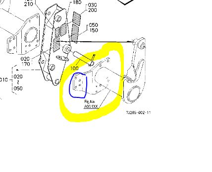

You guys with a 2501/3301/3901 can you look at your loader connection to the frame/cast motor. On my rear connection (4 bolts) with the tube extending out for the loader arms, there is a bolt/lock washer/washer. On the front on the connecting plate there is 4 more bolts, but with only a bolt and washer (could be a lock washer). My concern is there is only one type of washer on the front, NOT 2. Is this the same as yours? The antifreeze is still dripping and I'm curious if there should have been an additional washer on the front 4 bolts, would have made the bolt sit in further without an extra washer. And maybe it is cracked?
This is my first time with a picture, so hope it works!!! The area I am talking about is the yellow bolts, but specifically the ones circled in blue on the left, how many washers?

Okay, went looking around at the dealer at other tractors (did not go in the sales floor) on the back and side lots. Indeed it is true, I have a phone picture of the L2501 (had 4 of them in steel crates) and it comes with the front right hub off and has a steel block off plate bolted on. The one assembled L2501 also had the wrench marks on the hub bolts, obviously. All of the 3301/3901 (none in crates) had no marks on the hub bolts, so Ivan49 is spot on that those come pre-assembled. The one assembled L2501 and 2 of the ten 3301/3901 units had the leaking loader block valve under the deck. And every single 2501/3301/3901 that had a loader had one washer on the front 4 bolts. There went my theory of short a washer upon assembly, I doubt they could be wrong that many times!

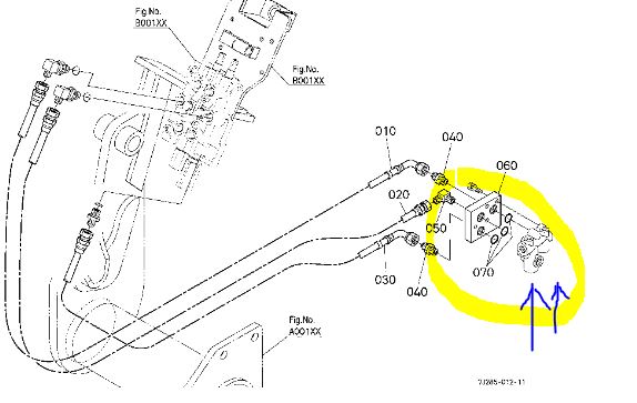

he is referring to the hydraulic distribution block under the right floorboard. There should be 3 hoses coming from it marked orange, gray and green, The orange hose is pump flow, the gray is return back to "tank" and the green is power beyond, which would feed any rear remotes if he has any and if not then it directly feeds the 3pt. Also the PRV (pressure relief valve is in this block)
I guess valve is not an accurate term. I think the picture from Kubota was hydraulic block. The two leaking bolts are on bottom as shown in the blue arrows. They are picking the tractor up this evening.
