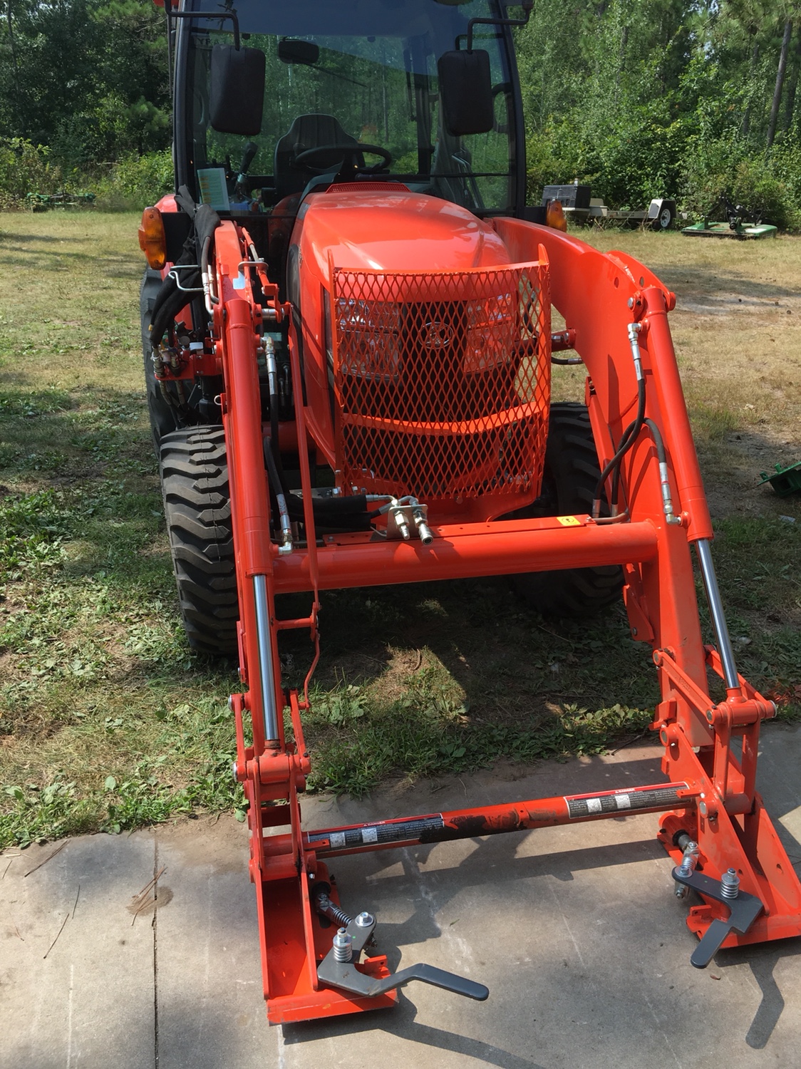

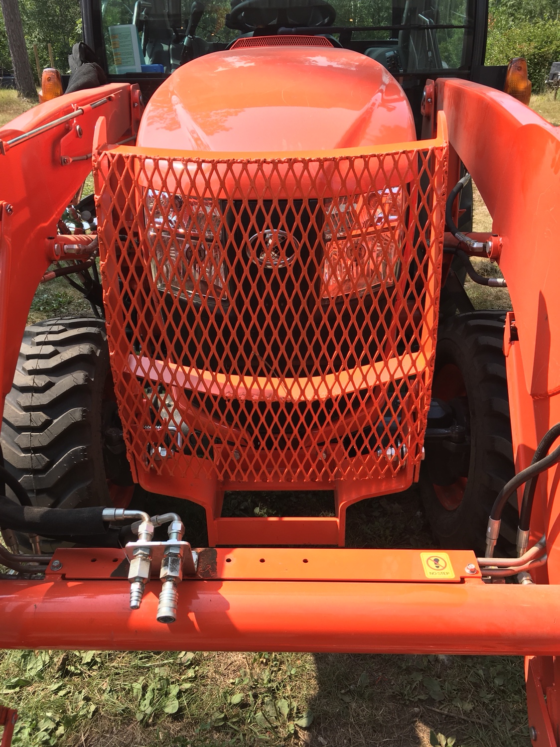

I just welded some expanded metal to the existing Kubota Grill Guard. This will likely save me a few dollars (or more) of damage with my loader or grapple in the long run. It was a fairly simple DIY project.....but it would be nice if Kubota offered such an upgrade. Operating around a timber property can be hard on stuff. I like to add protection to vulnerable areas before the brush gets me.

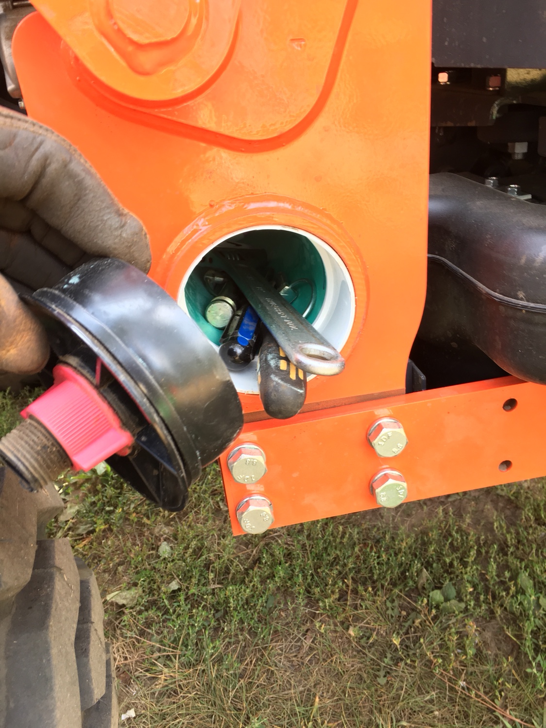

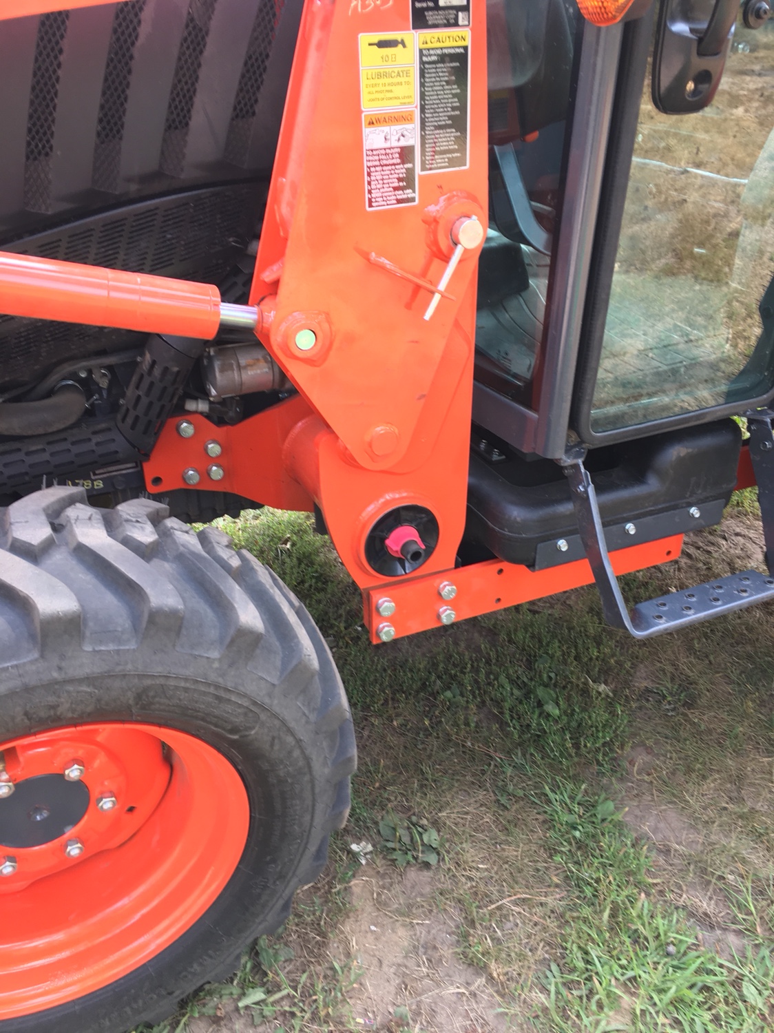

I put a plastic tube and "plug" into the 5" (?) tube in the loader frame. It provides a good tool box or a place to keep a short log chain. Will try to post a pic. below. I saw this on another web article.....and the mod is cheap and easy.
