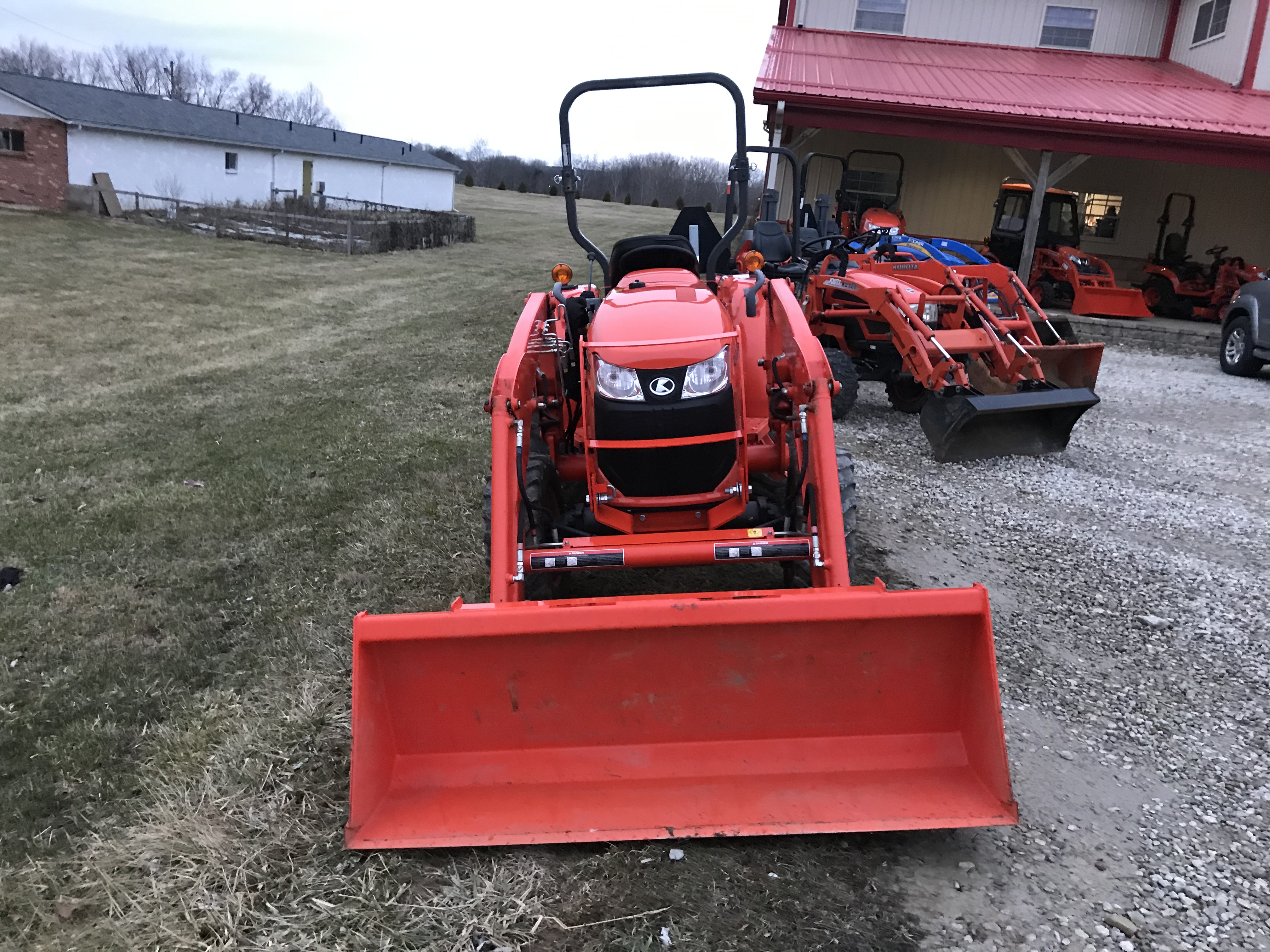

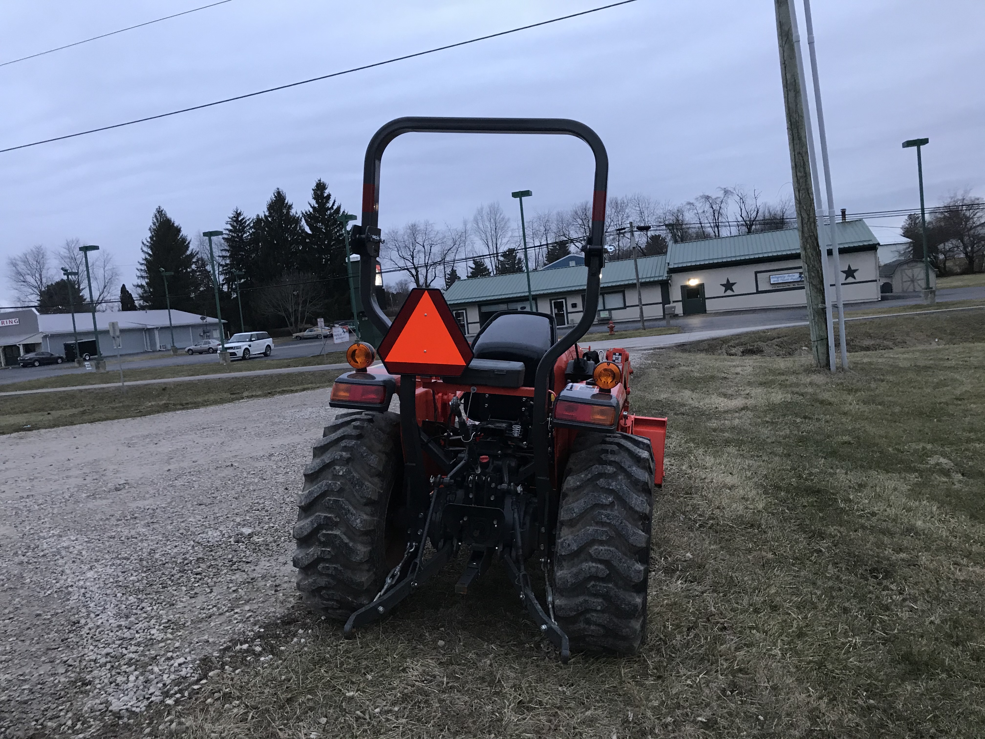

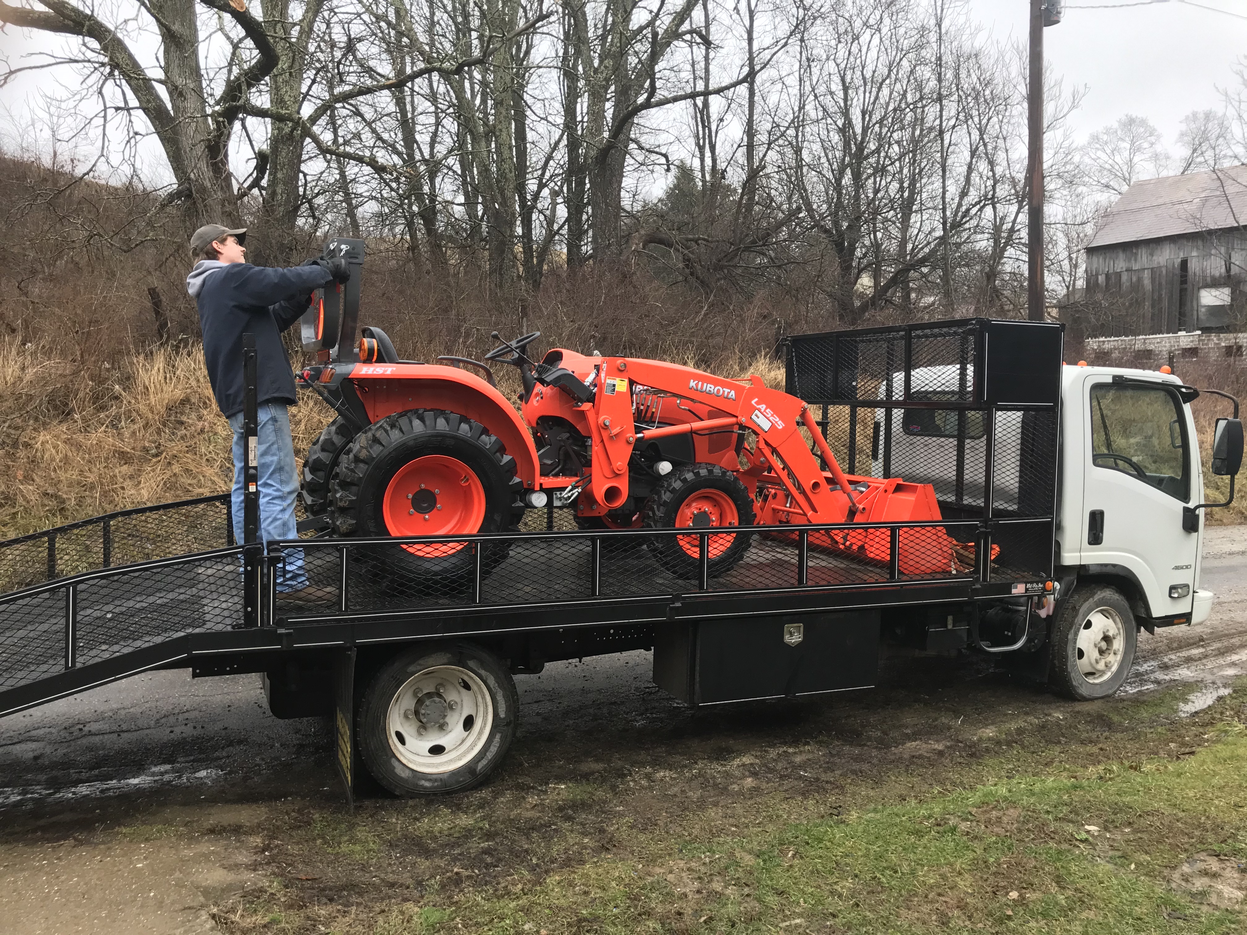

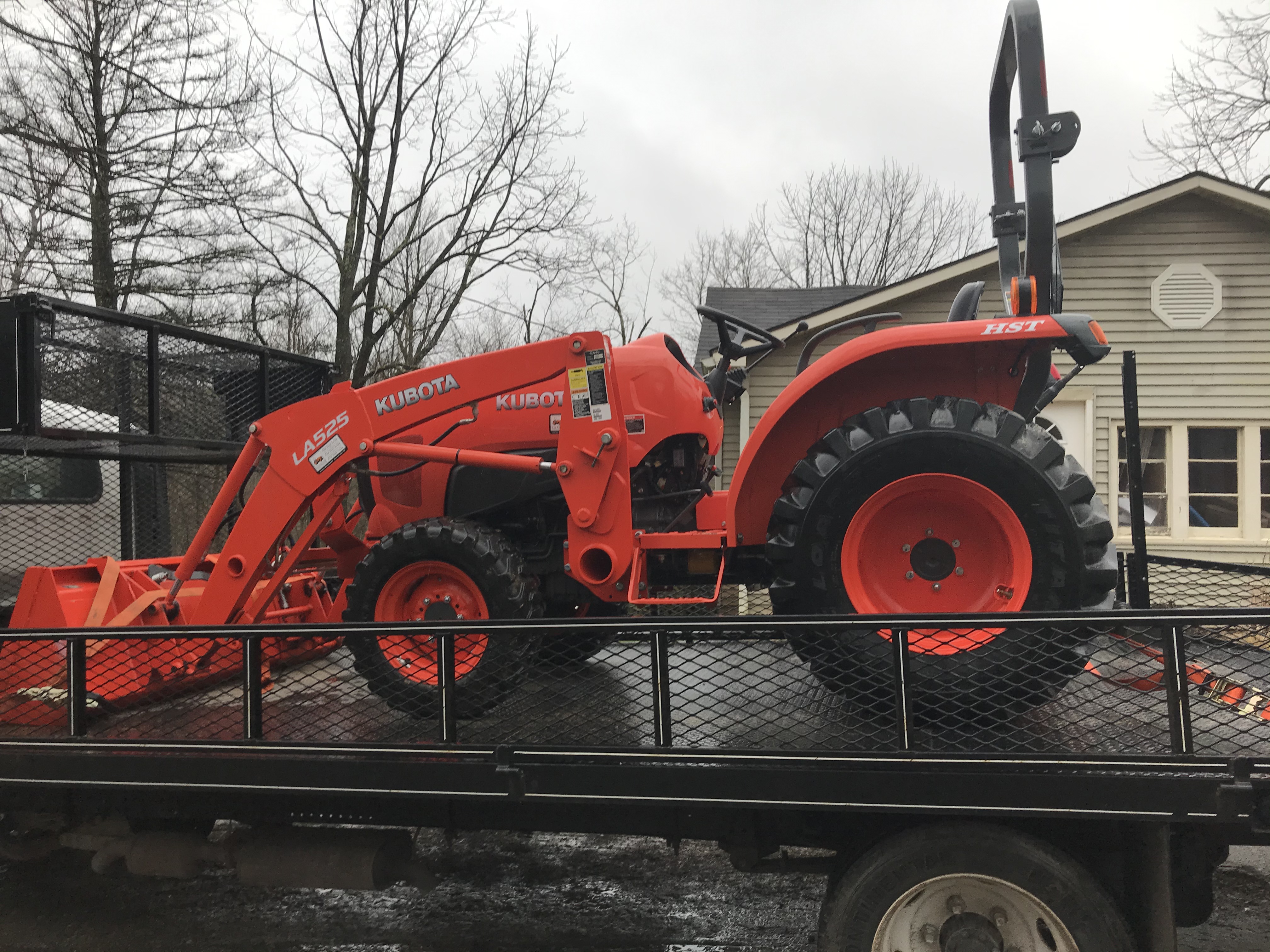

My new used L3901 was delivered, love the tractor however it is so wet here, especially behind the house where we had a septic installed, I got it stuck the first day trying to get it put away,
I wish it had R1 tires, these R4s have hardly any traction in muddy areas,
I will get more pics when I it dries out! C998BABD-E744-414F-8E8B-22DBFE46BDD0.jpeg17EA3A16-D7E2-465A-9845-A97A430A2785.jpegB24CB0C1-4312-460E-9E11-1515C73C37F2.jpeg1FE6B0D1-02C0-4065-9814-7F816072FA6D.jpeg
