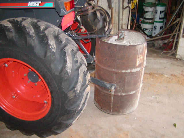

I did not want to put ballast in tires because I use it to mow lawn. I used my heavy duty box blade for counter balance until I built one that is easier to put on & much smaller. Will attach picture. Is just 55 gal drum. 7/8 rod through center attached to top line hitch point & a tomato wire cage for reinforcement. Recessed at top link area to miss top link. I got it ready & left it at the local concrete plant, they filled it up with left over concrete. I picked it up, ready to go.
If interested & you would like, can post picture of inside before concrete poured.

I was thinking of doing that very thing. I'll probably weld up a simple 3pt frame inside a container and do as you did.
It will be nice to do that instead of having 6+ feet of an implement sticking out the back...

I really didn't realize how nice it was going to be until I started using it. Also I purchased as set of car dolly's on the cheap at Harbor freight, moved the casters out a little & use it to set the 1000 lb barrel of concrete on when I take if off. Just unhook & roll it over out of the way. Sure makes hooking up a lot easier also.
I use a extended handle hay hook, hook it into a hole in one corner of the car dolly to pull it across the barn floor.
