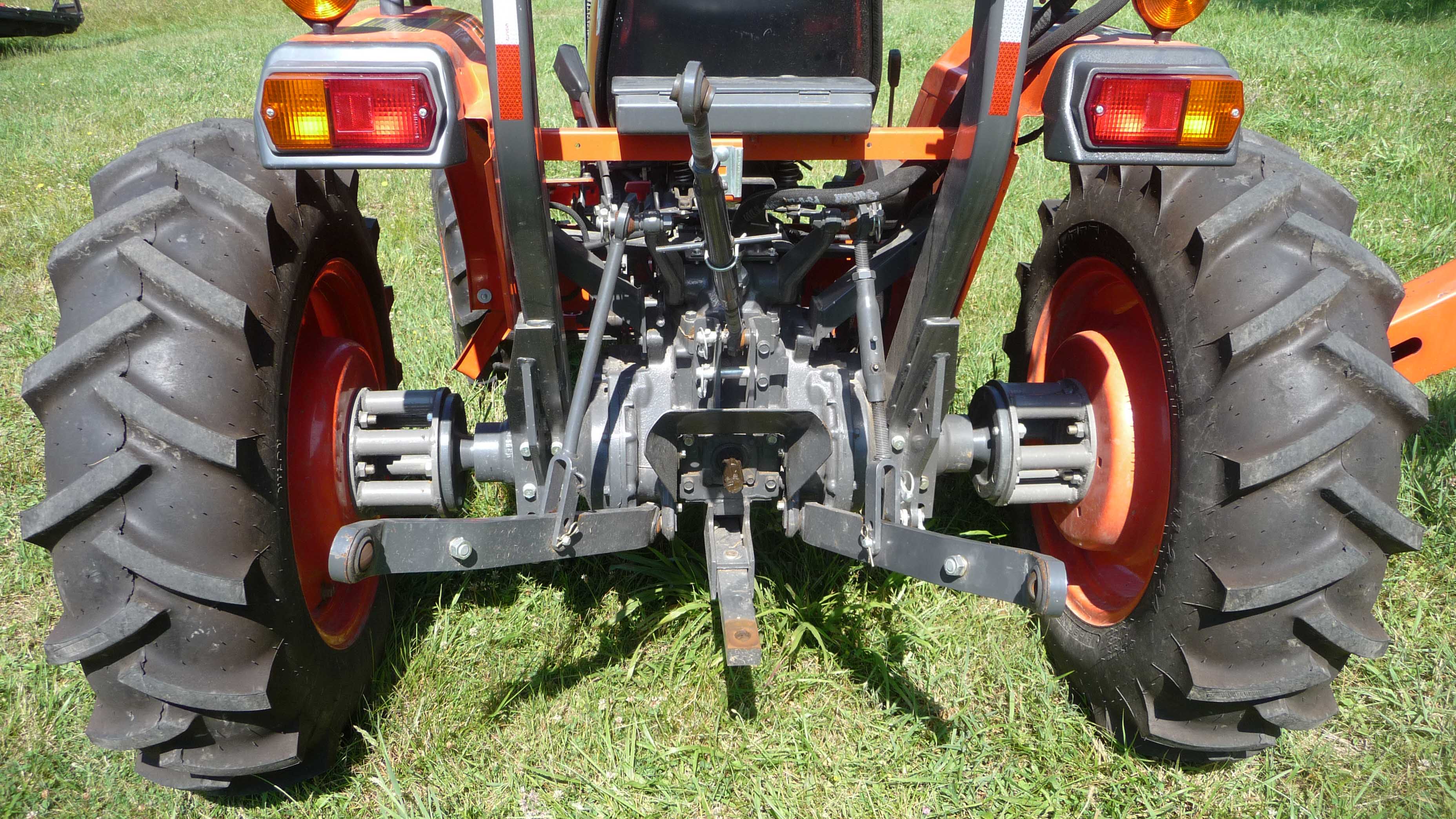

-- FOR SURE get those rear wheels out wider if you have any slopes or steep ground to work on. These things are not real cheap ($495 a set in my case) but work really well.
This picture below is a set of steel tubing-style separators mounted on an L-3400. I put a set of 6" separators on the rear of my B2150 too and it made a HUGE difference in terms of feeling steady on slopes instead of feeling like it was in danger of tipping over. I used a set of Bora brand that are machined from solid aluminum but there are several kinds. I would go for the 6" per side giving you a foot more separation between rear wheels. It still amazes me that the Japanese have yet to comprehend that we are not all working flat land here in the USA. Check first to be sure you have clearance around the backhoe for widening the rear wheels.

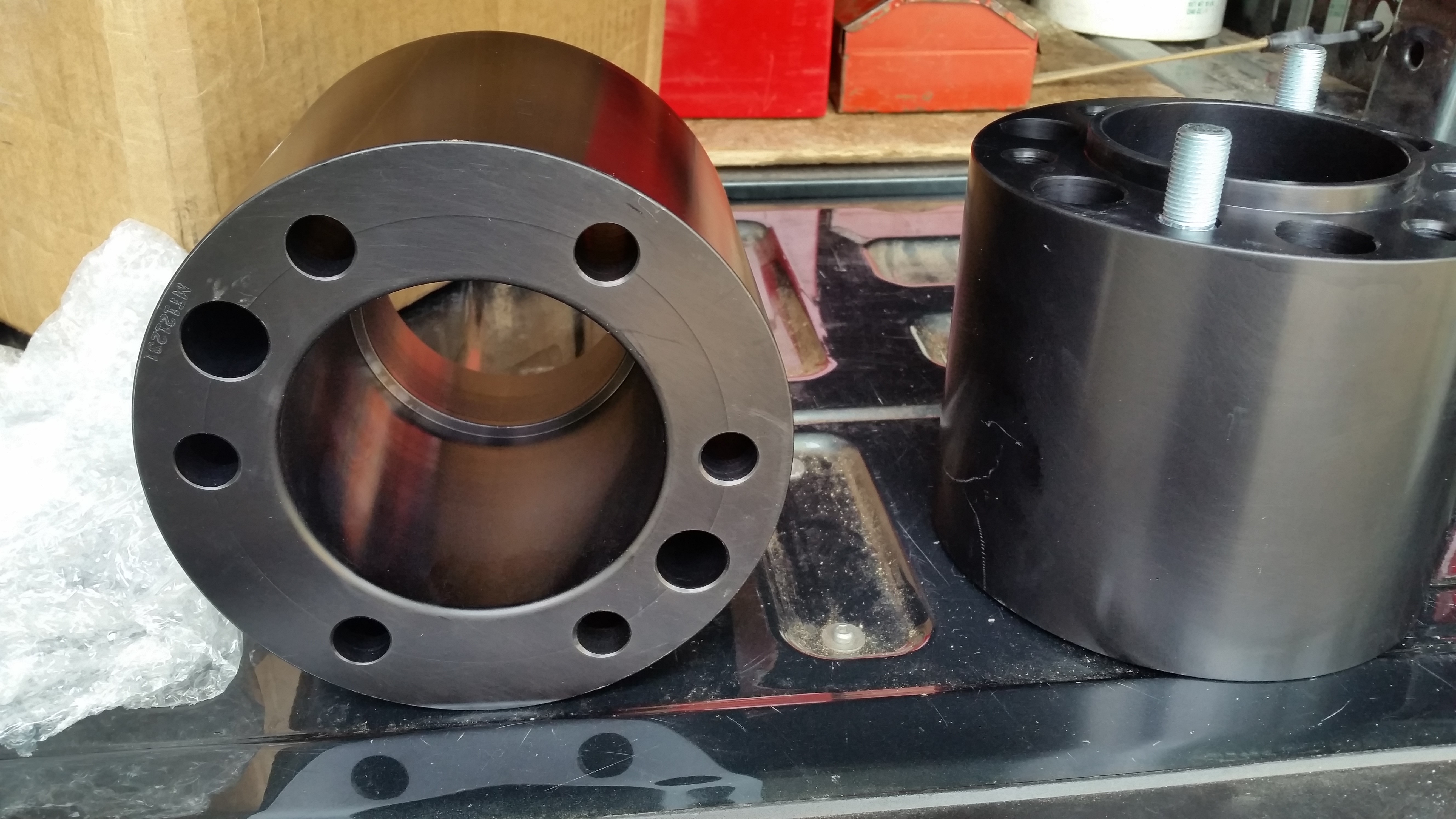

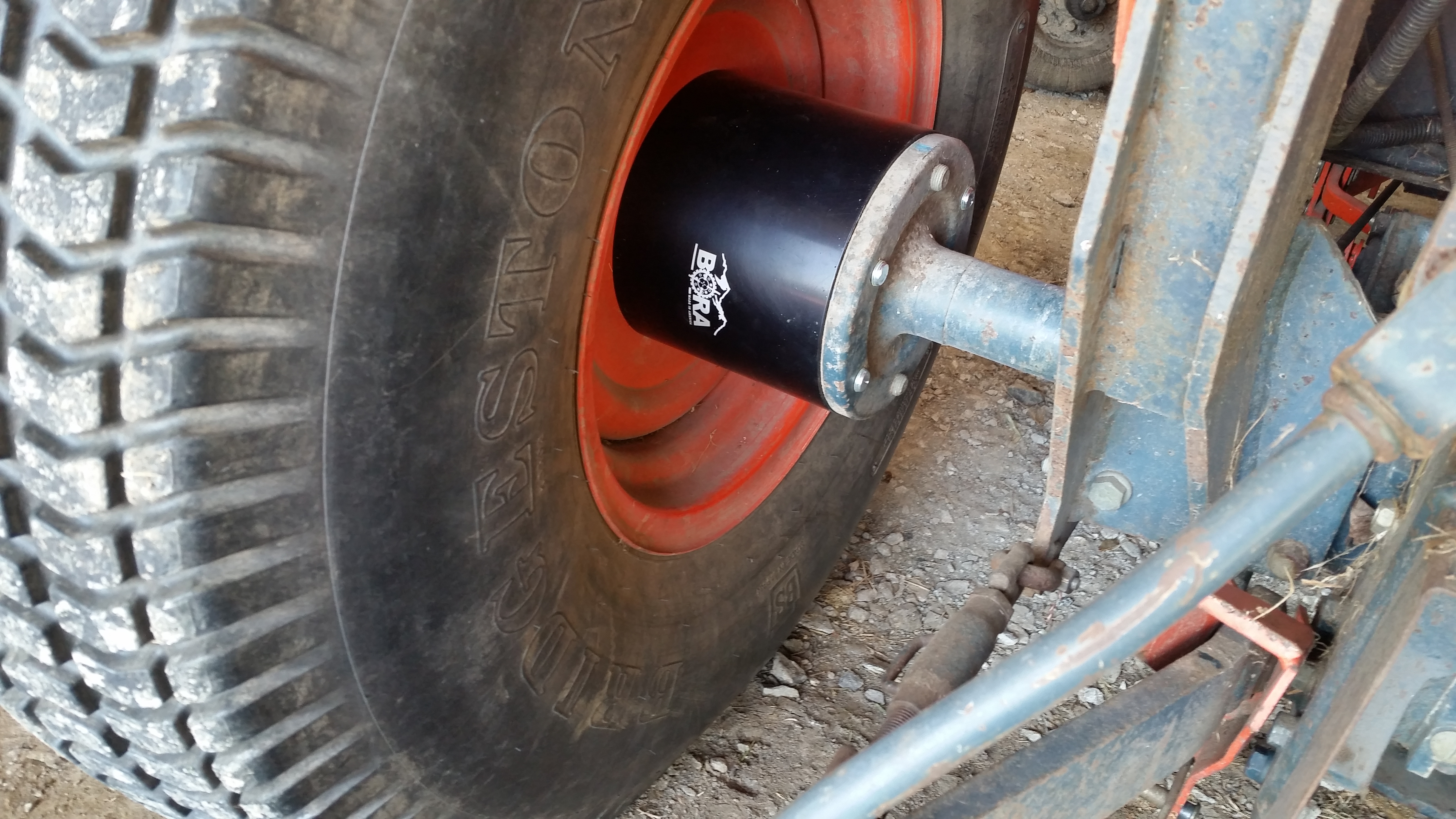

These are the Bora brand that I use on my B2150:
Off the tractor they look like this:

I bought some Bora 2" spacers for the rear wheels on my L5740 in order to get more clearance for tire chains. I was surprised that even with just 4 inches (total) of additional tire spacing the machine feels noticeably better on a side hill or when a tire drops into a hole or ditch. Going wider is definitely a good thing if you need to work in steep terrain. And Bora is good to work with if you have any special issues or problems.

I agree. Bora has been the ideal source for spacers in my view. They are also known under the name Motorsport Technology out of Reno, NV and they take email at motorsportjr@gmail.com . They had every tiny detail figured out for compatibility with my specific Kubota including provision for the 2 of the wheel studs facing the opposite direction from the rest, little recesses to insure that the spacers stay concentric with the hub, providing all the right threaded bolts and etc. I was really very satisfied with them. Again I got the 6" spacers and I advocate going out as wide as you can provided there is no conflict with your backhoe or other things. Spacers of significant length do usually preclude using the belly mowers.

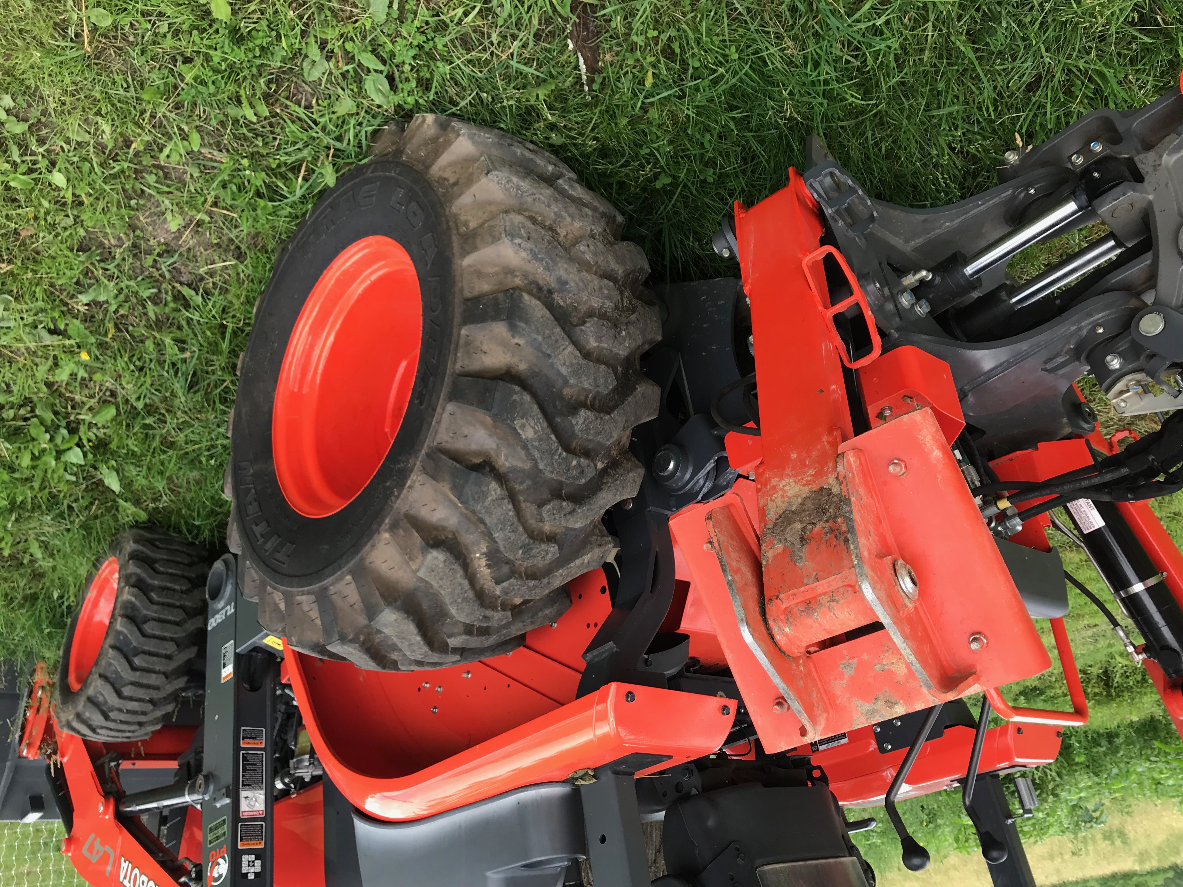

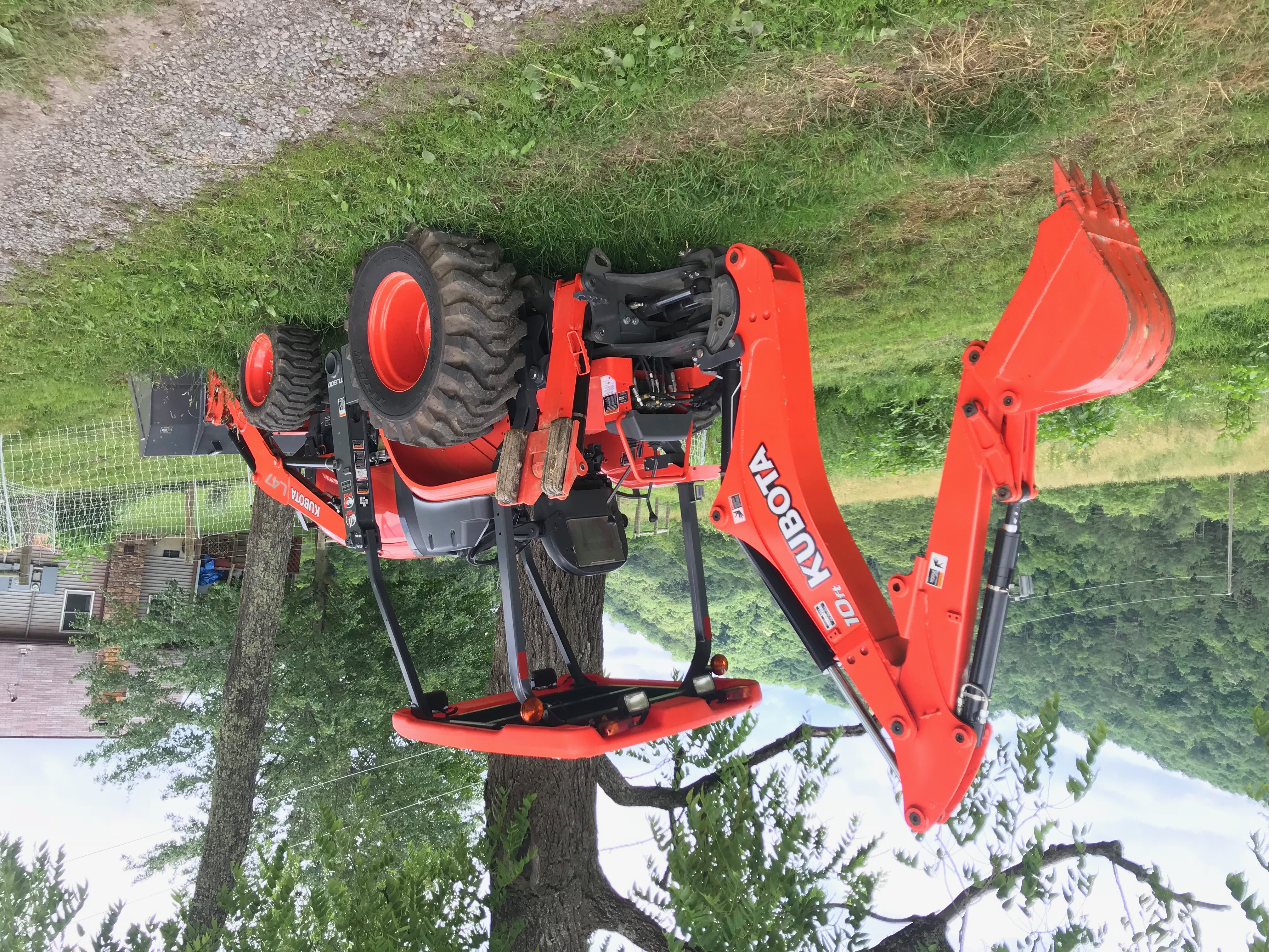

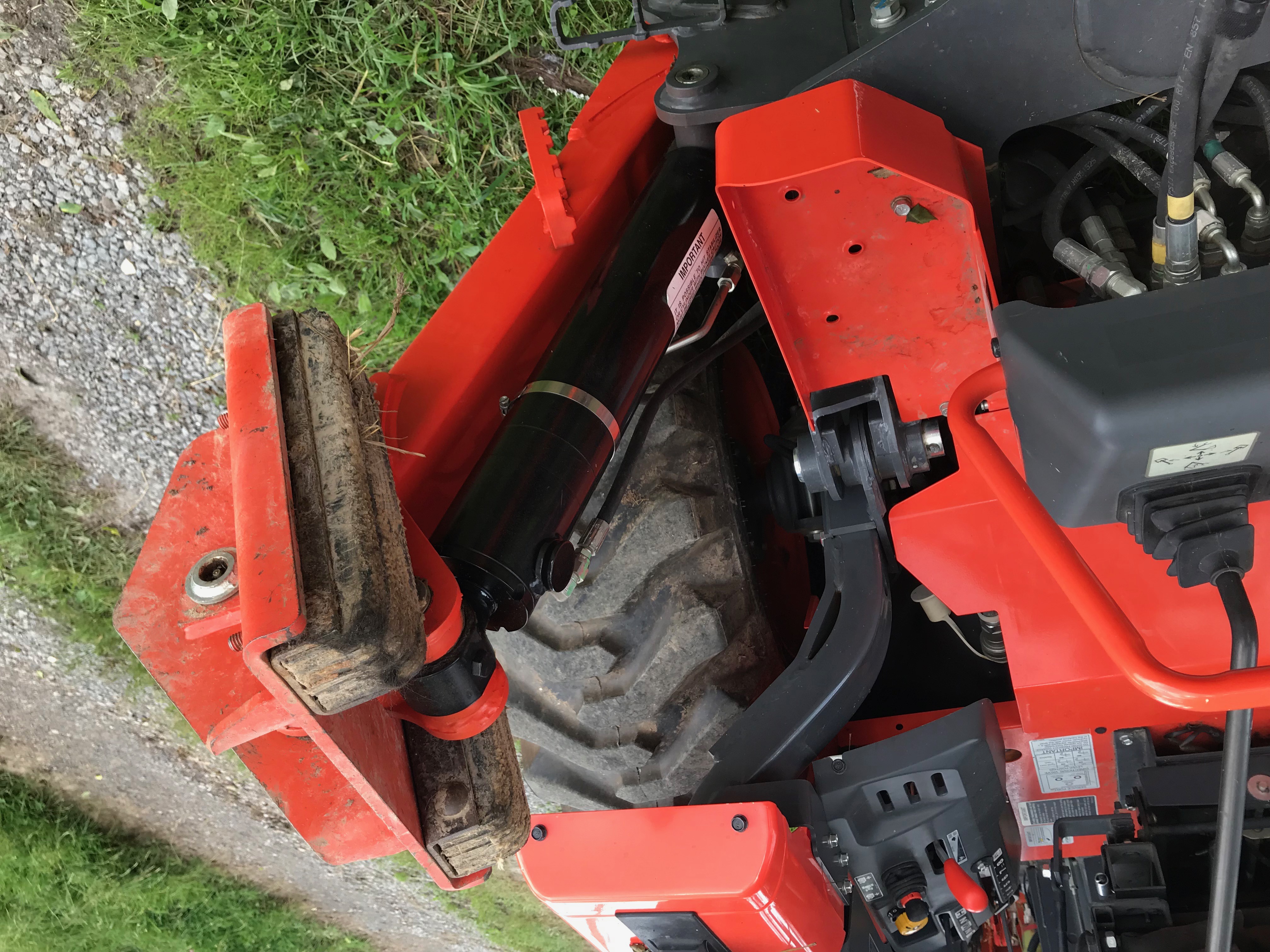

Several of you suggested I check compatibility with the backhoe. Looking at it, it appears that +6" on the wheel spacing would not interfere. The stabilizer legs run at an slight angle back, so they wouldn't contact tires no matter how wide. The backhoe itself swings to 90 degrees perpendicular, so it can't reach as far forward as the tires. Photos attached. Is there something I may be overlooking?
The folks at BORA suggest that front spacing will add stabilty when there's a load up front and if hitting a hole. However I'm looking at $500 front and $500 rear. Can't put a price on safety, but at the same time we are trying to start a farm and every penny matters. Thoughts?
